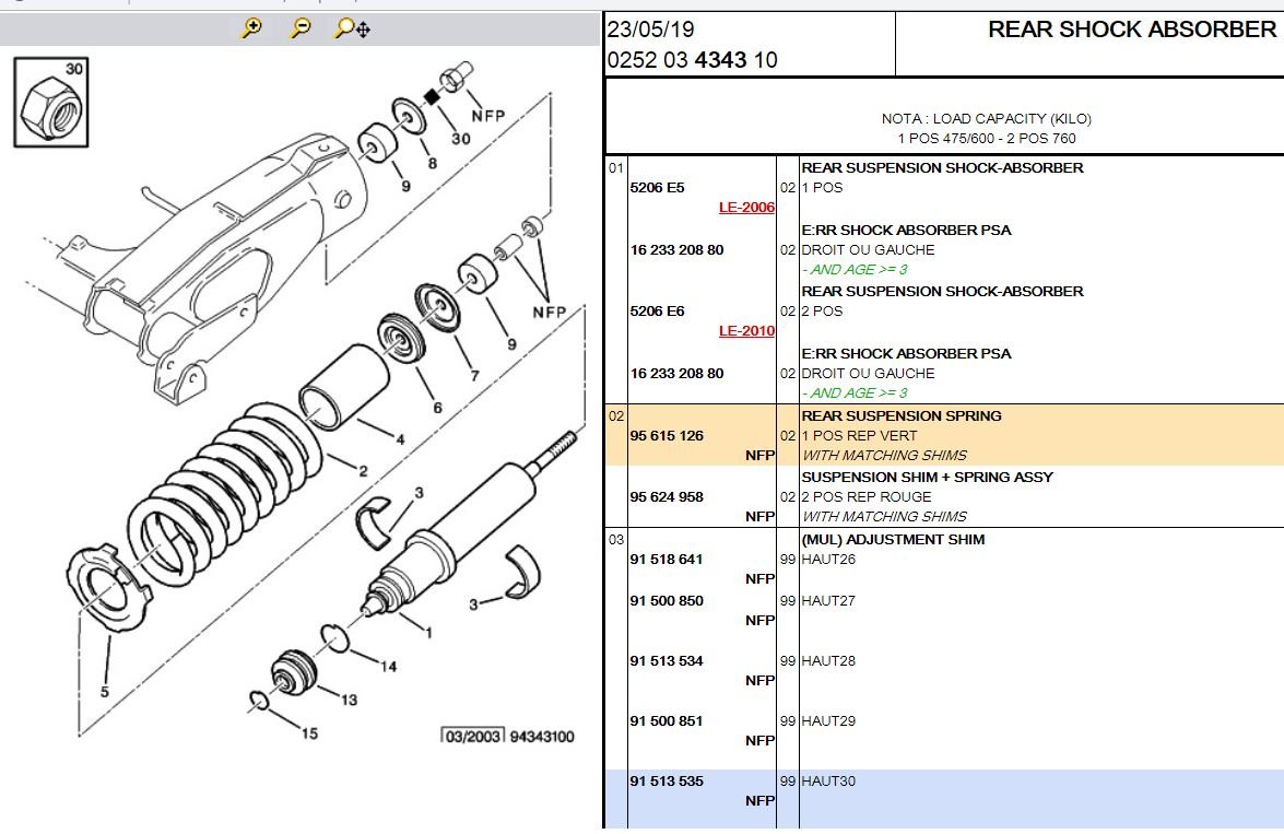

All very helpful but I was hoping for some advice on the weird horizontal spring setup on the c15. I know it’s frowned upon but how about cutting a loop out of the springs? There is what looks like a load compensator valve in the break line. Would that need adjusting?

I'm no expert on C15, but have just noticed that Parts show that there are two different springing options for C15, depending on intended load:
See note (POS1, POS2) at the top of the page about load weights.
Roll-bar and stops also come in different varieties: see the other rear suspension pages.
The different springs might not affect 'unloaded' height, just spring compression (and suspension travel) under load.

The unladen ride height of the Champ 760 (very rare in this country) is a little higher but I believe the springs are stiffer not longer.
Cutting horizontal springs won't have the same effect as with a conventional vertical spring so, I suspect, would entail a great deal of trial & error. You could try clamping, say, 2 coils together & seeing what difference it made.
The best way of course is to fit a BX rear beam, spheres, etc.
Probably the best sources of info. are the Polish Owners Club & im Axle Specialists (www.imaxle.co.uk)
