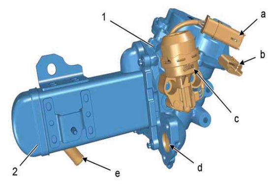

Ok so you have the DW10CTED4 engine and I am very surprised / concerned to hear what you said about modifying the software as the replacement EGR did not have the correct number of connections!
I would be very concerned about that to be honest as the 2 plugs are there for a reason with this engine:
The 5 pin connector "a" is for the engine system fuelling + or -, the sensor signal, earth and sensor supply.
The 3 pin connector "b" is the bypass connector / EGR Heat exchanger, Supply, earth & signal. So I cannot see how they can simply not connect this up - or it will not operate correctly under certain conditions.
Please don't tell me this was a Peugeot dealer that replaced it? Every single one of these I have seen has the 2 connectors present!
Part number 1618NQ
Here's a Valeo one as you can see:
A diagnostic session to obtain any fault codes would be useful - but to be honest, I can't accept that excuse for fitting the wrong one in the first place and would reject it.
I would therefore be a bit hesitant to spend time fault finding when you know the wrong one is fitted. These come as a complete module with the heat exchanger built on (item "2" in the diagram) and are assembled and mated at factory as disassembling the EGR module alone will cause problems.
When the EGR is replaced, there is a replacement parts option in Diagbox to inform the engine ECU the EGR has been replaced. This should trigger any initialisation procedure.
If it was me, (fair enough I have the ability to check and identify the correct parts), I would of point blank refused an incorrect one. If it's a dealer, I would demand the correct one is fitted and that they pay for the remedial work or complain to head office.
I simply cannot see how you can fit this and have either the EGR valve not working ("A") or the Heat Exchanger / bypass not working ("B") as those are the only 2 electrical connectors.

| (1) Electrically-controlled exhaust gas recycling valve (With integral position copy sensor). (2) Exhaust gas recirculation heat exchanger . "a" 3-way blue connector (Position copy sensor for the EGR heat exchanger by-pass flap). "b" 5-way blue connector (Electrically-controlled exhaust gas recycling valve ). "c" Control capsule (By-pass flap with integral position copy sensor). "d" Exhaust gas outlet. "e" Water entry. |

Hi Marc. Thank you so much for your reply. Its connector A that isnt on my EGR valve. I hve only owned the car since its had all the major work done on it as it was an ex company car. I think in a cost cutting excercise, an aftermarket valeo egr was fitted which didn't have the heat exchanger sensor on it. I dont know how a software update would have stopped the EML coming on. Ive come to accept that I will need to have it replaced at some point. When the EGR was replaced, it was done at a repair garage, not a main dealer

Well I'm pleased about that - as it would be quite worrying if this was from a dealer. The Mickey Mouse outfit obviously didn't get the correct part and couldn't be bothered to return it no doubt.
It is an integral part of the function of the EGR system to cool the temperature of the gases as needed, determined by the engine ECU:
- Cooling of the exhaust gases enables the emissions of nitrous oxide (NOx) to be further reduced.
- The exhaust gases are able to be cooled, in order to prevent the total mix of air from reaching too high a temperature (Mixture of inlet air and recycled exhaust gas).
- In certain operating phases, the exhaust gases do not have to be cooled before being admitted into the combustion chamber (Notably during cold starts, to allow the engine to warm up more rapidly).
- The engine ECU, by means of a pneumatic electrovalve, operates a by-pass by which the exhaust gases go directly to the air inlet without passing through the EGR exchanger.

Ive had a look at some replacement valeo EGR valves and alot of them dont have the blue connector on them. You make a good point at how the engine knows where the egr cooler position is. I think maybe i should get it replaced with a genuine egr valve from peugeot with the connector A. Its a shame they dont do the sensor part separately so i can add it on. I dont think Peugeot would have released a technical bulletin or update to map connector A out of the equation. Il have to see what the garage did

I managed to pick up a knackered EGR valve for next to nothing today. The EGR i wasn't interested in, but the vacuum pot with the built in sensor was which was perfectly fine.
I swapped the non sensored pot on the cars EGR valve with the sensored vacuum pot and plugged it all in (was very easy to remove and replace with just two screws). No engine light so thats good. Its still jerking and sounding hissy but I expect no instant miracles. Should I go into Lexia and go to replacement parts to start a new EGR initialisation?
