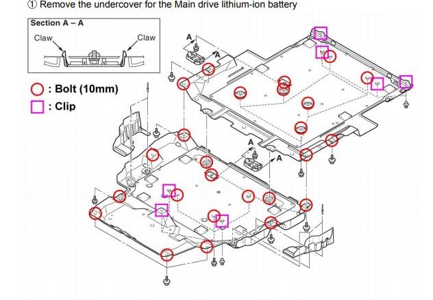

I've got several solid sleepers as well, between them something should work. My sleepers are 200mm wide and 100mm thick, as long as the 200mm is wide enough to support an axle stand, four axle stands on one sleeper at each end might be enough to do the job. Still haven't got a chance to measuring it though, but without knowing the precise height of the top cover of the battery enclosure I don't know how much we need to raise the car. I'd hate to be half way through winding it down only discover that it doesn't quite clear the car.RichardW wrote: 16 Sep 2019, 08:19Timber, 6" wide 2" thick - it's C24 grade or something used to make the roof joists in the extension - it's bloody hard! It will be OK stacked up - it's well machined, and if necessary it can be screwed together.Mandrake wrote: 10 Sep 2019, 23:18Forgive my ignorance, but what is 6x2 structural grade - wood, or metal ?RichardW wrote: 10 Sep 2019, 07:29 I've got lengths of 6x2 structural grade - we can cut to length to span the subframe at the front (and presume there is similar at the rear?) then jack up in centre, set the ends on stands, then add packing (more bits of 6x2!) in the centre to re-jack to get the right height.![]()
There are (I think) only about 6 large M12 x 1.25 bolts holding the battery chassis itself, however it's the numerous small bolts on the plastic under tray that I'm worried about, some of which look pretty grotty. After just having had a very bad experience with every single bolt holding the plastic wheel arch liner on the Xantia needing to be destroyed in some way or another to get anything off, (and not having a cutting wheel!) I don't want to run into the same hassles on the Ion.I don't think this will be too much of a problem - they should be into blind holes in the chassis, so they should come out easily once they are 'cracked' - although this may need some 'persuasion'! Oddly I can't find them on the parts diagram.... There looks to be a plastic undertray underneath it, and this is probably joined on with the usual flaky small bolts into those daft wire cage 'nuts' which will cause 'issues'Mandrake wrote: 10 Sep 2019, 23:18 I'm also a bit worried about rusty bolts holding the battery chassis into the car - when I had a peak the other day some of the bolts look pretty rusty... and they are all M12 x 1.25 as far as I know.![]()
As for disassembly, there is some great i-Miev documentation at this site:
http://mmc-manuals.ru/Mitsubishi_i-MiEV ... ce_Manuals
I've used the service manual link (the first one) quite a bit before but I've just noticed there is a full dismantling guide here that I haven't seen before that I should have a read through, it looks very complete!
http://mmc-manuals.ru/manuals/i-miev/ma ... _Guide.pdf

I make that 25.... hope the back fixings are better than PSA's usual ones!!

You can see my concern especially after fighting with the fasteners on the Xantia...RichardW wrote: 16 Sep 2019, 21:24
Yes.RichardW wrote: 17 Sep 2019, 09:51 And I was highly amused that the 'procedure' for discharging the battery if it was damaged, was basically to park it in a pond!!
We won't be doing that...

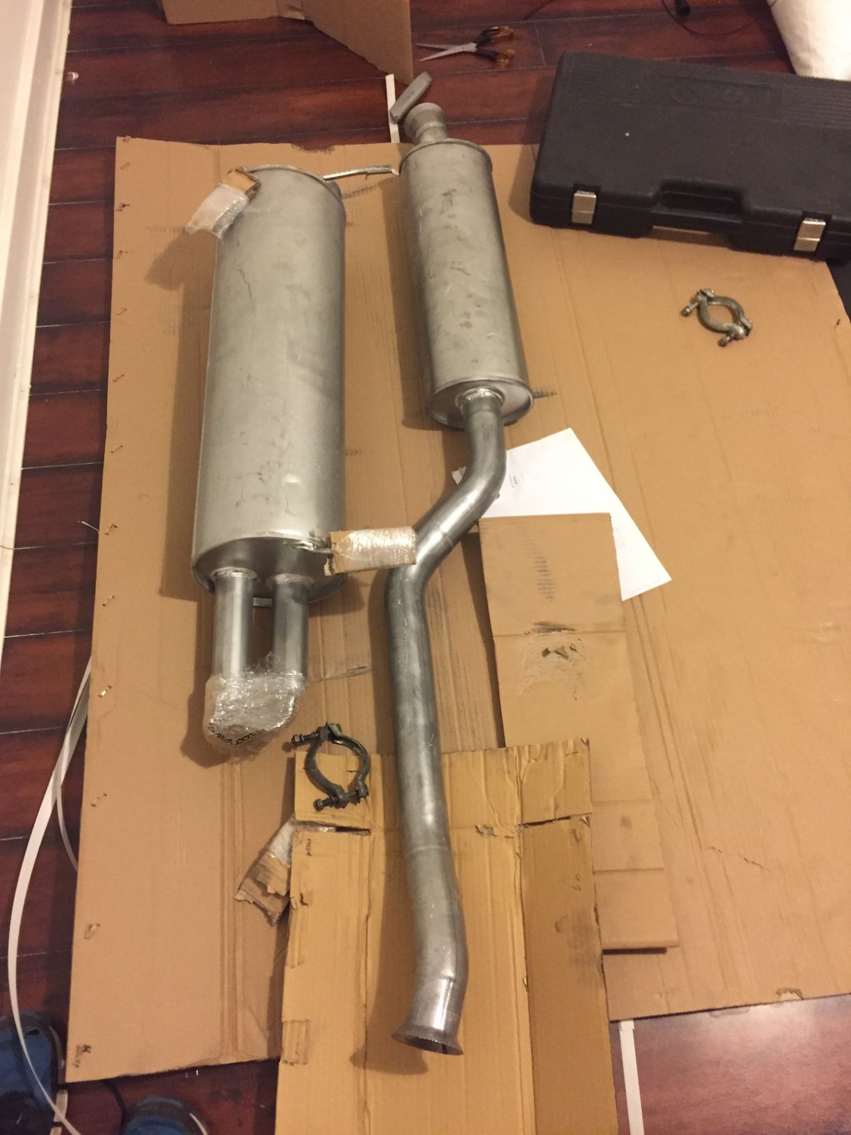

In other news my exhaust arrived yesterday:
Unfortunately this time it didn't come with clamps or rubber bushes as the last one I got did, so a quick trip to Halfords will be required tomorrow morning.
I do have some left over clamps from previous exhausts and one of them looks like it will work but I still need a flat pipe (U bolt style) 64mm one for the cat connection - I won't be able to use the original tapered joint as the outer cat tail is about to fall off so I'll have to hacksaw the tapered flange off the new centre silencer pipe, hacksaw some slots into it and use a regular clamp with plenty of sealant...

Next I repositioned the car to tackle the exhaust - as I suspected the pipe going to the rear muffler had completely broken in two.
The muffler came off easily but the connection to the cat was a fight due to all the rust and I ended up having to hacksaw the old clamp off. I managed to snap off the remaining outer skin of the cat tail to leave me just the inner skin. I sawed the flare off the pipe on the new centre silencer and cut some short slots - just enough for the clamp to bite as there isn't a lot of extra overlap beyond that.
Before fitting the new exhaust I noticed that both pipes coming out of the centre silencer were about an inch shorter than the old one. Whoops! Also one of the mounting arms for the rear muffler had been welded at the wrong angle and when I tried to bend it I noticed the weld was a bit weak as well as it was only welded on one side and looked like it would break if I put too much bending force on it...
I guess you get what you pay for...
I tried heating it with my blowtorch to bend it a bit easier but I guess my blowtorch is too puny as it wouldn't get anywhere near red and didn't make any difference! In the end I managed to clamp the mounting bracket in a vice and bend it with a piece of tube without putting strain on the weld, and got it near enough. I went ahead and started fitting it, sceptical about it fitting properly due to the centre silencer section being about 2" shorter in total.
The connection to the cat went well - plenty of sealant instide the overlap region then a regular 63mm U-bolt on the slotted portion - neat and sturdy. The muffler was a right pig to fit. I've never been particularly strong but for some reason I really struggled to lift it into place lying on my back without much room to work, and then had a real fight on my hands fitting the clamp - I had found a bag full of the proper single bolt Citroen clamps that I'd previously ordered and put away, and they're a right royal pig to fit.
It took so long to get the clamp right that I had to go back and add fresh paste and start over. Got there in the end though and they are very tight once on. To my surprise despite the shorter pipe everything seem to fit and line up well - better than last time!
I let it idle for a while until the pipe was good and hot to set the sealant - no leaks at all, then took it for a test drive. Sounds normal again and looks good too. Job two completed!
