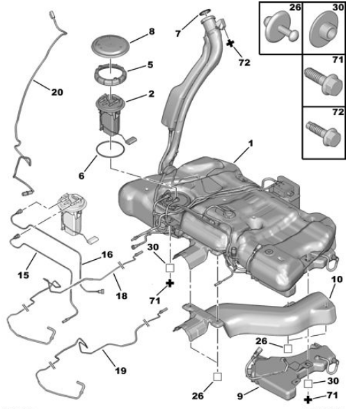

Please , does anyone know the location and ease of topping up the reservoir with the correct volume of additive ?. What is the recommended type with part No and where can I purchase in Australia outside of a Citroen dealer ?

I had answered this on your original post - but have moved my response here now.
Post your VIN up if you want to know the correct additive to use.
The additive can generally be bought in 1 litre or 3 litre kits.
Your DT20 engine is factory filled with 2.4 Litres of additive. So when the 'Additive Level Low' warning comes on, the engine ECU has estimated the remaining quantity of additive is insufficient to take you to the next scheduled service (based on remaining miles left to service indicator), so puts the warning up.
In your case, I would buy a 3 litre kit. The tank is just over 3 Litres in capacity.
You can buy additive kits from many suppliers on line, but is important to get the right one - hence the request for your VIN.
The additive tank is at the rear left hand side of the fuel tank - item 9 on the diagram.hayden641946 wrote: 11 Sep 2019, 04:33 Where do I find the DPF additive reservoir on a Citroen C5 , V6 3L Diesel , 2010, X7 Sedan .
Can I buy the fluid in Australia ?

Thanks so much for your help as I have bought 3L and filled the tank !
