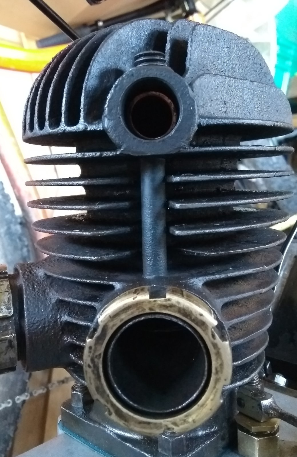

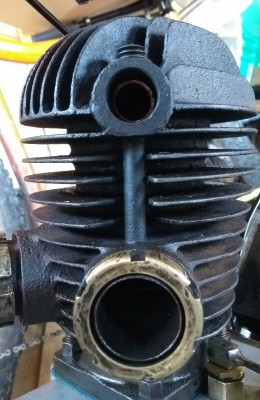

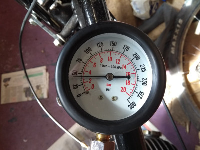

Compression tester arrived, I'll give it a go later and see what we have.
- Posts: 12578
- x 1487
Re: RichardW's Velocette rebuild
Annnnd...
Not going to start like that...
On to find someone to re-bore it. I suspect it is going to need a sleeve however - the piston fitted is not not original - it's a Heppolite and the casting mark shows it as a 2223, which from a table I found, is actually for an early GTP, which was the successor 2 stroke design, and should be just under 63mm dia.
However, I'm sure mine measures nearer 64mm at the base, which would suggest it's already a +40 thou piston - surprisingly these are still available, but I haven't seen anything bigger. So I guess it needs to be sleeved.... Found a Co that specialises in re-bores and sleeving, but don't know if they can do a cylinder that has an integral head. I'll get the barrel off tomorrow and re-measure the piston.

Bugger, did you measure the ring gap at top mid and bottom , mid is the one to take as bottom never gets used? So already a mm over, there may be someone who can supply the equivalent of cord rings? Are you in the Velocette Club or similar?

That is rather on the low side...
I'd still stuff some fuel down the bore and get the plug wicked hot to see what happens. Wouldn't be the first time I've seen compression get far better once the engine has run...

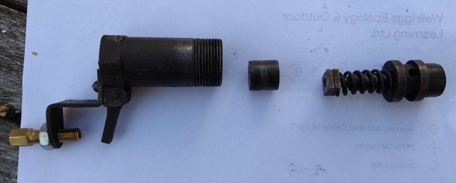

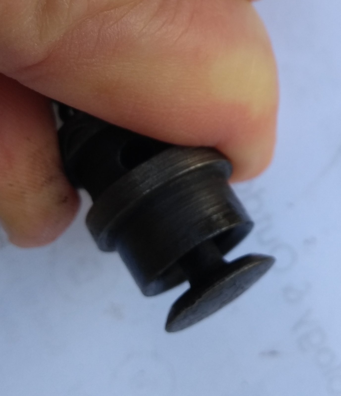

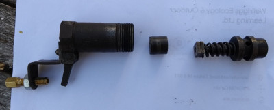

Richard, could you explain the decompressor please. As I understand it a decompressor reduces the compression within the cylinder when the engine isn't running to assist with starting (making it easier to turn the engine over be it by foot or starter cord). My chainsaw has a small button that you press, when the engine starts the pressure within the cylinder at higher revs pushes the button back out closing the 'leak'. Briggs engines have an automatic decompressor that partially holds a valve open using a centrifugal device that runs off the crank. The reason I mention the Briggs engine is because of the auto decompressor you can't do a compression test on the engine without turning the engine over fast enough to release the decompressor.
If your cylinder was being tested with the decompressor working the figure won't be accurate.
Pete
- Posts: 12578
- x 1487
Decompressor is manual - here's a picture of the parts.
The bit with the spring has a poppet valve in it. It is clamped into the cylinder head by the pipe with the operating lever on it. When the lever is pulled, the cylindrical block transfers the motion to the end of the poppet valve and opens it:
Which then allows the compression to drop away down this tube to the exhaust port.
If the cylindrical block is not fitted, then the valve cannot open, and you have full compression. I checked the compression both with and without the block fitted, and got the same answer.
I didn't measure the ring gaps - they were new rings, and pretty tight at the bottom. I can't get my hand in the bore to push them up, but perhaps no 1 son could!
Video coming later when it uploads, it's rather big...

So the decompressor, when opened, vents to the exhaust port via the pipe. The grub screw(?) above the decompressor port secures the valve assembly. The hole between the shoulders on the valve assy aligns with the venting pipe and allows the valve, when open, to vent internally through the valve assy to the pipe. The cylindrical block then screws in to the port and actuates the valve assembly?
What does seem odd is the result decompressed or not. This surely means that either the cylinder has got such low compression that that the decompressor makes no difference or the decompressor is leaking air when closed. There are two things that come to mind. A leakdown test, with the piston at TDC and the decompressor closed no air should escape through it's fitting port. Also you can hear where the air is escaping from. If you haven't got a leakdown tester you could make a disk (coin perhaps) that could block the internal opening of the port, sealed with a bit of RTV, and possibly refit the cylindrical block with a spring (that you've had in a box for years) to hold the disk in place to take the decompressor out of the equation.

You can pretty easily tell if those simple decompressors are sealing properly be ust putting moderate pressure on the kick starter and see how slowly the air escapes to let the piston rise.
The decompressor is the normal way of stopping the engine (the kill switch). It can also be used to make the bike easier to push when puch starting, I never found them to be very helpful (on this type of engine) when using the kick starter.
My feeling is that although the compression on this engine seems low, they were never a high compression engine, and it is probably not what is preventing it from starting.

If the decompressor is opened there's no compression at all. Taking the cylinder block out was to check that it wasn't being held open. Video of it trying with fuel direct into the cylinder might be instructive, I'll get it up tomorrow.

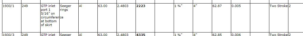

Just found this, it's on 'barnstormers' site. Although the GTP it may be of use? It does mention care when fitting the piston.
http://www.barnstormers.co.nz/barnstorm ... /GTP1a.pdf
On the same site is a list of part numbers.
