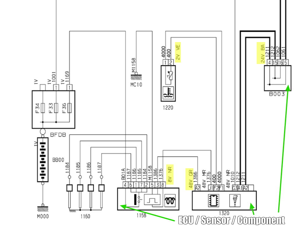

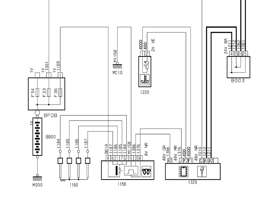

Ok, here you go:
Click Image to Zoom
1320 is the Engine ECU
1158 is the Pre-postheating Control Unit
BFDB is the fuse box at the battery outlet
Connections:
(1158) 8 pin Black Plug
(1320) 48 Pin Grey Plug
Wires:
1376: Pre/post-heat unit command
1386: Pre/post heating diagnostic info
M1158: EARTH m1158
1184: Pre-heat plug 1 command
1185: Pre-heat plug 2 command
1186: Pre-heat plug 3 command
1187: Pre-heat plug 4 command
B01A: battery +
Click Image to Zoom
Connections:
Wires:
M1158: EARTH m1158
B01A: battery +

Ok, so look below - the diagrams are vastly too complex to show everything - so they are split to show only the relevant area required (that's why there can be hundreds of them...)
In this example, only the Pre/ Post heating relevant items are shown.
In green I have marked what can be an ECU or a Relay or a Sensor.
Along the edges highlighted in yellow are the relevant plug connectors. In the case of the Engine ECU (1320) there will be lots of connectors. But in this instance, we are interested in the Pre/ Post circuit for the Glowplugs - so only that plug is shown - in this case the 48 Pin Grey plug.
On the Pre / Post heating Control unit (1158) there is an 8 Pin black plug which is the relevant bit as it connects to the engine ECU.
So going back to your question - the engine ECU will have potentially multiple plugs going into it from other sensors and components - but you are only interested in the 48 Pin Grey one. The plugs are indicated by the yellow highlighting. The Pin outs are shown in the diagram for the plug - in this case for example, A2, J1, F2 etc.
So for example wire 1386 (Pre/post heating diagnostic info) on Pin 3 of the 8 Pin Black plug of the Relay control Unit (1158) goes to Pin A2 of the 48 Pin Grey Plug on the Engine ECU.
The pins are marked on the plugs / sockets.
As for the screws - these are crucial plugs so are fixed with screws to help prevent them falling out under the weight of the wiring harness, as that could be disastrous when motoring of course to suddenly lose all engine power and just about everything else. They should be removable - but may need a technique or tool to do so and should not need drilling out.

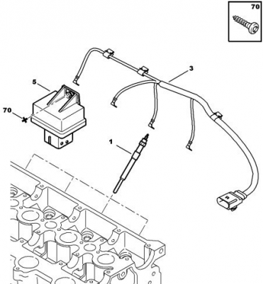

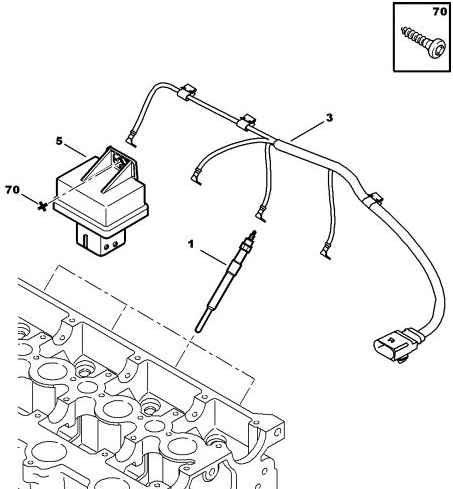

The pre-heating time varies depending on engine temperature and the pre-heater control unit is piloted by the engine ECU.
Item 5 is the Glow Plug Pre-Heating Box:
It will be either:
NAGARES BDL/7-12
CARTIER 51 252 002
Part number: 598140
Diagbox will allow a forced regeneration, but remember the glow plugs are only used where needed to assist with regeneration - not all the time - but usually when the engine is not getting to temperature quick enough - and secondly, if there are any fault codes with the engine management system, it will not allow a forced regeneration for obvious reasons. A forced regeneration puts a big strain on engine components and it will rev the engine over the 3000 mark, which it cannot do if the engine ECU has gone into a specific backup mode.
So it all depends.
