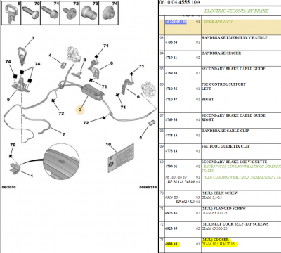

RichardW wrote: 29 Aug 2019, 10:10 In the parts list it says with the latest unit that you should also take this item: 73
6983 43
Which is presumably a plug to put in the hole where the cable no longer is - it's not shown on the parts dia for the handbrake - but I found it on the body blanking dia, item 3:
The picture for that seller you linked to is not for the earlier models - (470205, 470208, 470210) and agreed 470214 is the replacement part for these earlier models - but the even later part is 1612865480 which is the one you linked to with no cable.
470205 shown with release cable:
As for the plug - it is also shown on the current handbrake diagram which I've highlighted:

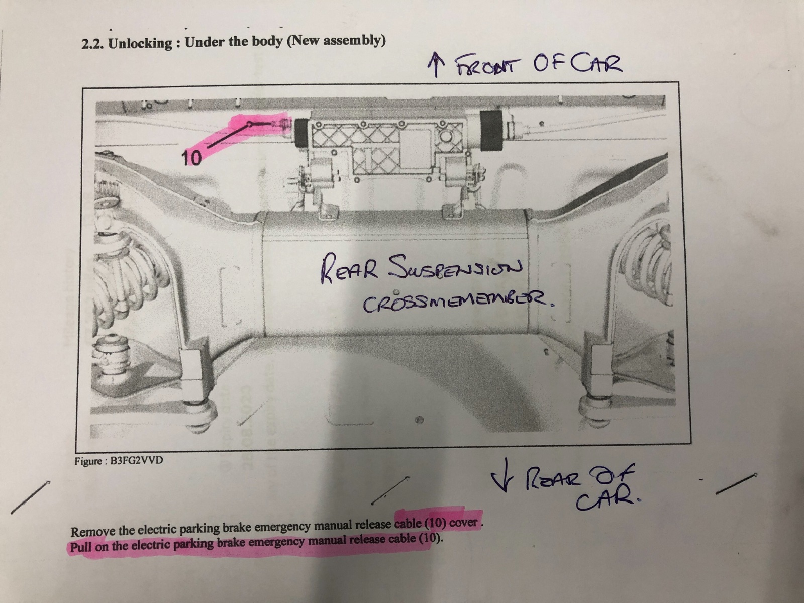

The Indie has confirmed that the release mechanism for the new part is within the unit. To manually deactivate the handbrake in future I have to climb under the car, remove the cover on the EPB that RichardW mentions, and pull the release insider the unit.

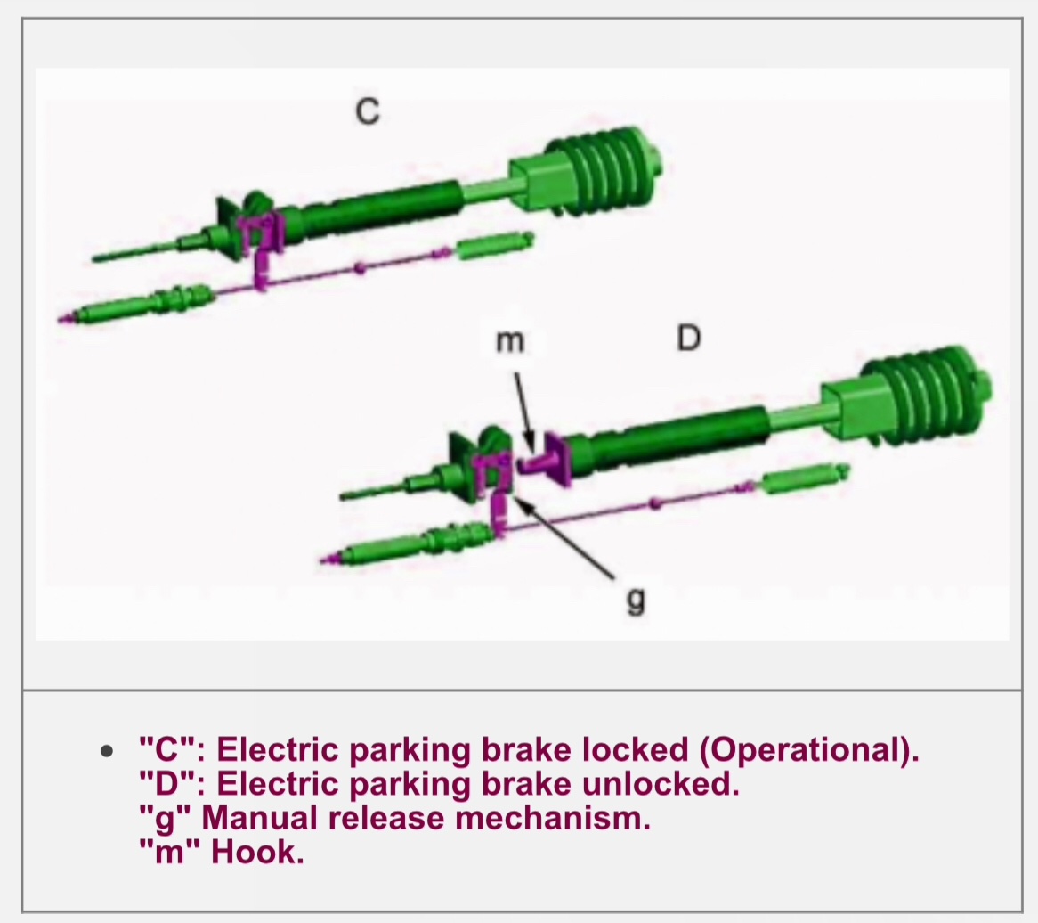

x 6947

The third cable is connected to the yellow release handle in the central console. That unhooks the release mechanism in the EPB. See ‘G’ below.
It is this cable (the manual emergency release) that was no longer fitted to models during the last year of production and is no longer it seems supplied with replacement EPB modules.

The new EPB has a release cable, which will require crawling underneath to release. It’s item 10 on the following diagram. Removing a pull-off protective cover allows access to a ‘ring pull’ lever, and yanking this will release the handbrake. A backward step compared with pulling a cord in the glovebox!
