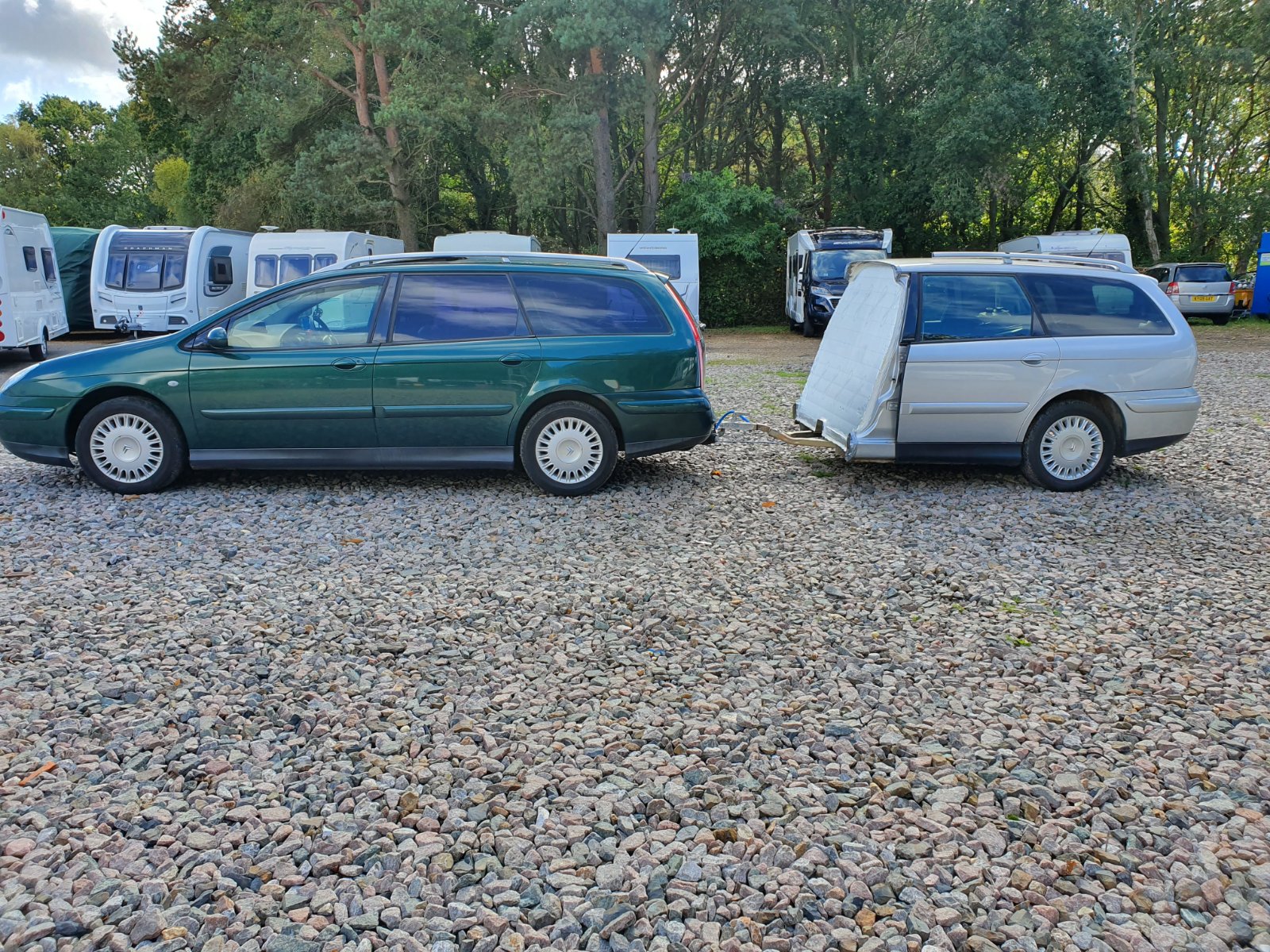

hi there, i am working on a little project, i just bought a smashed up c5 estate, i am going to cut the back off and turn it into a c5 caravan, but i would like to get the suspension working and raise it up from the rear boot height switch, can anyone please help me find a wiring diagram for the pump so that i can use it? many thanks for your time, hannah

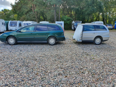

ok i have manage to rewire the pump with the switch in the boot, and had to do a few mods to the pump in order for it to work, but after 2 weeks on trying to look at the wiring etc i manage to get it all working,
