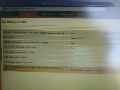

I attached a few pictures, thats what i can gather about the DSG from the diagbox. I see that its PROHIBITED, but why

Strangely I dont have those optionsGiveMeABreak wrote: 31 Jul 2020, 14:47 5) From the next screen, there should be a Deactivation / Activation option from where you can enable it.
