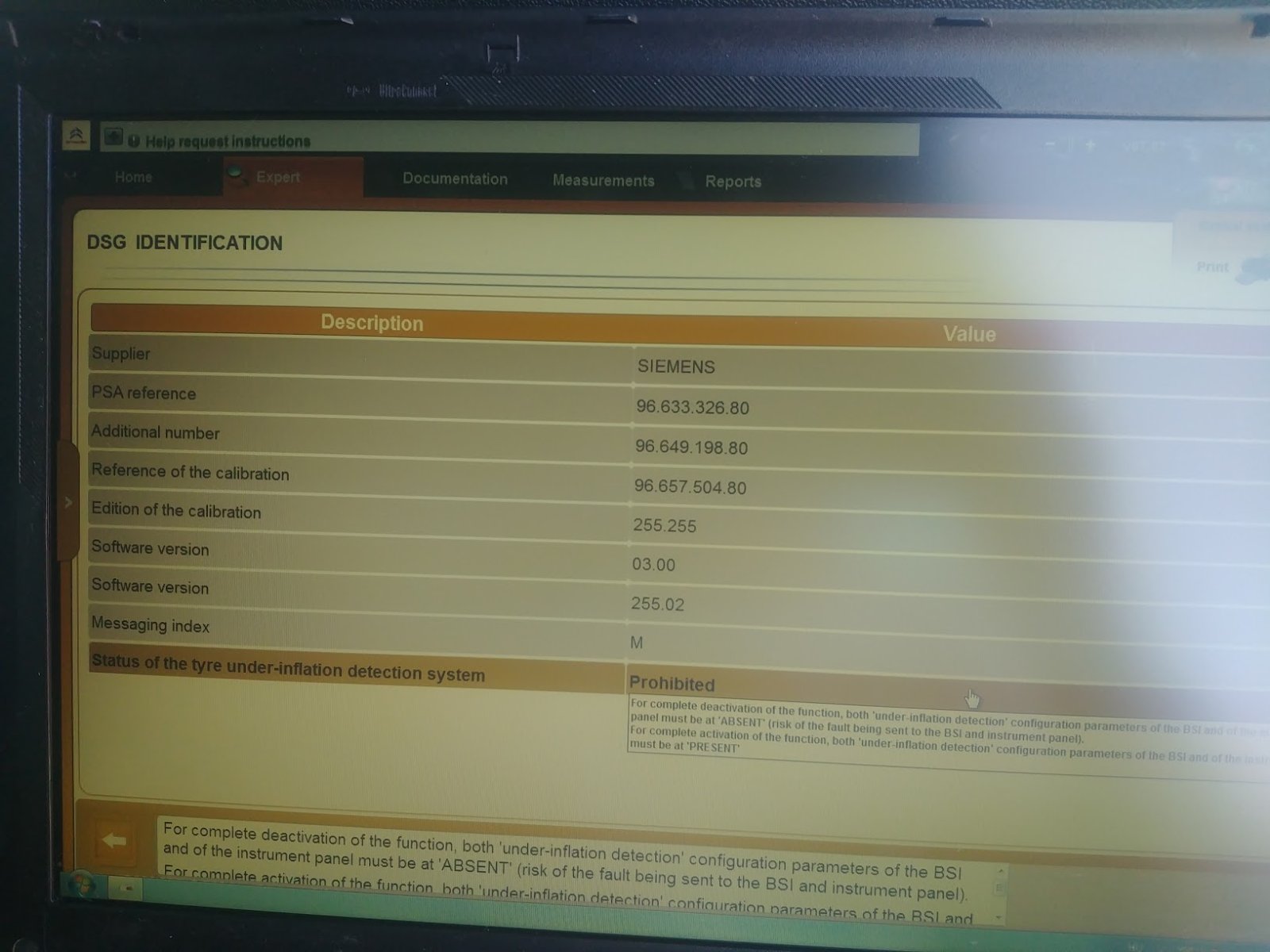

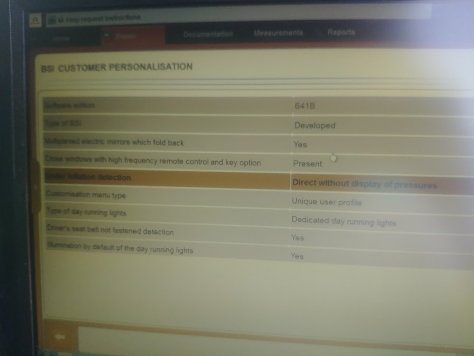

Previous owner disabled the TPMS in my 2011 C5 3.0 HDI, 2 seperate tire shops failed to enable the TPMS, so i bought my own diagbox.
C5 is missing these menu entries so i guess they are in a different places?The system can be disabled in the BSI configuration by setting the 'Under Inflation Detection ECU' to absent. Re-enabling the function is the reverse, but also requires the 'direct without pressure display' setting to be configured in the 'type of under-inflation detection' in the 'configuration then definition driving information vehicle equipment' sub menu of the BSI.

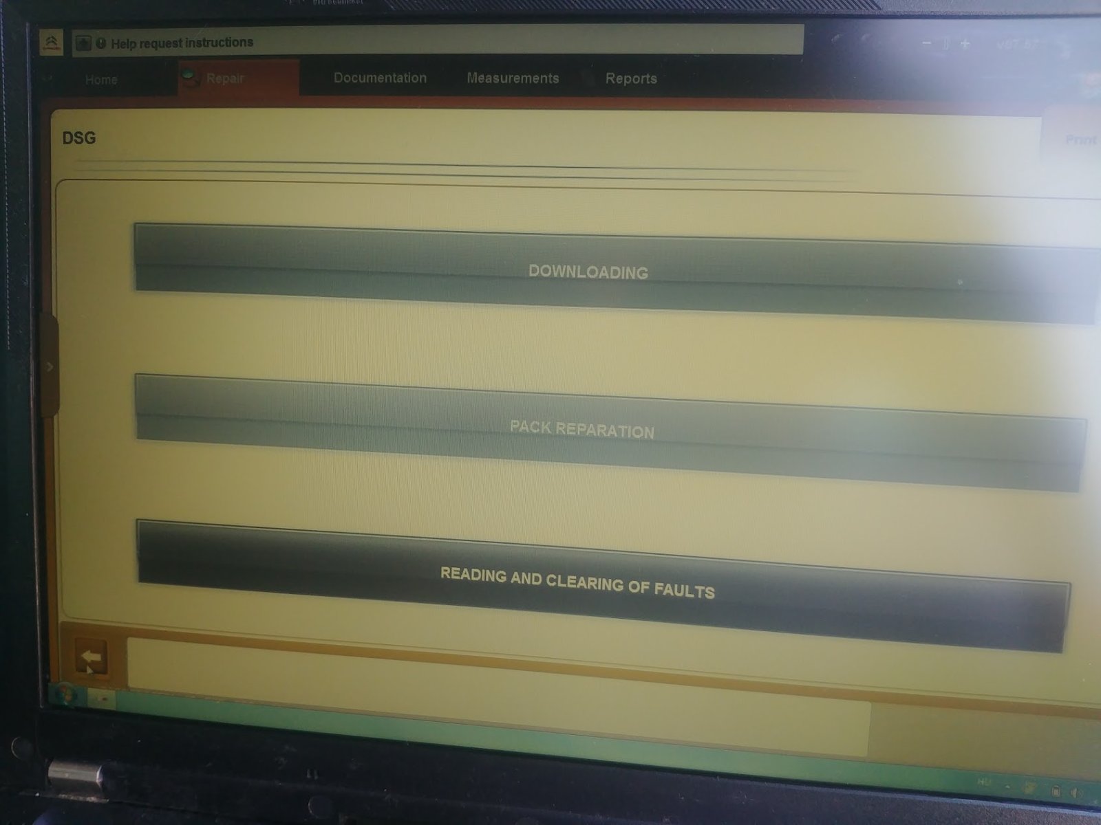

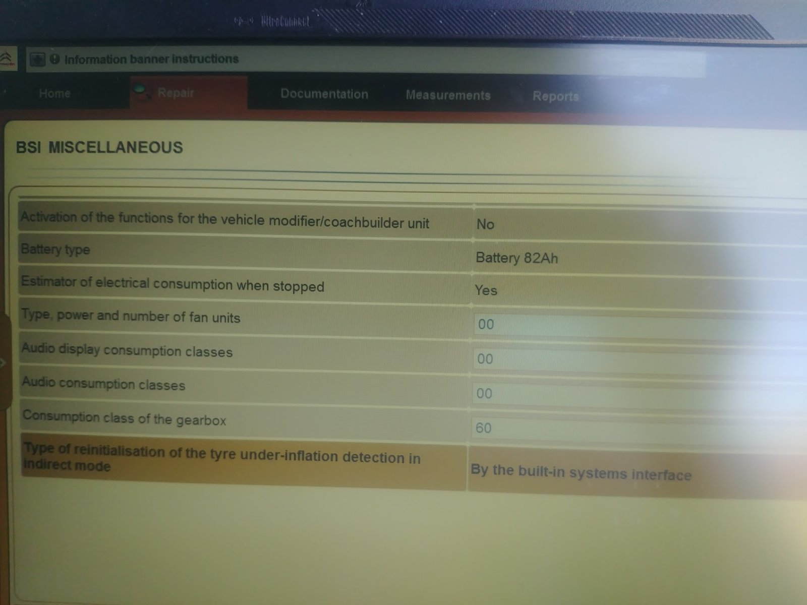

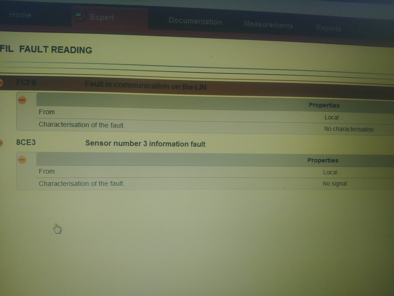

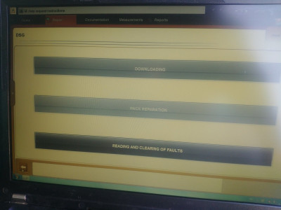

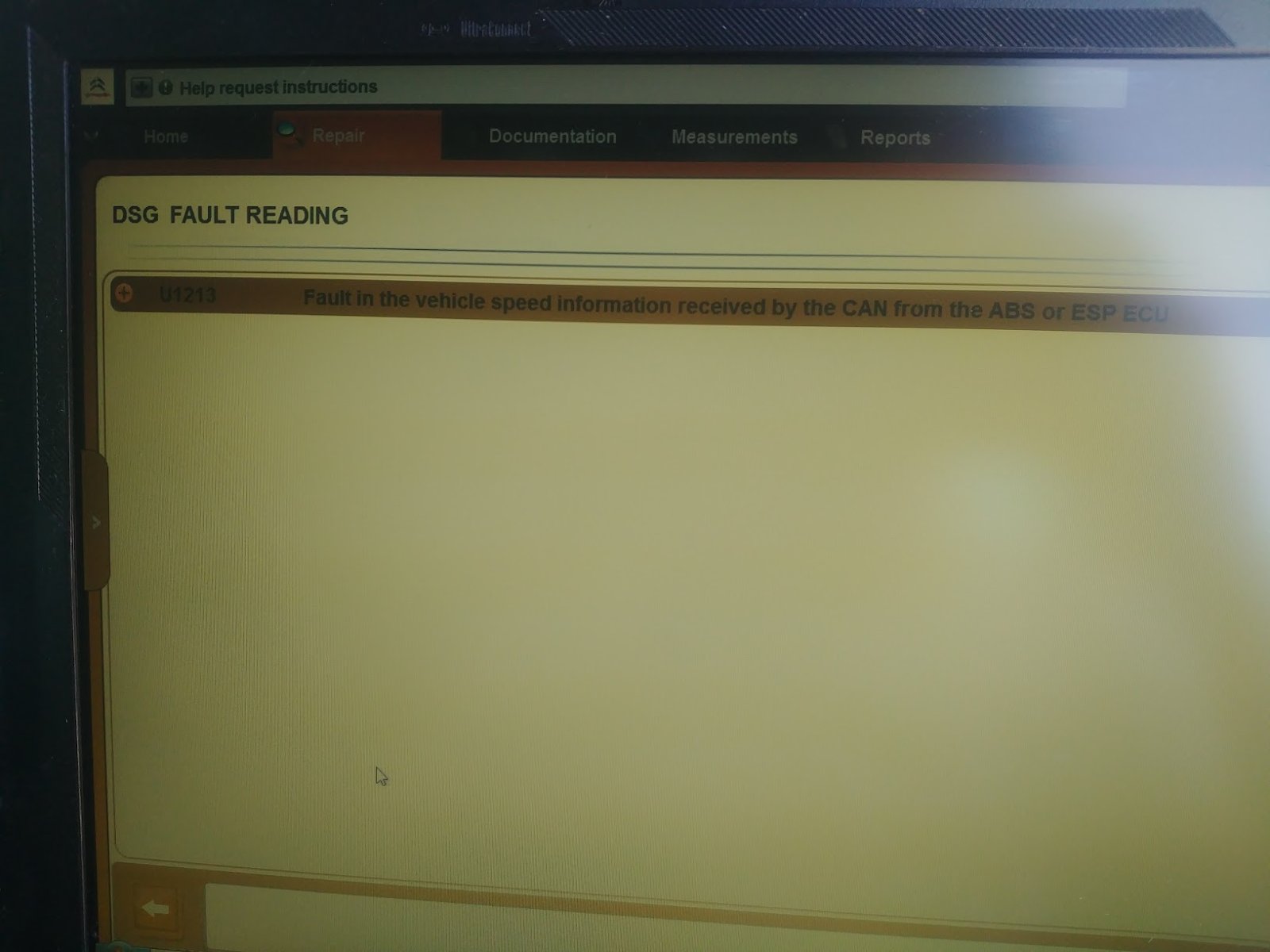

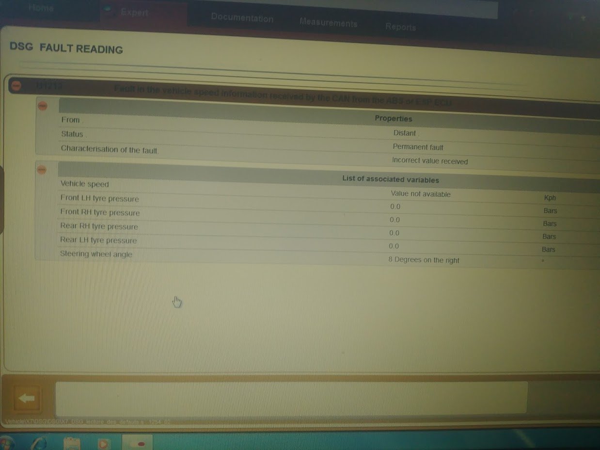

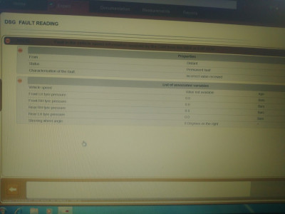

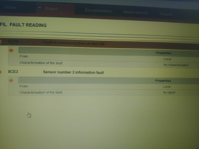

Falka
- Posts: 69
- Joined: 01 Feb 2020, 20:43
- x 5
Re: Citroen C4 - Tyre Pressure Sensor pairing
Thanks Marc on helping!
I attached a few pictures, thats what i can gather about the DSG from the diagbox. I see that its PROHIBITED, but why
Thanks again
Rob
7.57
Strangely I dont have those optionsGiveMeABreak wrote: 31 Jul 2020, 14:47 5) From the next screen, there should be a Deactivation / Activation option from where you can enable it.
Thanks again
Rob
- x 6947
I can’t deal with this right now as I’m restoring my rigs, but will take a look once I’m back in the land of the living - Windows 10, say no more.....
