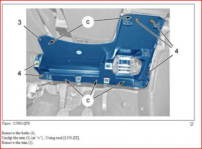

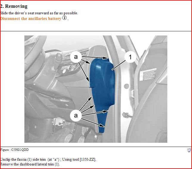

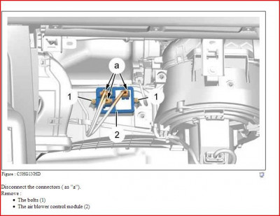

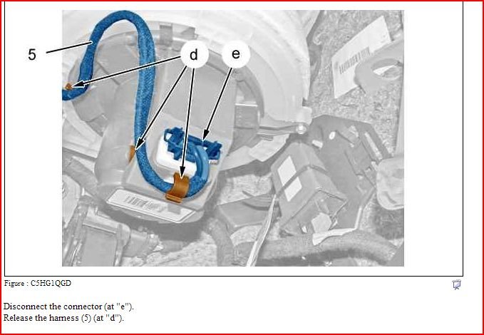

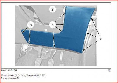

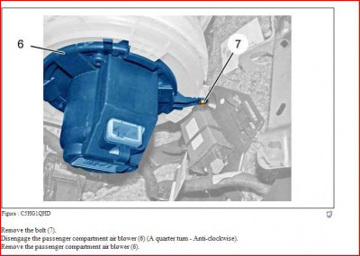

Unread post by RichardW »
There looks to be only 1 type of blower and controller for all Mk2 cars.
Blower removal
Controller is next to the blower on the ducting, this is removing on a LHD car where it's behind the glovebox, it looks like it will be visible once the panel is removed as per stage 3 above.
