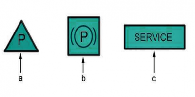

Ok, so here is the common fault - and below the table are the symbols / warning lights that 'a, b & c' refer to.

| Switching on of the warning lamp and/or warning message | Warning lamp - "a": lit - "b": lit - "c": lit |

| Switching on of the warning lamp and/or warning message | Warning lamp - "a": lit - "b": On for 10 seconds after the request for application or release - "c": lit |
