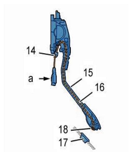

It uses both.
Clutch switch (for manuals) / Brake switch and also with speed limiter uses a 'kickdown' zone to override the limiter function in an emergency, referred to as the Hard Spot or Point of resistance. It consists of a switch (18) in the accelerator pedal that is activated when the accelerator is kicked down hard against the hard plastic stop (17) on the floor under the pedal. Shown below as
So it is important that the right accelerator pedal and harness is fitted if not standard, as there are several types - again - depending on model.
