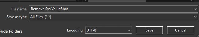

  5. I have written a batch file that will do this for you. Open notepad on your windows PC and then press the 'Select All' option on the code window below to copy all the code and then paste this into notepad.
  6. In Notepad, from the File menu, choose 'Save As' and make sure you change the 'Save as Type' option to All Files *.* as shown below and save as 'Remove Sys Vol Inf.bat' (without inverted commas). Save it to a location you can easily find on your PC.

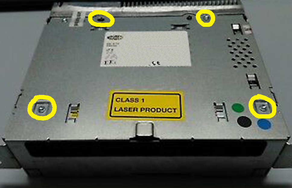

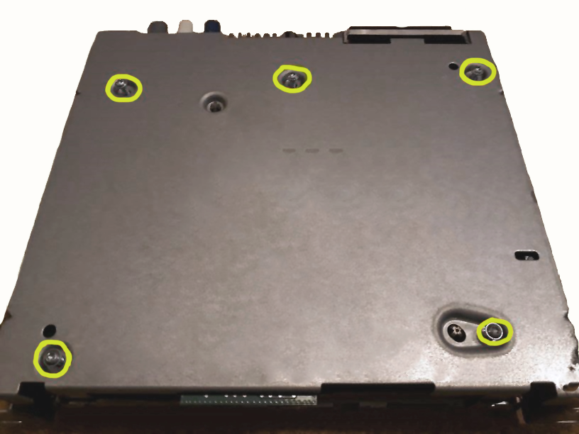

Essential - disconnect the battery (detailed above) and carefully remove the unit from the vehicle.
Undo the 5 screws circled.
Remove the screws from the top cover and remove the tamper proof seals (this will void any warranty you may have).

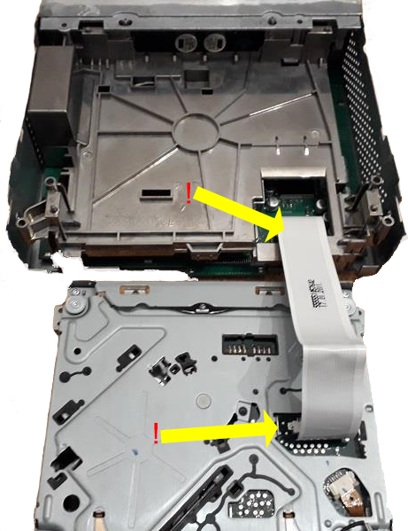

Caution: Fragile ribbon cables attached underneath CD Unit
Gently remove the case.
Remove any screws holding down the CD unit - but beware this is attached with ribbon cables!.
After you have moved this away, leaving the cable attached,
gently raise the motherboard to reveal the MicroSD card shown at the side.
Gently push this in and it should release itself so you can slide it out as circled.
