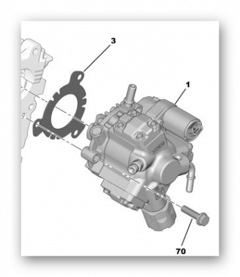

It's cranking and no fuel Neil, I've disconnected the pump connector to the fuel rail and spun it over, there's just a dribble out of the pump, took off the flow control solenoid and bench tested it, it works, there's a regulator (1 in the pic) in the bottom of the pump (an electro-valve) that I can't get at in situ so tomorrow the pump's coming off for a closer look,,,,,,,,,,,,,, and at the camshaft end dog Richard mentioned.

I've disconnected the input pipe at the pump, there's ample diesel getting that far so not a low pressure problem, thinking about it makes my head ache, could it be electronic such as the emergency fuel shut off or one of the sensors but I guess the only way to find out is to get on with it.

Thanks for trying Neil, I've already been down that path without any luck, pumps on the bench now and have to decide what to do next, camshaft end and dog drive are ok, still cant get any pressure from the pump but is it the pump or the regulators?
Another series of silly thoughts from me......Got the fuel pump on the bench and run it up to speed , it just dribbles out of the return pipe nothing out of the high pressure pipe, I've bought a second hand one and waiting for it to come....

The pump has a flow control valve at the top and a regulator on the bottom, they both seem to work ok when voltage is applied, the pumps in bits on the bench now and the only thing I can see wrong (apart from wear) is the inner shaft seal looks a bit dodgy.
