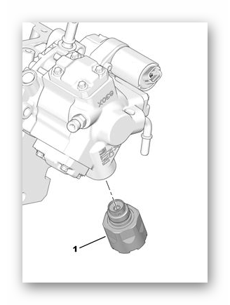

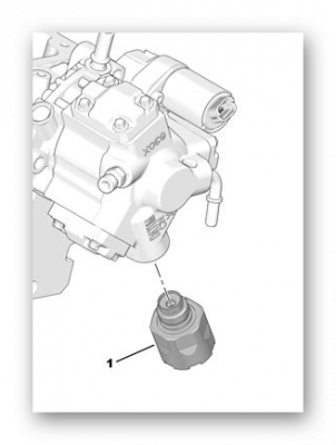

It's cranking and no fuel Neil, I've disconnected the pump connector to the fuel rail and spun it over, there's just a dribble out of the pump, took off the flow control solenoid and bench tested it, it works, there's a regulator (1 in the pic) in the bottom of the pump (an electro-valve) that I can't get at in situ so tomorrow the pump's coming off for a closer look,,,,,,,,,,,,,, and at the camshaft end dog Richard mentioned.

The pump has a flow control valve at the top and a regulator on the bottom, they both seem to work ok when voltage is applied, the pumps in bits on the bench now and the only thing I can see wrong (apart from wear) is the inner shaft seal looks a bit dodgy.

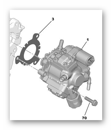

Pump finally arrived yesterday morning and is part fitted, got called away for other things so had to leave it there, now rained off again

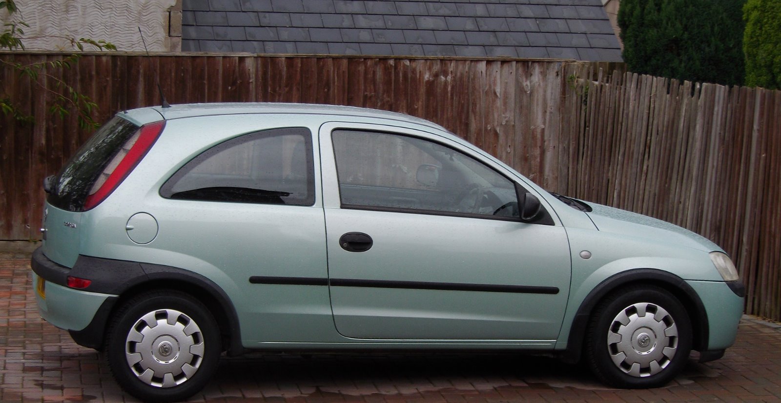

Here's the Corsa, remarkably clean for it's age:
- Posts: 26419
- x 7164
Re: Silly thought.
Looks good, hopefully in the just put fuel in and go condition. I have 2 corsa "C"s like yours in "my" fleet of maintenance reponsibilities.

So the saga continues, the pump didn't fix it in fact it's popped up more codes on the diagnostics.
Back to square one:
Here's the story so far.
Cars running quite well but a diag says it has a faulty fuel cap or neck sensor so the DPF isn't going to regenerate.
Cap has a magnet missing, new cap doesn't fix it
Neck sensor changed still no fix so move on to the other diag fault, pre/post heating, chech#k the glow plugs, only one working so replace them along with the control unit.
No codes now but the eml is on and the car won't start.
Diag with a Snap on tester, shows zero pressure at fuel rail.. must have disturbed something while doing the glow plugs, check back, nothing obvious.
No fuel from the ho pump while cranking, is it the pump or one of the sensors/solenoids? Can't tell so off with the pump.
Can't get anything out of the pump by bench testing (set up a rig with a fuel tank directly feeding the pump and driven by the rattle gun and a suitable adaptor with voltage applied to either or both solenoids). Just a small dribble from the return pipe. Conclude a pump's needed. New pump £600+ recon £380+ so go for a used one off a running car for £80.. a gamble!
Fit the pump and...…………………………….
I think I need a wiring diagram to go through this wire by wire..........or return the car from whence it came.
