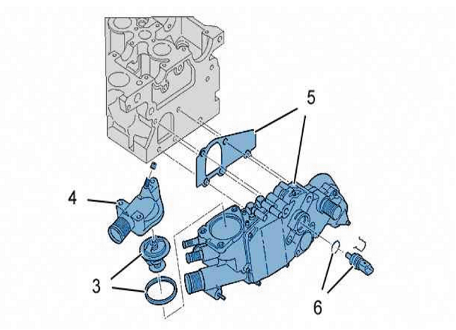

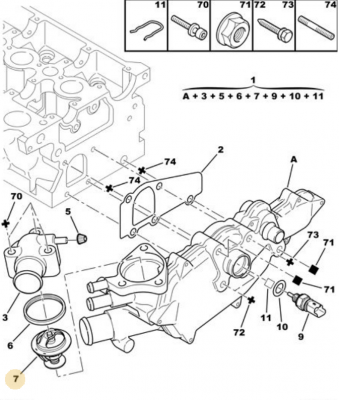

What about the Engine thermostat? Item 7 on the left diagram and 3 on the other? Part 133823
Also some water temp sensors on the aftermarket aren't up to much. Part 1338C1 (item 9 on the left and 6 on the right diagram).

Agree with Marc's suspicion about the thermostat - it sounds like a sticking one, reluctant to initially open, then allowing a sudden volume of cool water through. Action should be gradual and progressive.
Cheap enough to replace; make sure it comes with a fresh gasket/O-ring.

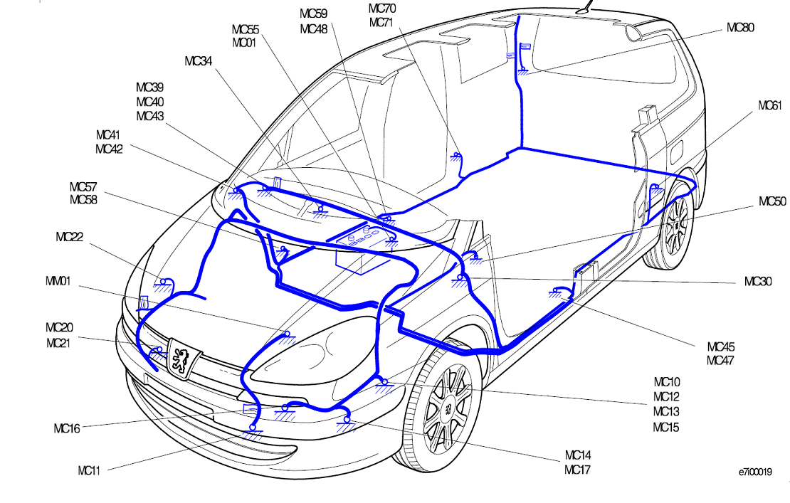

This is the wiring between the Temp coolant Sensor (1220) and the Engine ECU (1320). Given that you have had 3 sensors - I would be suspecting the plug or the wiring to the engine ECU. I would suggest taking the connectors off the sensor - checking to see if the pins are making good contact (sometimes they can retract causing an intermittent connection) and then clean them up.
The Sensor plug should be a 2 pin green plug with the following wires:
4000: Coolant Temperature Sensor Earth (Pin 1)
400: Coolant Temperature info (Pin 2)
They go to the engine ECU 48 pin Brown plug on pins D1 and E1
This is the location of the earthing points - so I would check the MC15 and MC12 earths which both concern the engine ECU. Make sure they're not rusty or making poor contact.
