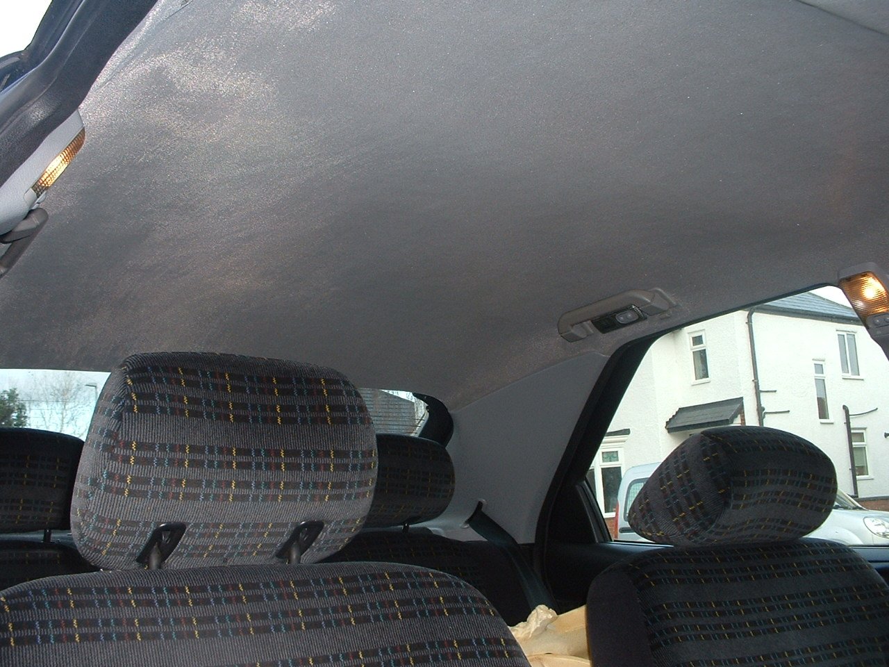

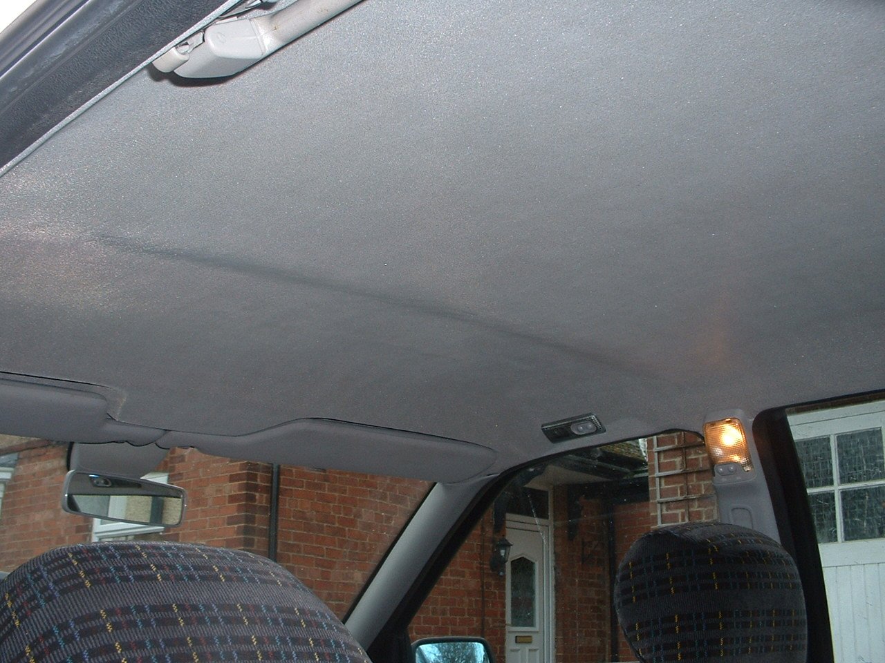

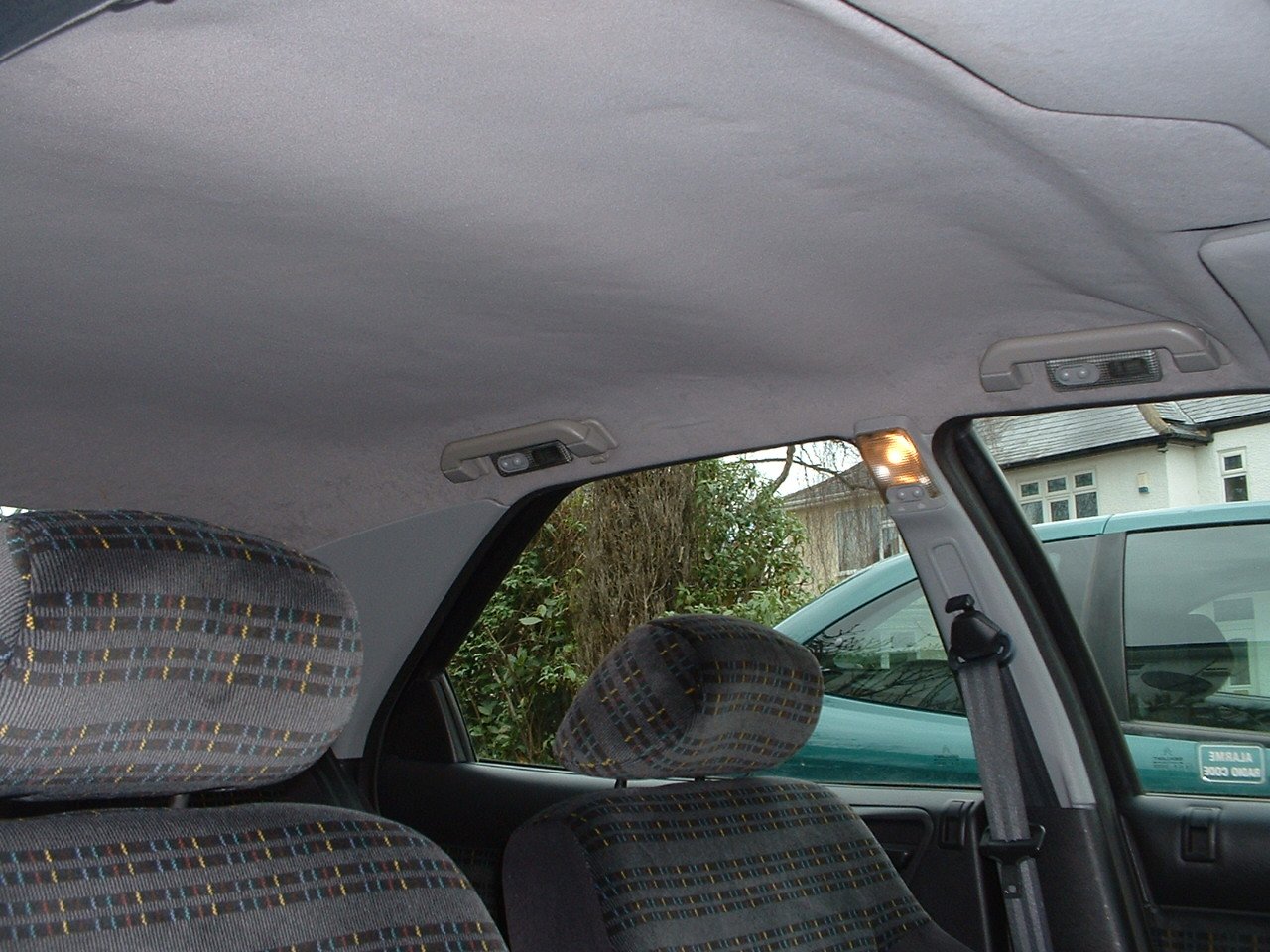

Skull wrote: 13 Feb 2019, 13:36 13 Feb 19 fully fitted
Had to re-do it properly as gravity beat the previous effort. (www.woolies-trim.co.uk 285-GRY-D)
25 Jan 20
Skull - new headlining Jan 2020

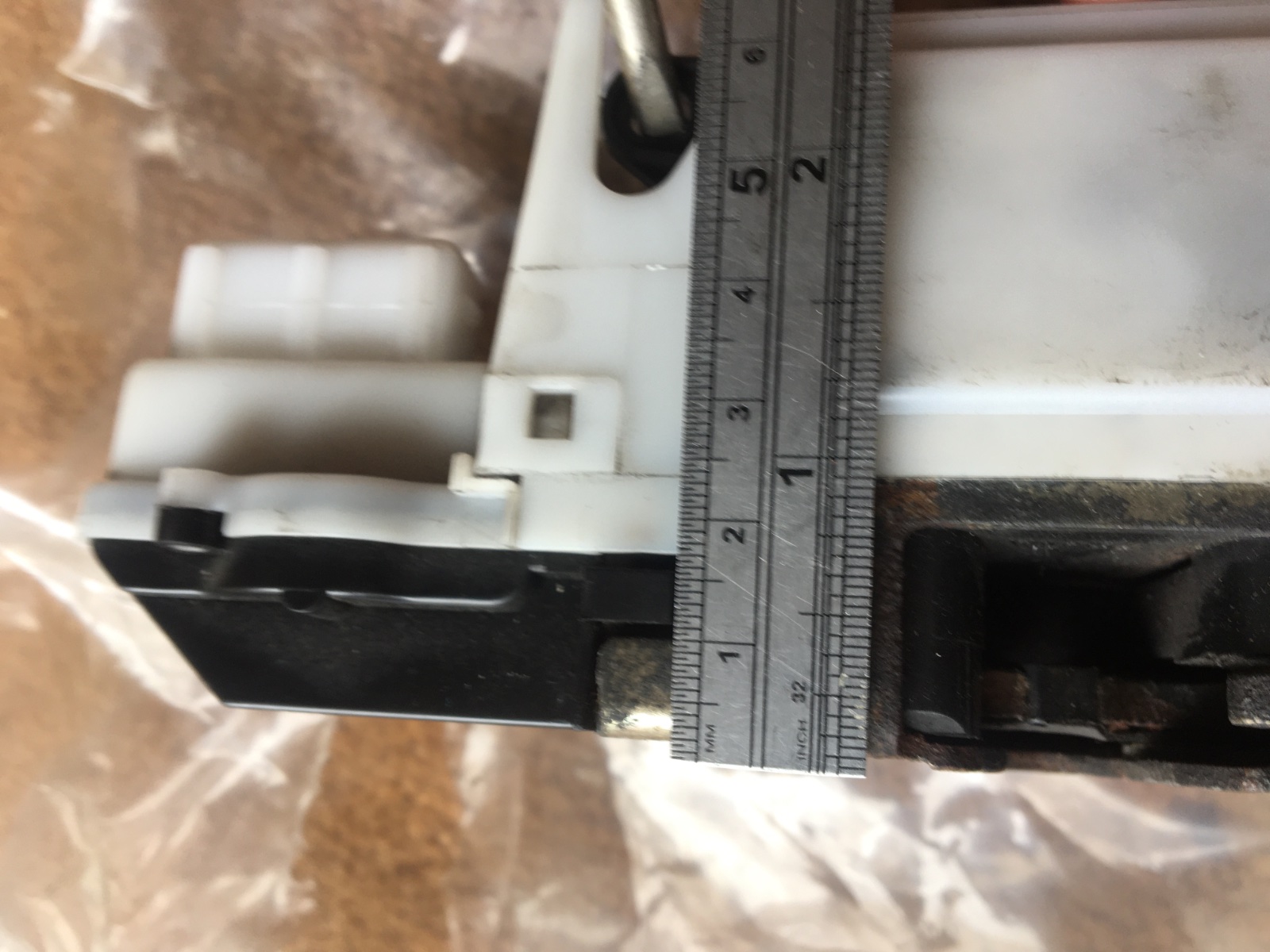

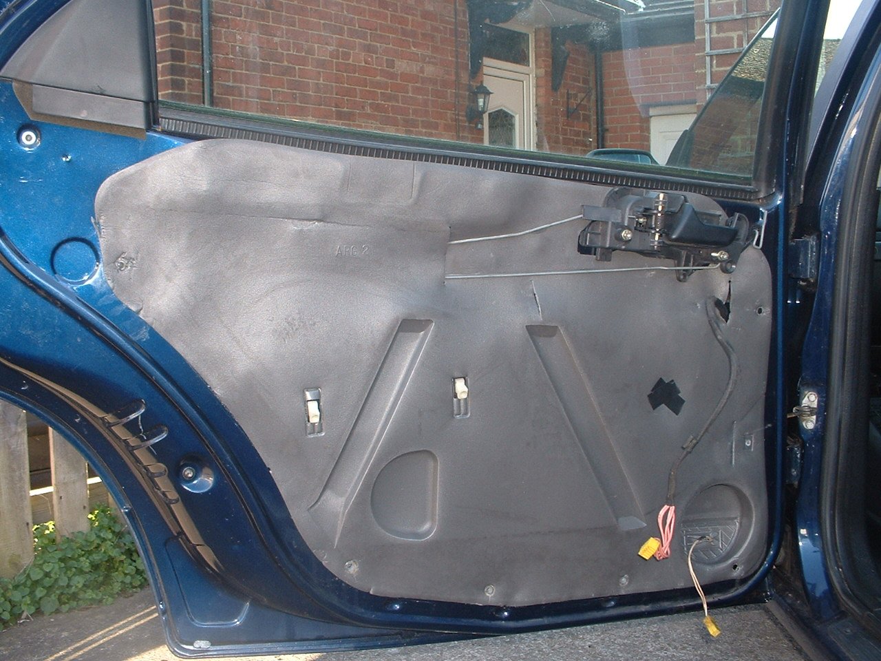

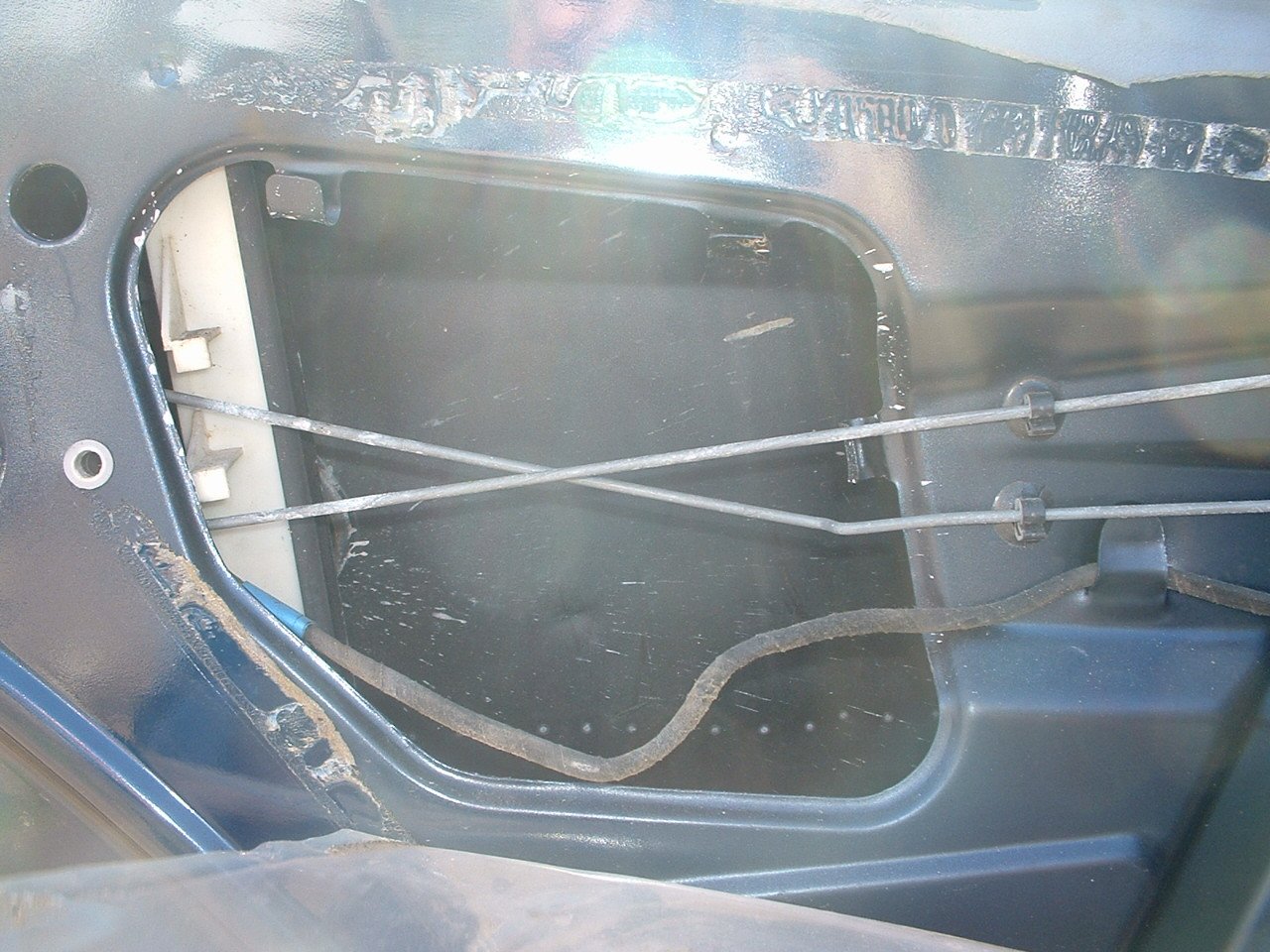

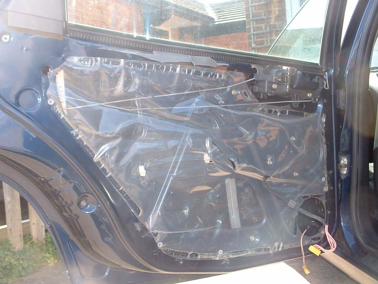

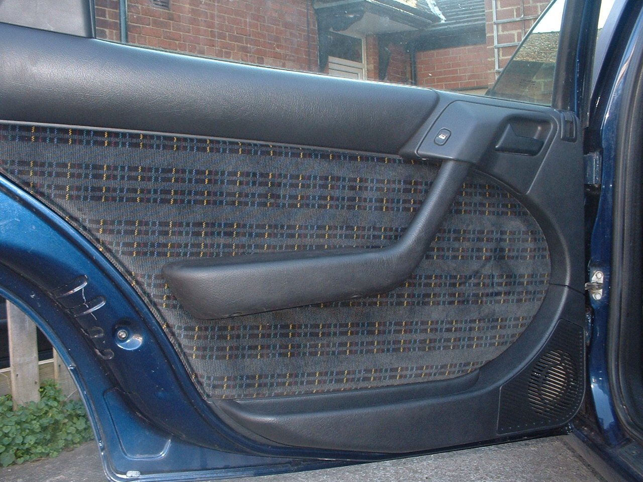

Door would only lock intermittently, the door had been damaged at some stage of it's life before I got it.
I had thought it was due to poor re-assembly as a few fasteners were missing but even with the lock removed it required assistance before the lock would operate either way. Once removed a squirt of WD40 immediately restored it so something internal must have been seising up. Re-fitted with proper fixings, taped loom where exposed and spare 2nd hand membrane - all working.
The attachment DSCF0001.JPG is no longer available
Skull's Sticky door lock previous
Skull's Sticky door lock trace of needles where it's been pulled out,  lock and window loom poorly routed/fitted
Skull's New membrane and missing/broken fixings replaced

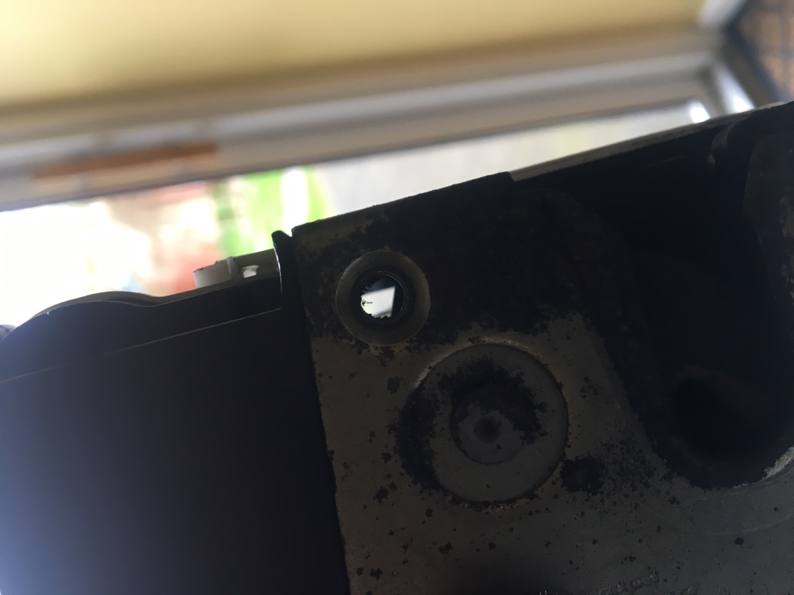

EDIT After doing this job and examining the difference between XI (photos below) and my X2 (more metal components in latch mechanism) a quick fix might have been possible by removing the one upper and inner screw and operating the external handle which opens an internal aperture allowing you to squirt lubricating fluid into the majority of the components. In my case I wanted to see the previous repair that had been carried out anyway and improve the fixings/membrane.
Skull's fully re-assembled and working
Skull’s lock aperture
Skull’s lock 20mm depth to mechanism

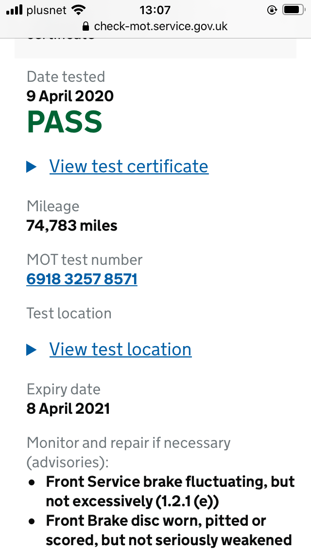

Skull’s MoT
Skull’s MoT
Now I need some grippier tyres - a short drive back from the MoT has highlighted that the turbo is working (gauge read 9 PSI) =D> but the Uniroyal RainExperts 3 are not up to the Activa requirements 8-[
