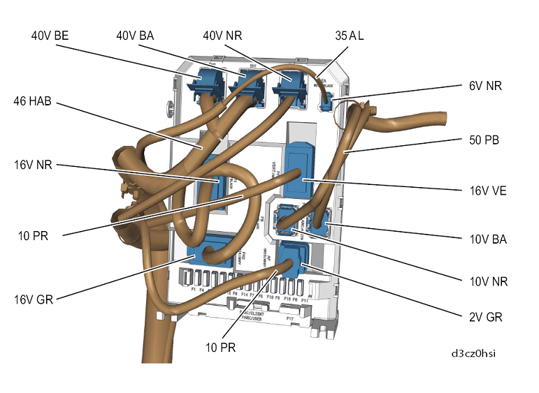

Here's the Engine ECU Location:
Harness 10PR is the one that links the engine ECU to the BSI
Here's the BSI (driver's side LHD) behind the cubby hole IIRC:

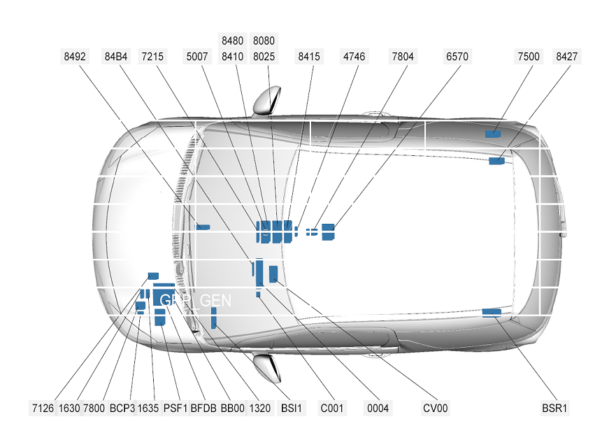

General location on the car. The Engine ECU is number 1320, the BSI is BSI1:

Hi Marc,
I have checked the connections on the BSI and the Engine ECU and there are no signs of corrosion. They look as good as the day they came out of the factory.
I have managed to look at a wiring diagram and found that pins L1 and L3 on the Engine ECU go to injector 4. I have checked the plug across these 2 pins with a multimeter and they are not short circuit, so I am not sure where that fault code P0271 is coming from.
I have not located the ESP ECU.

It's Pins L3 and M3 that go to injector 4, L1 goes to injector 3.
7800 is the ESP ECU on the diagram in my previous post.
Below is the Injection ECU for your vehicle: 1334 is injector No 4 (1331-1334 Injectors 1-4)
