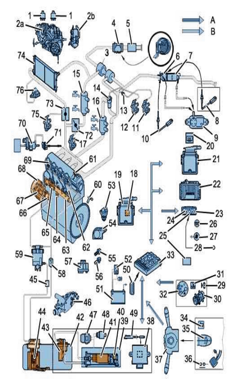

Harlequin wrote: 12 Aug 2019, 13:52 i had a mk 1 2.2 HDi with DPF, and the ECU in teh OS sill. There was no float in the tank.
Actually there is a level sensor in the additive tank on your 2.2 (C5 MK I DW12TED4) Simon. I'm not in the habit of making it up, but it may not be what you might suspect of an arm and float, but there is a sensor there. :wink:
The tanks additive tanks were still shipped with the hardware in, but the measuring function was disabled and removed from the additive ECU software. It is just not used as I said previously.
If it's necessary to prove it - item 40 on the Diagram:
Click Diagram to Zoom
RefDesignationRefDesignation
1Additional heater control relay39Additive tank
2additional heating (electrical resistors (2a) or heater (2b)) (*)40Low additive level sensor
3Variable geometry turbocharger41Additive injection pump
4Air flow meter Air temperature sensor42Fuel tank
5Air cleaner43Additive injector
6catalytic converter44Booster pump (low pressure)
7Particle filter45Electric fuel heater
8Exhaust gas temperature sensor (downstream of the catalytic converter)46engine coolant temperature sensor
9Differential pressure sensor47Plug (overflow)
10Exhaust gas temperature sensor (upstream of the catalytic converter)48Safety valve
11Turbocharging pressure regulation solenoid valve49Fuel tank cap presence sensor (*)
12Recycling regulation electrovalve (EGR)50Centralised diagnostic socket
13Finned diffuser piston control pneumatic capsule51Battery
14Exhaust gas recycling valve (EGR)52Injection double relay (engine relay unit)
15Water-to-air heat exchanger (inlet air heating)53Vehicle speed sensor
16Exhaust gas/water exchanger (EGR)54Accelerator pedal position sensor
17Inlet air heater throttle control electrovalve55Clutch pedal switch
18atmospheric pressure sensor (integrated in the injection ECU)56Brake pedal switch
19injection ECU57Pre-post heat box
20Heated rear screen58Fuel cooler
21Stability control ECU (*)59Fuel filter
22Automatic gearbox ECU (*)60Engine speed sensor
23Trip computer (*)61Camshaft position sensor
24Electronic tachometer62Pre-heater plugs
25Service LED63Fuel high pressure common injection rail
26Pre-heating warning light64High pressure fuel sensor
27Diagnostic warning lamp65Fuel temperature sensor
28Fuel level indicator66High pressure fuel regulator
29Fan67high pressure fuel pump
30air conditioning compressor683rd piston deactivator on the high pressure fuel pump
31Engine coolant temperature warning light69Diesel injectors
32Engine coolant temperature gauge70"Swirl" control electrovalve
33Built-in systems interface71"Swirl" control diaphragm
34Cruise control switch72Inlet air heater throttle
35Cruise control safety contact73Throttle butterfly housing (EGR)
36Cruise control switch74air/air heat exchanger
37Switch module (at the steering wheel)75Throttle housing control electrovalve (EGR)
38Fuel additive ECU76Inlet manifold pressure sensor
Harlequin
Posts: 915
Joined: 11 Jan 2006, 21:11
x 24
Re: C5 Eolys Question.
Unread post by Harlequin »
And yet when my own car had the eolys tank replaced it was simply that - a tank, with nothing in it. The additive injection pump is located next to the fuel tank pump
Simon
x 6954
The injector pump (43) is in the fuel tank (42) but the additive injection pump (41) is inside the additive tank. The level sensor is probably incorporated into that.
