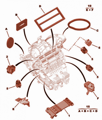

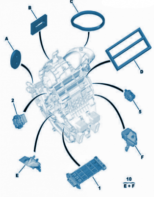

What exactly is the problem? Is it the fan blower motor that is not working? Don't get the air heating resistance unit mixed up with the blower control module, they are 2 separate devices.
What's your VIN number. I'll see what I have.
In the diagram above item [2] is the Blower Control Module - that controls the fan speed.
Item [1] Is the Air Heating Resistance and provides supplementary heating to the passenger cabin when requested and when the temperature / engine is cold.

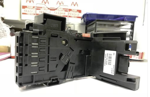

Number [1] is the heating resistance - I explained in my previous post - it is basically just heating elements to provide some warmth for the cabin until the engine warms up. It has nothing to do with the blower motor itself.
Where did you get the Blower Control Module from? Some cheap ones off the bay are notoriously poor quality and dead on arrival in many cases.
Compare with an original replacement - the correct part number for this module should be:
Part Number: 6441AF and is £127.69 inc. VAT from Citroen.
However, before replacing that again....

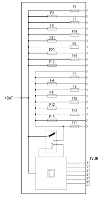

It may also be worth checking the fuse - it is in the Power Supply Protection and Management Box (BPGA) in the engine bay probably near the battery somewhere - but not the engine fuse box - that is the PSF1.
It is Fuse number 10, is 40 Amp and controls the Air Conditioning Blower and nothing else - so if this is at fault you won't get didly from the motor. As you know the motor is working via a bypass - this is your next likely culprit I suspect. Change the fuse anyway as a visual isn't really any good.
This is the Fuse Layout of the BPGA unit This is what it should look similar to:

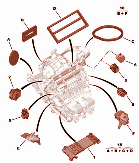

Hi John, you have a different system to the previous DS4 poster (Ammental).
Your setup is below:
Although the Blower Control Module (2) is the same - these will often default to all or nothing speeds when the resistor is shot. The giveaway is of the fan only works on full speed or nothing.
I have the following information concerning this system - so can you confirm if the temperature display in digits is stuck at the same setting regardless of increase or decrease?
At initialisation, if a permanent failure of a button has been recorded, the associated button is in down-grade mode and the confirmation time has lapsed, then provided the fault is still permanent, the button remains in down-grade mode - if not, it becomes operational again.
Function: "Driver’s side temperature"
In down-grade mode, the temperature reference value is fixed (and displayed) at the centred reference value.
A press on + or - for the blower has no effect.
Function: "Front passenger’s side temperature"
In down-grade mode, the temperature reference value is fixed (and displayed) at the driver’s reference value.
Function: "Blower"
In down-grade mode, the "blower" function is provided in automatic mode.
So check if the buttons are ok and not stuck (and that nobody has spilled their coffee). If after turning off the ignition and waiting some time, restarting and the situation is the same, then it has gone into a backup mode by sounds of it.
A diagnostic check with Diagbox may further help identify the problem
