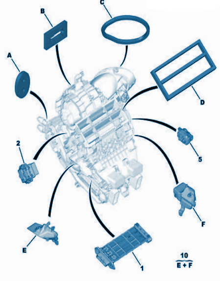

What exactly is the problem? Is it the fan blower motor that is not working? Don't get the air heating resistance unit mixed up with the blower control module, they are 2 separate devices.
What's your VIN number. I'll see what I have.
In the diagram above item [2] is the Blower Control Module - that controls the fan speed.
Item [1] Is the Air Heating Resistance and provides supplementary heating to the passenger cabin when requested and when the temperature / engine is cold.

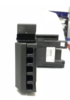

Number [1] is the heating resistance - I explained in my previous post - it is basically just heating elements to provide some warmth for the cabin until the engine warms up. It has nothing to do with the blower motor itself.
Where did you get the Blower Control Module from? Some cheap ones off the bay are notoriously poor quality and dead on arrival in many cases.
Compare with an original replacement - the correct part number for this module should be:
Part Number: 6441AF and is £127.69 inc. VAT from Citroen.
However, before replacing that again....
