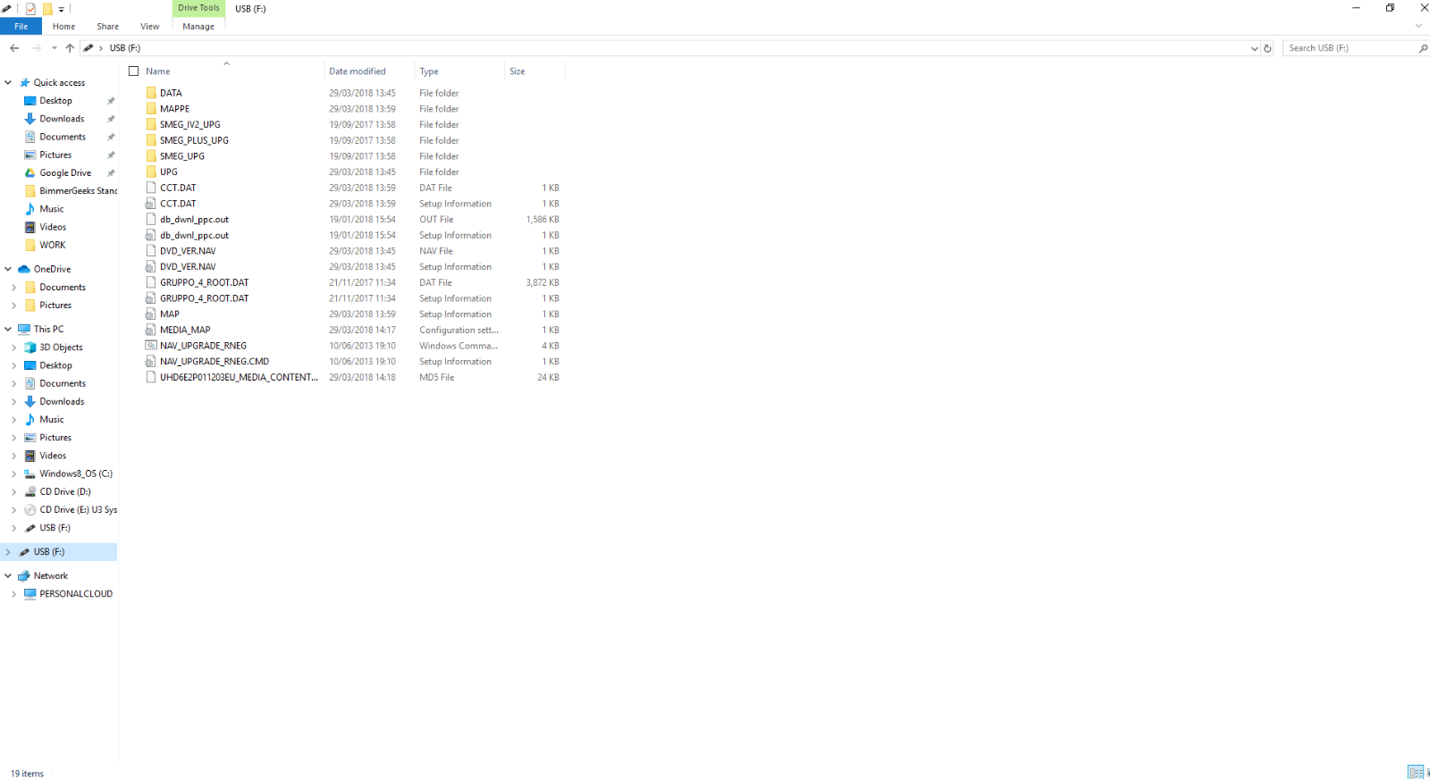

cathalbosco
- Posts: 5
- Joined: 11 Aug 2019, 22:55
Re: DS5 intermittent working satnav/radio
I loaded the screenshot, hope you can point out where I'm going wrong. Also forgot to mention that it looks like somehow coffee has worked its way in so might be part of the issue.GiveMeABreak wrote: 11 Aug 2019, 23:08 Hi

- x 6962
Ok, so from that screenshot, you have mapping files on the USB!cathalbosco wrote: 11 Aug 2019, 23:23I loaded the screenshot, hope you can point out where I'm going wrong. Also forgot to mention that it looks like somehow coffee has worked its way in so might be part of the issue.GiveMeABreak wrote: 11 Aug 2019, 23:08 Hi
Make sure the USB is formatted as FAT32 and if you can post a screenshot of the files contained on the USB. Just use the full post editor, then you can press the attachments button at the bottom of the window and upload / place your files in your post.
Thanks In Advance
Cathal
That's not the firmware and it won't boot without a firmware USB in the socket. Do you know what firmware you had before you replaced the MicroSD card? I'm hoping you had a version lower than 2.86, because as you can see from this thread, there will be calibration issues and some options missing when using this version.
You need to get another USB, because you will have to load the map files back onto the system once it has been successfully rebooted, so don't overwrite the content of the USB you have uploaded in the screenshot. Get another USB and format it as FAT32. Let me know what firmware you think you had - normally you would have all that info and the correct firmware before attempting the repair, because now you can't access the menu to see what version you had unless you can remember.
If you can't remember, we'll have to try an earlier version and see if that works to at least get the system booted up.
