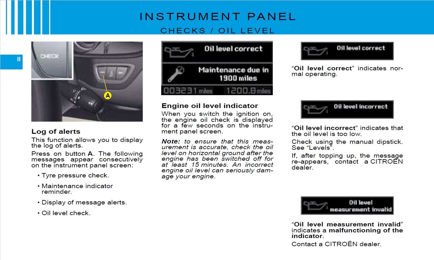

It could be just about anything, unfortunately. If it was the particle filter (FAP) or diesel additive low then there would be a message up in the display as well. You might get away with using a cheap OBD reader to obtain the fault codes, but realistically you'd need to either get it on a Lexia / Diagbox or similar PSA capable reader - of which there are a few available..... I think Gibbo's got one :)
If you were due an oil change or the 'service due' indicator hadn't been reset last time it had an oil change then there would be a message on the screen when you turn on the ignition.
