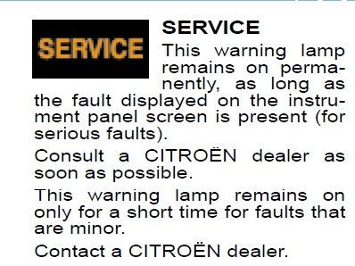

Do you mean it's actually showing the word 'Service' in the top half of the speedo display ? If so -

Yes in the top half of the instrument panel.

It could be just about anything, unfortunately. If it was the particle filter (FAP) or diesel additive low then there would be a message up in the display as well. You might get away with using a cheap OBD reader to obtain the fault codes, but realistically you'd need to either get it on a Lexia / Diagbox or similar PSA capable reader - of which there are a few available..... I think Gibbo's got one
If you were due an oil change or the 'service due' indicator hadn't been reset last time it had an oil change then there would be a message on the screen when you turn on the ignition.
