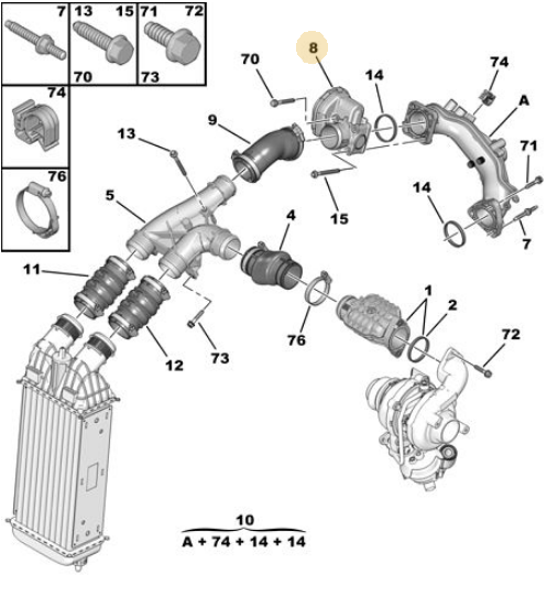

Re: Partner 2015 'Air mixer' P2173 and p1499 AND TPMS gone down the pan!
Ok, so here you go and yes the Air Mixer is the same as the Air Doser - number (8) in the diagram, also referred to in the fault tables as Air Metering Valve.
Thank you muchly!
In essence, if number 8 is all ok and operational its down to the wiring loom or connectors!
Hi was the issue down to number 8 in the picture air mixer?
I have the same fault code's on my DS3.
