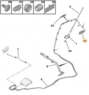

The MyWay unit has 3 Fakra type connectors from the rear of the unit:
Blue: GPS
Grey: FM2
White: FM1
These are routed through a large cable bundle to the rear of the car. From there they go into an adapter (item 10) on the diagram. The FM aerials are split out from here as on the Tourer (estate), the FM aerials are integrated into the rear quarter panel windows. The GPS cable is the one that goes to the roof mounted aerial.
It might be worth you ahving a read here of another member that had the same issue - he ended up needing a new Head Unit as I suggested to you if the other tests fail. It also conmtains a link in the post to one of those cheaper GPS modules you can use to test it.
So yes, there is one GPS cable to the roof antenna.
