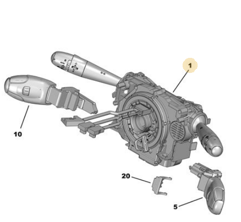

Ok, so the switching block remote control is part number: 96773906ZD - item (1) below:
The unit only comes with the lighting and indicator stalks - you unclip and slide out the Cruise Control and Audio stalks and put these int he new replacement unit.
You need to be very careful with the airbag (always perform the battery disconnection / reconnection procedure and wait 10-15 minutes after:
Battery Disconnect / Reconnect Procedure
Also be very careful with the clockspring and the steering wheel angle sensor that the ESP ECU relies on - if this goes out of kilter it will throw up ESP / ABS errors and will need to be recalibrated using a diagnostic tool like Duagbox.

Re: Minor lighting major headache
Thank you very much. I'll order a new one and have a go myself.
I've found a couple of YouTube vids on the subject, the best one being a French one.
The clock spring on the videos didn't seem to leap out of control as soon as the unit was removed, so if I take my time it should be ok? Or does the clock spring come with the new unit?
The airbag is a bit of a worry, but on one British video, the host had the power turned on by the ignition key, as he removed the airbag and only switched it off just before he removed the power feed cable. DIY nightmare in the making.
I'll follow every step methodically .

Ok, so the part number I gave you was the replacement part (updated), but the original part number was 6242NA. Try searching on these part numbers only using the browser, don’t try a supplier directly.
This will provide the widest possible range of results.
As for the Airbags, it is prudent to allow 10 to 15 minutes to all of the Airbag ECU to dissipate the capacitive charge to be in the safe side.
As for the Comms unit, no, the steering wheel angle sensor is not included, so it is very important that the position is marked and noted before removal. Ditto for the clockspring. There should be an arrow on there to mark position.
