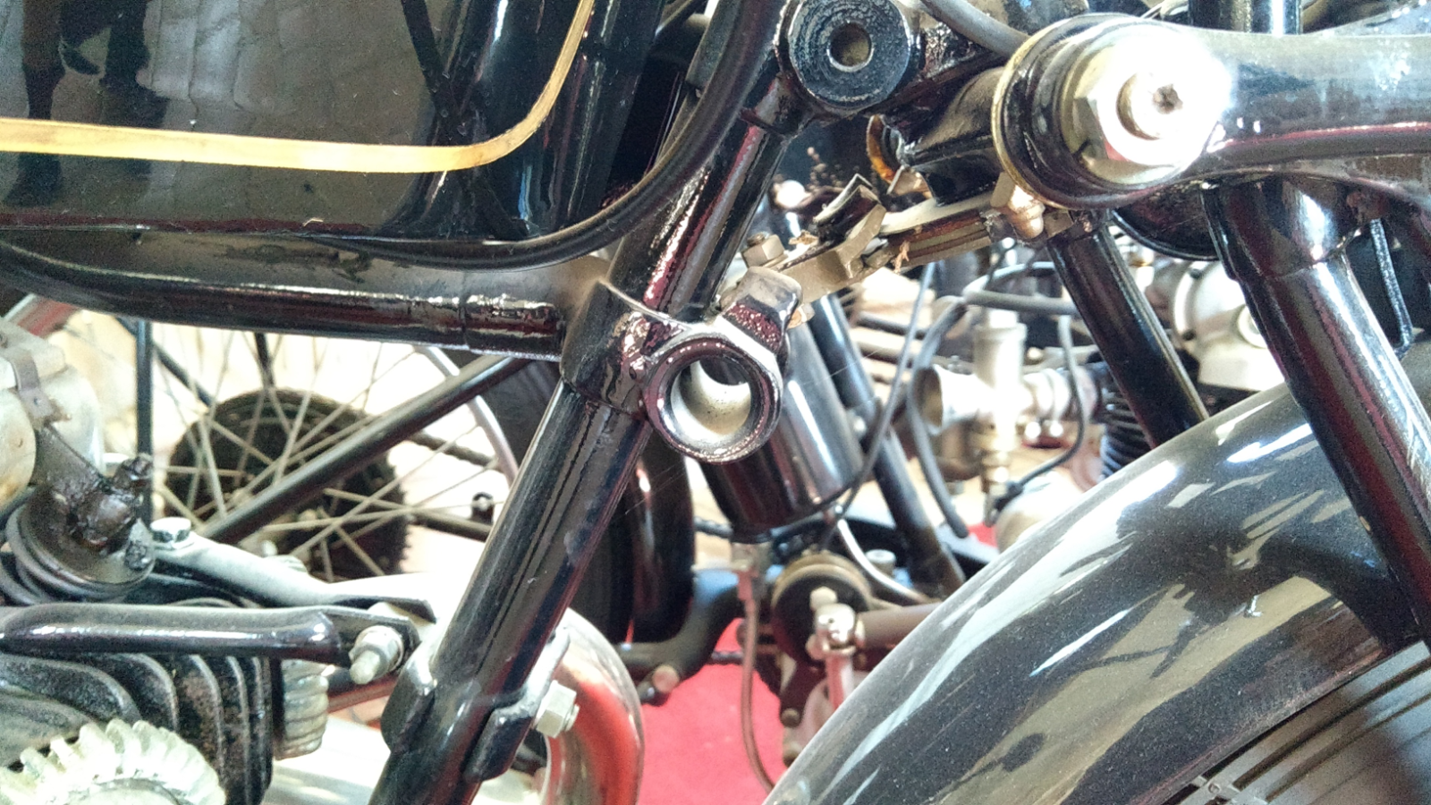

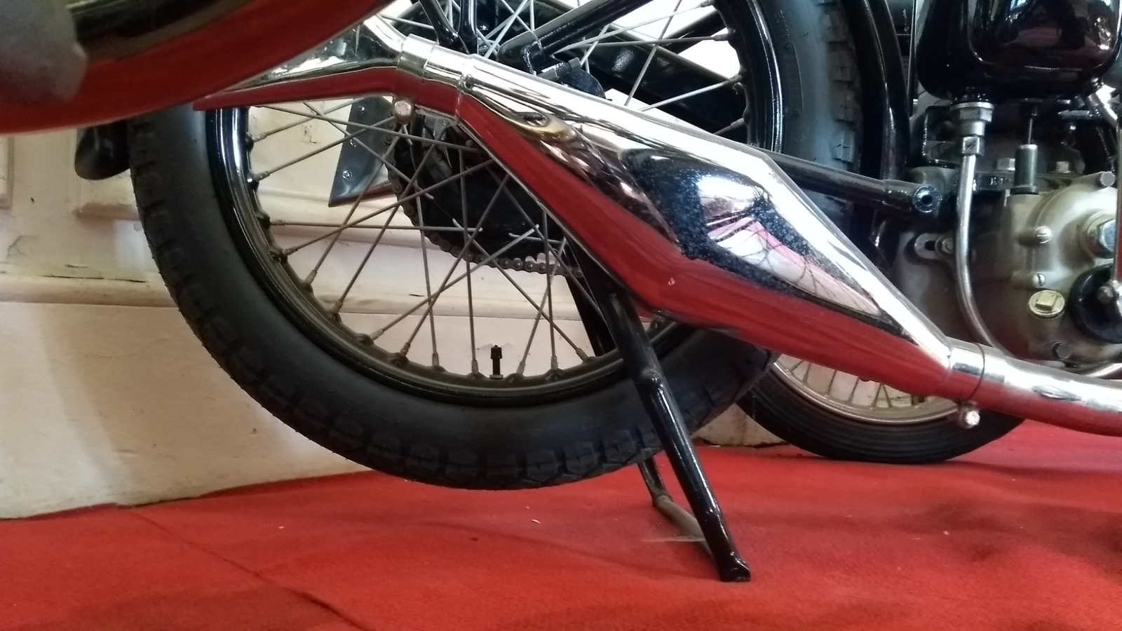

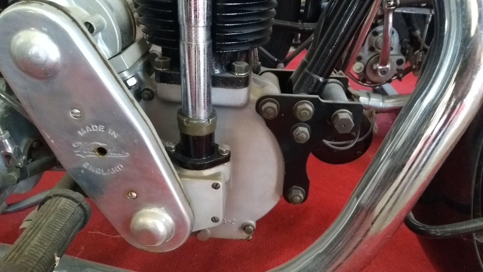

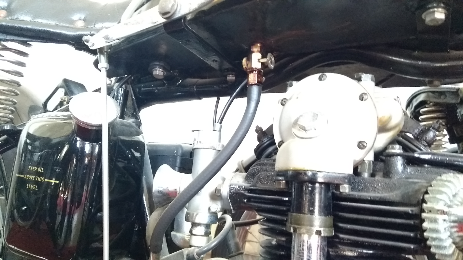

As promised a while back, some pictures of a 1929 Velocette... Sadly not a model U, but I think that you may find some useful details anyway.
Forum Treasurer
Posts: 12455
Joined: 07 Aug 2002, 17:12
x 1439
Re: RichardW's Velocette rebuild
Unread post by RichardW »
Thanks,Mike - that's a 350cc 4 stroke, but many bits are similar. Odd that the gear change gate has only got 2 slots in it, perhaps that is a 2 speed box, whereas mine is 3.

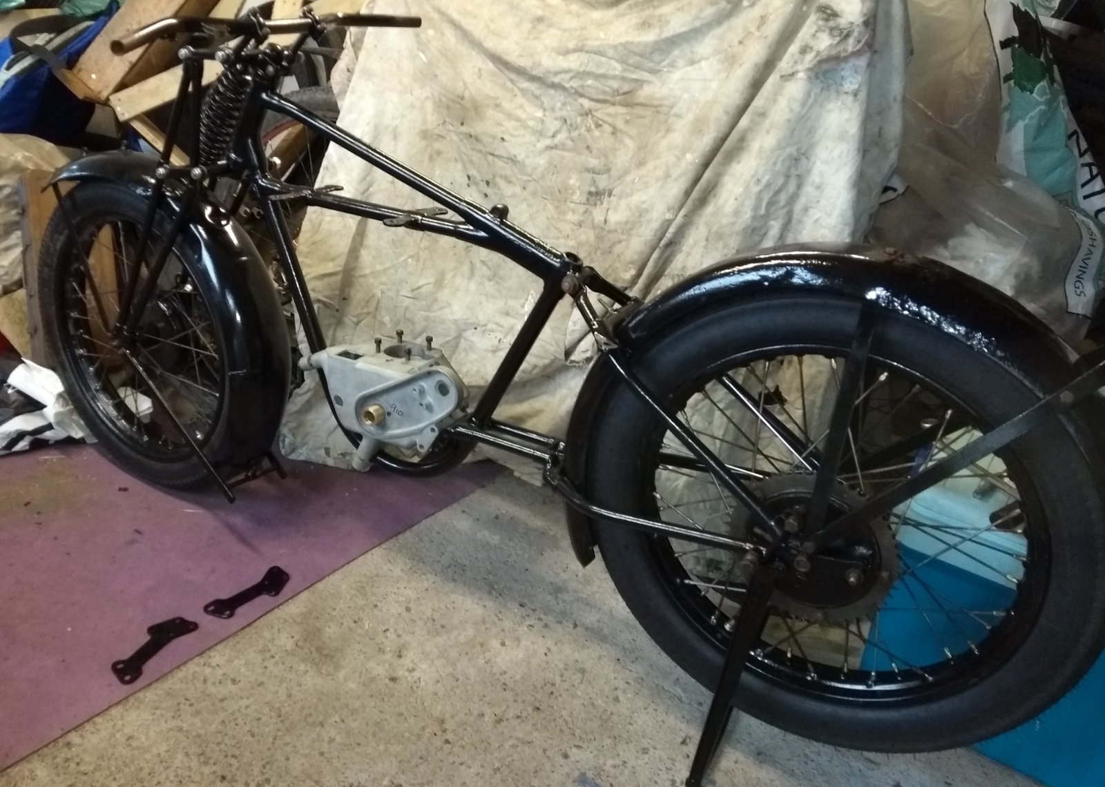

Some progress has been made...
I've got the mudguards, stays, and number plates painted, and started on the engine rear mount plates
This means I can put those on, and the wheels, and we will have a rolling chassis :-D

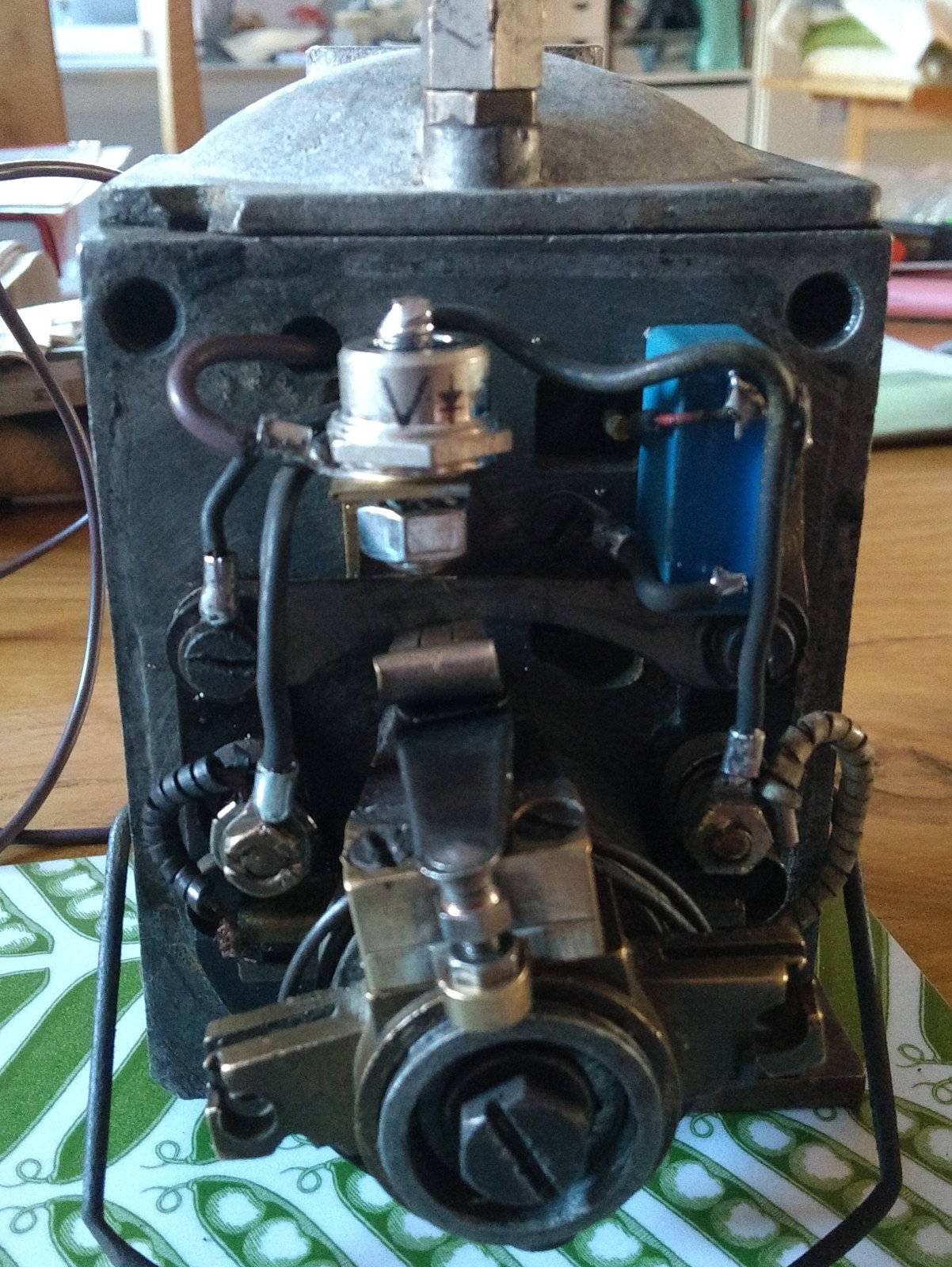

I've also got the Magneto back this week!
Doesn't look much different outside, but inside the cover there are some modern bits (condenser and cut out - this stops the battery discharging itself via the coil when the engine is not running - originally it was a mechanical cut out on the armature, but these were unreliable - and the mag repairer reported that it was already bypassed (unsurprisingly!).
Something odd in the advance mech... the mag rotates clockwise when viewed from this, the non drive end, so this is full advance, being pushed by a spring. However, the hole in the end cover for an advance / retard cable is on the other side - i.e. it would need to push the points plate down, which isn't going to work! The cam plate does appear to be able to work with a spring in either direction, but it would need a different spring and end cover. Perhaps this is not the original end cover and Grandad has fitted a different spring to give full advance all the time - he was certainly running it without a mag lever when it came off the road, as it is not in evidence! So I think I will just try without to start with.

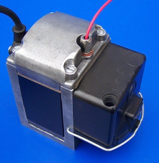

Found some info on the Maglita advance. You can see on the top RH (as you look at it) there is a bulge in the casing where a cable ought to go. However, the other side is solid and could be drilled to accept a cable. In this photo (from the Magento Guys)
You can clearly see the top left has been drilled / tapped to accept a cable. So it looks like it is possible. I suspect that the only problem with not having one is a possibility that it will be hard(er) to start and / or prone to backfiring when kicked over (I wonder if it will run backwards... quite possibly!!)

The magneto (probably) won't spark if turned backwards, so the motor won't run that way.
It is my understanding that variable advance is much more important on a 4-stroke than a 2-stroke engine, so maybe it was never actually used on this machine?.

You're right, Mike - a bit of searching suggests advance not that important on 2-stroke. All the other ones I have seen have an advance cable, but this has certainly run without.
