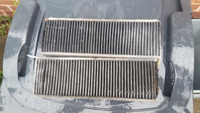

Yea I changed both of them. Looks like they hadn't been changed since the car was made lol. I had a look to see where abouts there intake is but couldn't see it? That could be blocked? I'm guessing there's some kind of mesh covering them that could be blocked

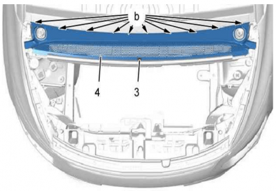

The scuttle is just below the wiper arms:- (which have to be removed to get the scuttle off - and I suspect a bit difficult to see what is underneath without removing it..

Great will take a look when it stops raining I have put a pic of the pollen filters on
