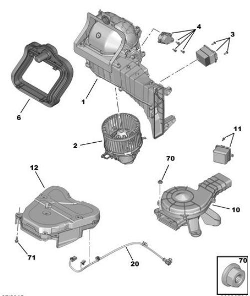

Ok, so you have the Automatic Air Conditioning System with SMEG control (Touchscreen controls).
Looking at the parts diagram the blower control module is item 3 on the diagram.
This is part number: 9821291880. It costs £141.28 from Citroen inc. VAT
A DENSO one here for £57
https://www.euspares.co.uk/search-autop ... 9821291880
I am not personally familiar with this system and failures seem few and far between. If you asjust the fan from the lowest setting and gradually crank it up a segment at a time, does the motor speed and output also increase? If id does increase through each segment on the display, then I doubt it is this control unit. Before testing, ensure all the front fascia vents are open and change the air direction to front vents only, for easier testing. You should be able to tell if it is then working through all speeds.
On some models there is an additional air puller unit (probably on the Exclusive) for the rear passengers (item 10 on the diagram) to increase the airflow, but I know from your VIN that you don't have this unit.

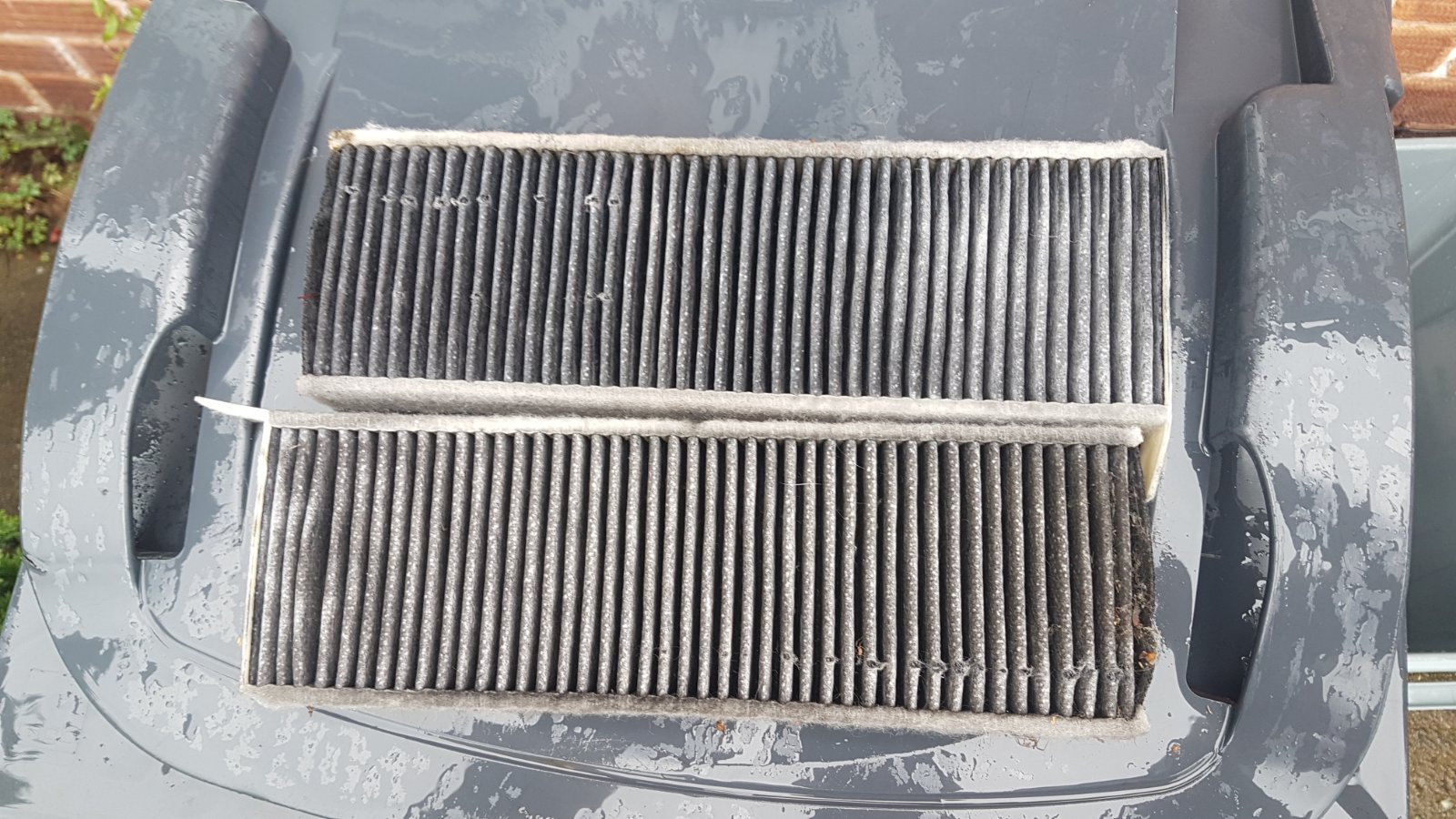

Did you change both of them as there are 2 on this vehicle?jammie123321 wrote: 26 Jul 2019, 20:01 Hi wonder if anybody can help me out I've got a c4 Picasso 2014 model and the fan/blower speed is very slow even tho is on full in the controls. I changed the pollen filters the other day and it's not made any difference. Is there a resistor or something else that could have gone? The fan does work just very low output from it

Also check that there are no leaves, and other mulch in any of the outside air grilles that could be restricting air flow.

Yea I changed both of them. Looks like they hadn't been changed since the car was made lol. I had a look to see where abouts there intake is but couldn't see it? That could be blocked? I'm guessing there's some kind of mesh covering them that could be blocked

Great will take a look when it stops raining I have put a pic of the pollen filters on
