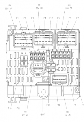

Thank you so much for this. I had traced two wires in a separate loom from the engine BSI. Each wire is connected to a 30amp large fuse. When ignition is on red wire has 12+volts and blue wire has 0.65 volts. Has anyone any knowledge of this?

Re: solenoid supply valve ABS
The BSI is in the passenger Glovebox and that really only has the CAN data network from the ABS ECU and the brake lamps control.
The Engine Fusebox is called the PSF1:
The Fuse F7 is a 10 Amp and is for the anti-lock brake control unit and electric power steering ECU.
Clik images to zoom. The Maxi fuses:
These are probably the ones you are referring to:
MF2: is 30 Amp and is the ABS hydraulic pump supply - *ESP hydraulic pump supply
MF3: is 30 Amp and is the ABS electrovalve supply - *ESP electrovalve supply
(* ignore the ESP part as you don't have that)

Thanks again. Yes that seems to be what the wires are. It seems a huge fuse if it only carries 0.65 volts. Thank you for taking the time.

Yes, but remember the electro valves in the hydraulic block are not operating all the time. It will only draw more current when the ABS is activated and braking / releasing the brakes in a road holding issue.

I replaced the large relay that is attached to the inner wheel arch. I then had full voltage on the blue wire. Drove the car 50 metres and the light went out. Seems to be ok so it must have been the relay. Thanks again for sending diagramas knowing what the blue wire was made all the difference.
