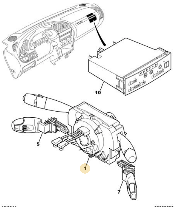

Possibly your comms unit has / is failing. They can also affect headlights, indicators and the like when they go on the blink.
I have your VIN so I'll check out the parts for you....
Ok, so assuming you have front fog lights as there are 2 options of units for your car. I think you do have front fogs - but do let me know as the VIN does not state (age).
The Comms unit is part number: 96787362XT
The audio stalk itself is 6242Z6
Here's a link to a supplier - they sell both new units and refurbished ones, £160 and £90 respectively.
https://peugeotpartsforsale.com/index.p ... egory_id=0
You don't have a steering wheel angle sensor to worry about as you have no ESP system. But be wary of Airbags - always disconnect the battery and wait 15 minutes for capacitor to discharge before doing any work on the steering wheel.
Procedure here:
Battery Disconnect / Reconnect Procedure
The fault in the audio stalk may be related to the comms unit. With the comms unit you generally retain the additional cruise control (where fitted) and audio stalks to fit into the replacement comms unit - they just clip in. So I wouldn't go ordering an audio stalk at this point until you are happy that it is the comms unit.
Unfortunately, a diagnostic rarely brings up faults with the comms unit as the issues are intermittent. But most common stalk issues, including wiping and lights are comms unit related.
