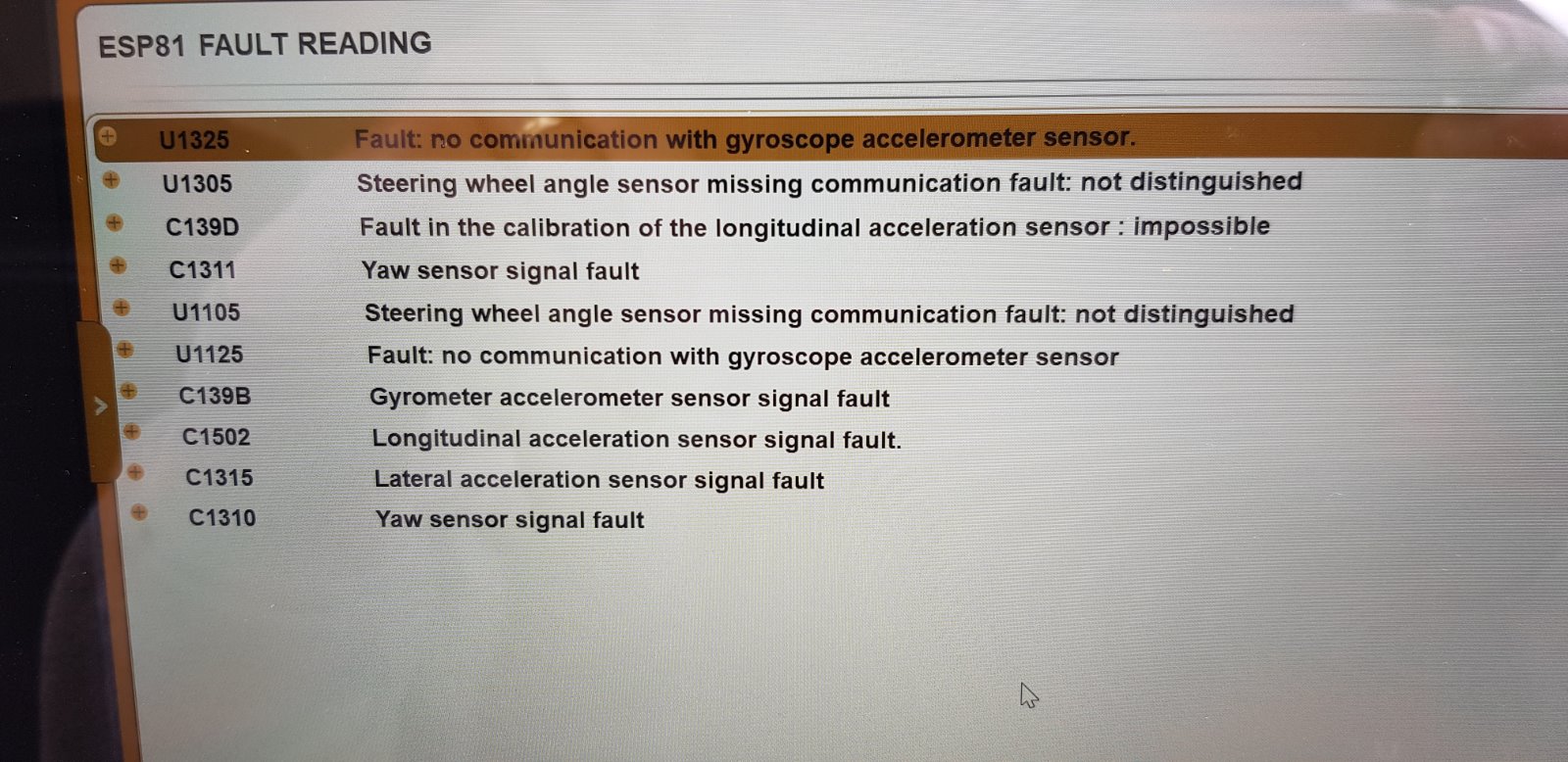

ok ive been trying to track down a issue with my gyrometer as Lexia says it cant communicate with , ive checked for 12v and it does have power, it then brings up loads of other fault codes, so ive tried to find the issue myself including changing the gyrometer and it has made no difference ive also had it to a few garages and non can find the issue , so im at the stage of looking at scrapping the car as it cant be mot with the ESP light on , ok im thinking maybe the fusebox under the bonnet could be worth changing , it has around 10 fault codes and most garages tell me it has to be either a wiring issue or water some were , I don't know what to do anymore , there is no way of checking the fusebox as you cant get into them to see the circuit board but they are known to fail.. the car drives perfect
ive checked every fuse including all the ones in the BSI .. im proper strugging as it seems no one at all can fix the issue.. Citroen want nearly £90 an hour to look at it and themselfs have said its going to be hard to track it down// my only other thing was to take the engine out to sell on ebay as its a 2.2 psa 170bhp engine and try and sell the car inbits

What are ALL the fault codes?

Bobins , ive firstly bought the new brake switch and new updated wiring harness but this has made no difference , so all the fault codes are on the ESP81 , The very first thing it puts on the dash is parking brake failure …. but there are no faults on the FSE from Lexia, this in turn then turns off loads of other things and then puts those fault codes up , so my main one being no communication with the gyrometer, ive tried 4 second hand units all the correct ones and none work there is power to the gyrometer it says it cant communicate with the gyrometer so is this a canbus issue or possible fusebox failure, if so is there any way of checking the canbus, Lexia says that the ECU at the top of the steering wheel has no issues , so I need to track down why it cant communicate with the gyrometer, possible , fuse box under the bonnet, or canbus unit failure, or BSI unit needs replacing .. Please any help

In light of the other fault codes:-
At the top (7804) is the ESP Accelerometer Gyroscope
7112B is the Angle sensor + 12 V power supply
M7804 is the Earth
9000V is the High Intersystem / Can bus
9001V is the Low Intersystem / Can bus
Observations: The 7112B power wire goes from the Accelerometer Gyroscope down to:
7130 The Multiplexed Steering Angle Sensor. So both the Gyro sensor and the steering wheel angle sensor are powered from the same feed - and of course both show faults....
The High & Low CAN wires from the Gyro go to the ESP ECU (7800), but it looks like they intersect before they enter the ESP ECU. The intersection shows the CAN wires going back to the BSI. On the Steering wheel angle sensor, you can also see the pair of CAN wires heading back to the BSI.
So here to compliment the above is the wiring diagram showing the actual connections:

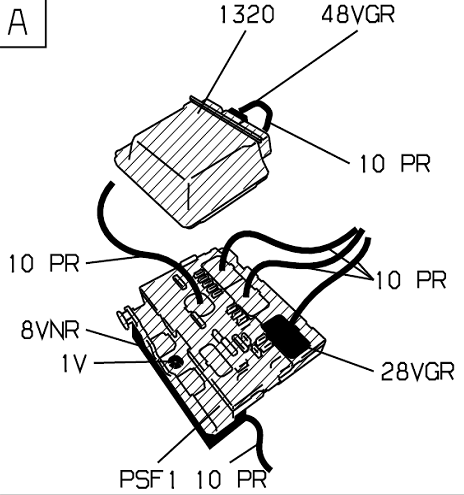

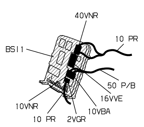

Here are is the location of harness 10PR for the relevant ECUs:

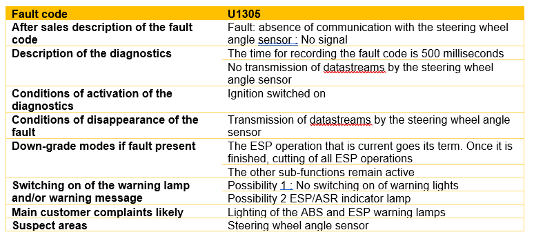

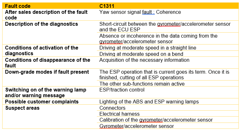

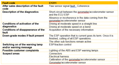

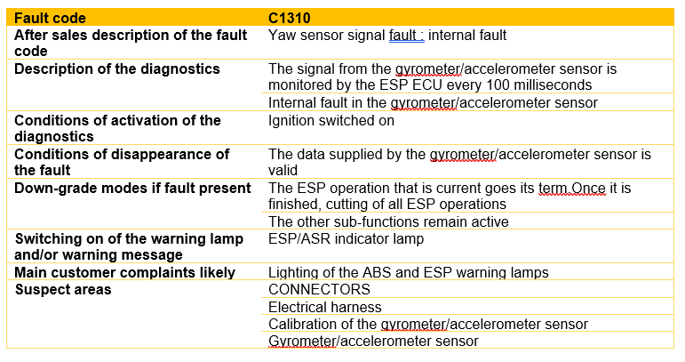

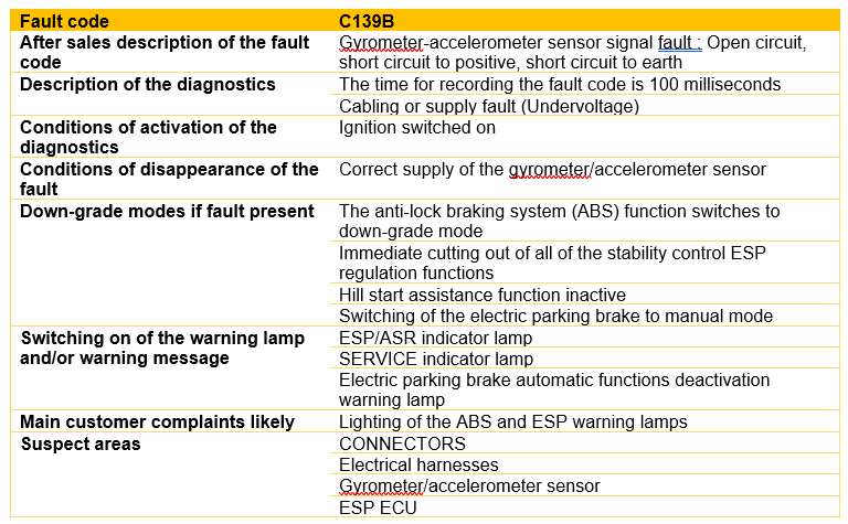

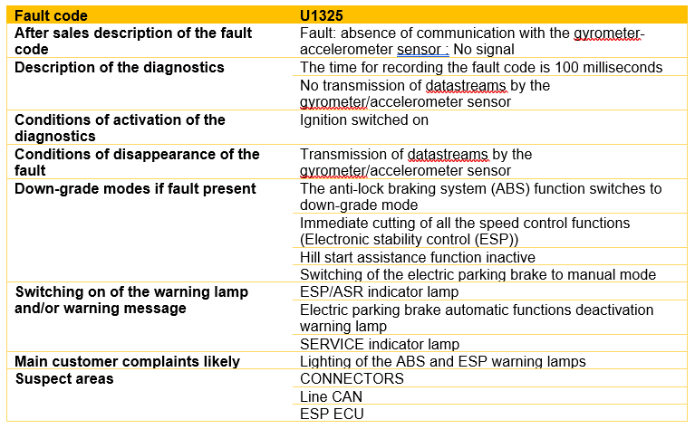

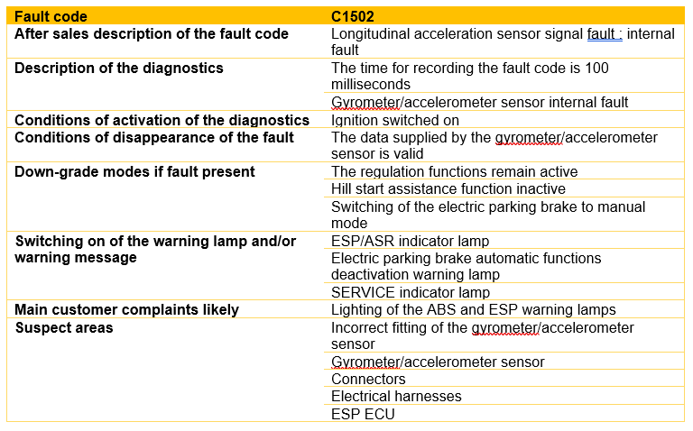

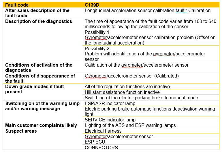

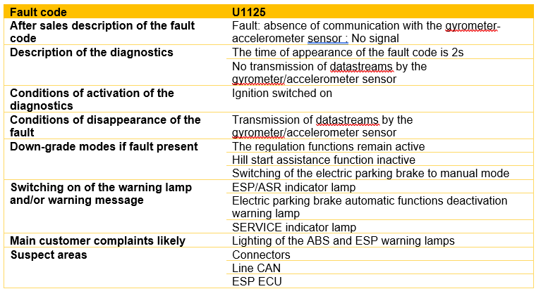

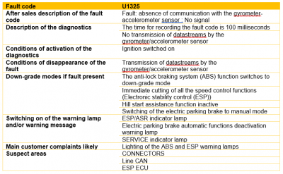

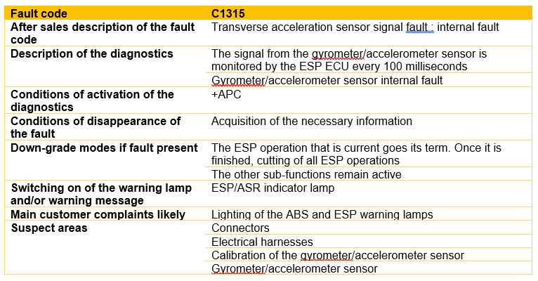

Finally, here are the fault descriptors for all these fault codes - we should bear in mind that one fault is likely to be triggered by another on the same system. I'm reluctant to draw any conclusions, but look at the suspect areas at the bottom of each table for indications - again bearing in mind that signal / communications data from one or more areas can have a cascade effect on the other faults.
Click these images to zoom
M7804 is the Earth
| 10PR BSI | 10PR Gyro Sensors | 10PR Engine Fusebox |

many thanks Marc , some fantastic information, just re looking at Lexia just now and looked into dynamic information look at this, so it shows the steering wheel angle sensor as faulty.. ive just looked into all dynamic info on the FSE and everything is good, this could be misleading as no communication with the gyrometer means it cant be calibrated up so will show faulty? interesting it says at the bottom it says no fault detected by the ESP

If it is reporting the SWAS as faulty then that alone will throw an ESP / ABS Faulty issue on the dash and disable the ESP functions.
There is a routine in there to calibrate it - it should be self guided, so give it a go.
