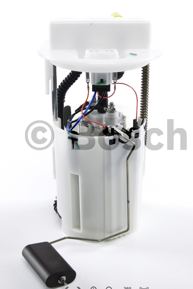

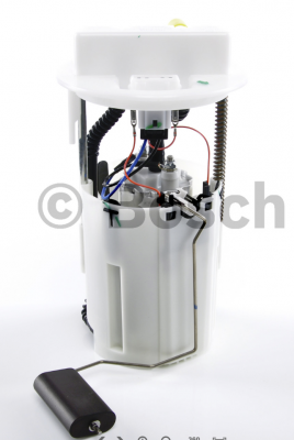

So to confirm you have an in tank pump and gauge unit.
Here's a close up - made by Bosch. About £100 new from the link below Part number: 1607401780. Citroen charge £388 inc. VAT for this part.
https://www.ebay.co.uk/itm/Fuel-Pump-In ... 2414308036

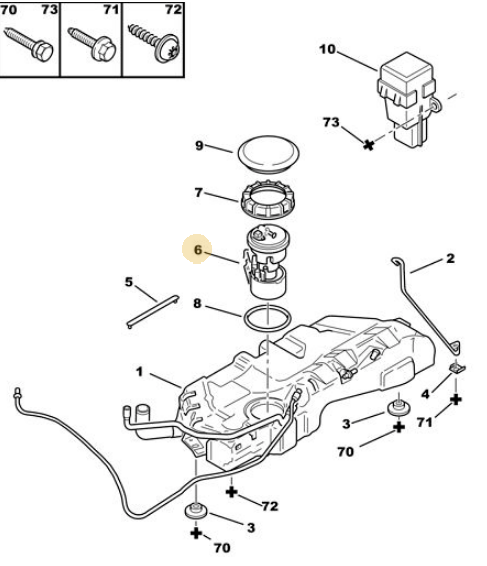

GiveMeABreak wrote: 04 Jul 2019, 13:55 Ok, so sorry for the delay - BT have cut the fibre links in the village - so been offline for a day or so...![]()
Thanks for the information, very helpful. I'll check the part number to cpnform.
Do you think the cheaper fuel pumps will be ok? I know Bosch are probably the best, but I want to avoid spending £100 on the pump alone as the car needs a few other things doing
- x 6956
Re: Fuel gauge dies/drops to nothing Xantia hdi
At the end of the day you get what you pay for - the Bosch one is a lot cheaper than the Citroen one and is of course Bosch quality. I wouldn't fit cheap parts on my car as a rule as it'a a false economy, but that;s a decision for you and available budget.
