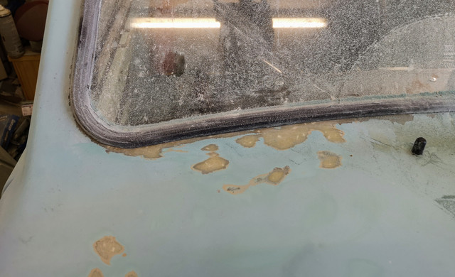

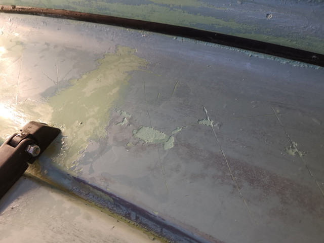

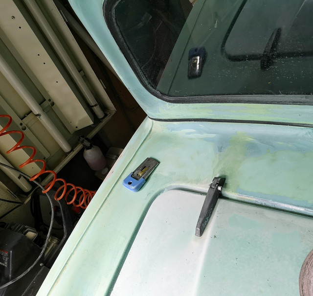

Decided to investigate whether the old cling film over paint stripper trick could help us shift any of the stubborn paint on the Invacar.
While not entirely successful, it was a worth?y experiment. Using the cling film didn???'t seem to make a huge difference. We d?id get a bit more p?aint off the rear moulding though. It's a tricky balance with the scraper... there's about a 3% difference betw?een the pressure needed to shift the paint and needed to dig into the gel coat, which is annoyi?ng?.
Did a little experiment later in the day with leaving???? the? stripper on one of the really stubborn areas for a bit longer. The results were... annoying.
Turns out that if you leave this stuff long enough it will attack the gel c?oat?.
In spite of that?????? though?????? the? paint ain't any more interested in moving than it was before. This is going to come down to a sharp scraper and p?atience it loo?ks like???.??

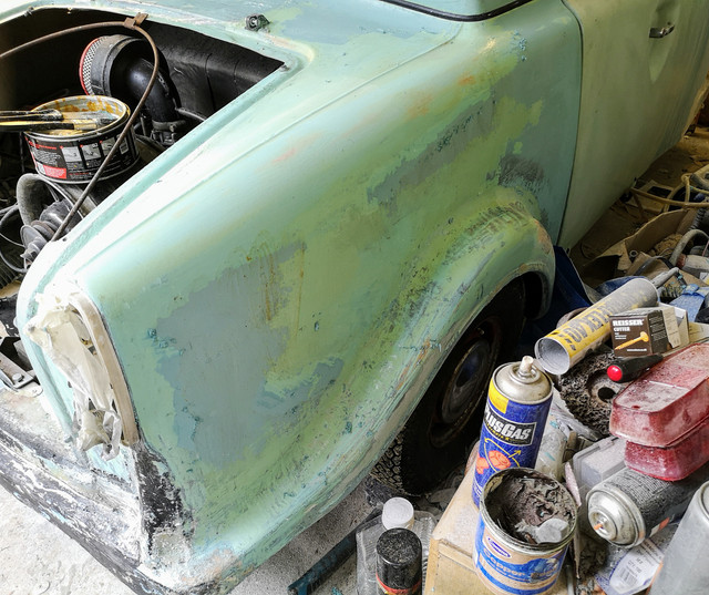

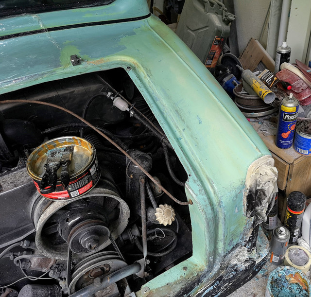

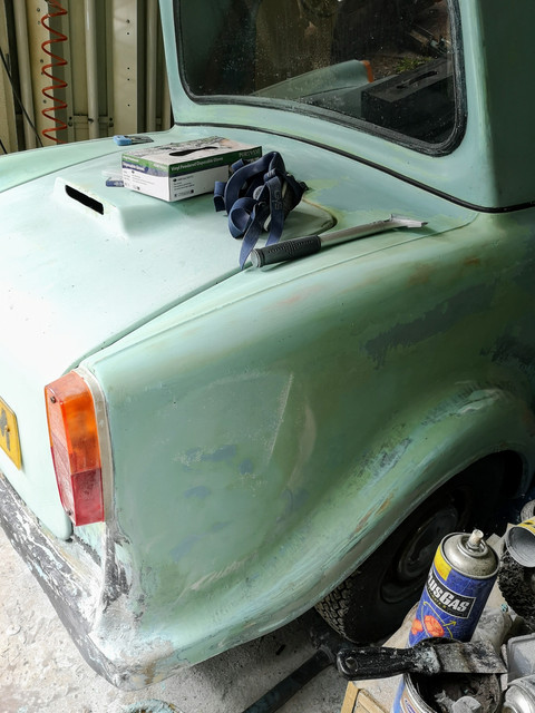

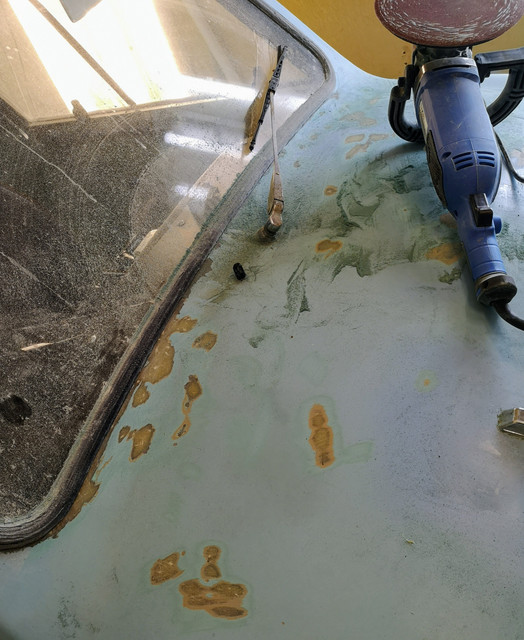

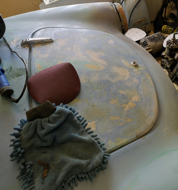

This paint?? removal process I think is just going to be a long slog.
Got a few better scrapers today and they're precisely zero help. With the sharper blades they're just digging in and going straight through the paint and the gel coat, it's just too soft. On a few of the larger flatter panels where there's a nice clean edge to the paint as it's been removed, using the blunt edge it's possible to work away at it...but I was successfully? doing that with my old blunt scraper already.
Heat lifts the gel coat before the paint too, as I did poke it with the heat gun just to eliminate it as a potentially helpful tool. ?
I did bust the sander out again today just to see if I could flat back the area below the rear window where the surface was damaged by the paint stripper. Look?s like there's plenty of thickness to the gel coat to sort that out at least??.
There's quite a bit of pitting on the????? one panel...you can ?clearly see the line where the paint stripper was sitting the longest?.??.?.???
No huge issue, it'????s no?thing a really tiny amount of filler can't ?hide...just annoying to have made more work.
Next stop will be investigating soda blasting. Eithe?r getting the kit to do it myself or getting someone in to d?o it?.?

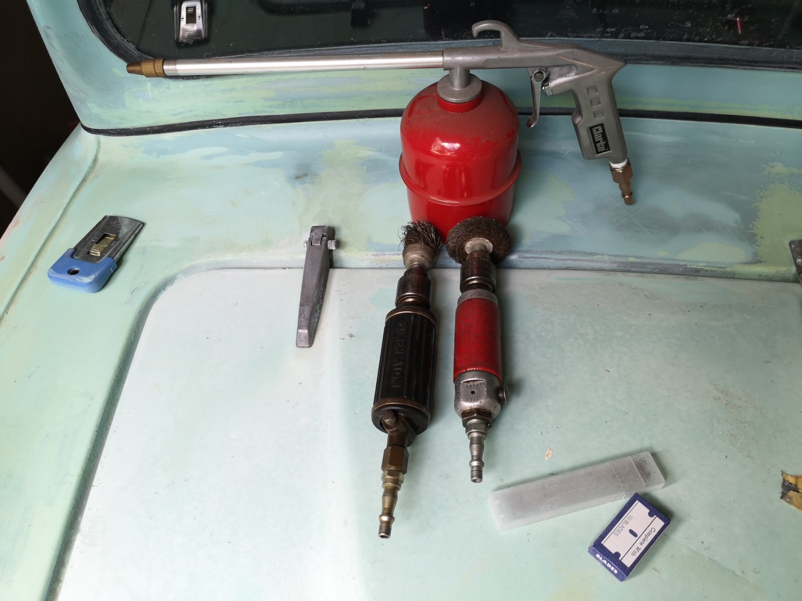

Not honestly? sure how to tell if the gun is a spray gun or soda/sand blaster. Answers on a post card?

Zelandeth wrote: 07 Jul 2019, 17:17
That is what is called a paraffin spray gun - though in all the years I've owned one, I've never needed to liberally douse anything in paraffin :lol:
"Produces a coarse spray for applying paraffin and similar cleaning agents and de-greasers. Use also for applying wood preservatives, insecticides and silicone treatments."

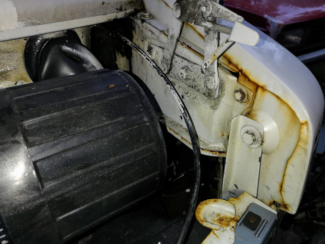

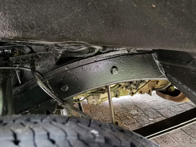

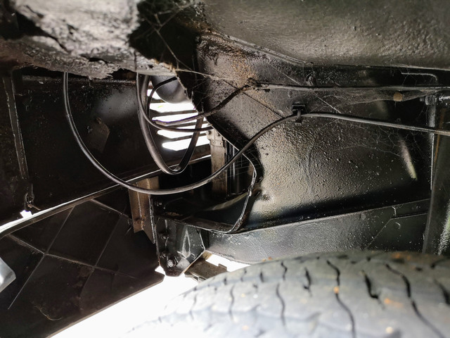

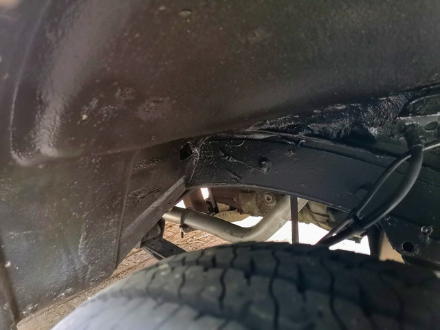

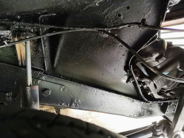

Had a bit of an experiment with the paraffin gun this afternoon. I still had some old underbody wax?????? floating around, so I let it down a bit to a more spray friendly consistency then had a mess around with it.
Can't see me ever messing? around with aerosol cans for this sort of job again. The spray is far finer and just generally well behaved. ?
Didn't do a huge amount, just gave the front wheel ar?c?hes and engine bay a blow over. It's a bit hard to see as it's clear wax that's gone on over the black stuff alread?y there?.???
The top dust cover on the shock absorber has fallen off again. I'll need to get inventive with a cable?????? tie to make it stay in place I think as it's obviously not going to behave??.??
Hopefully this should keep the rust in the bulkhead under the windscreen from getting worse too????? quickly until it can be cut out and replace?d??.??
Worked into all the little gaps under the struts and the cavities thoroughly misted. Bonnet???? really needs replacing in the long term, but hopefully this shoul?d help it remain stable for a bit longer??.?

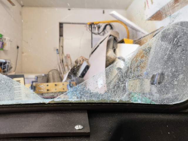

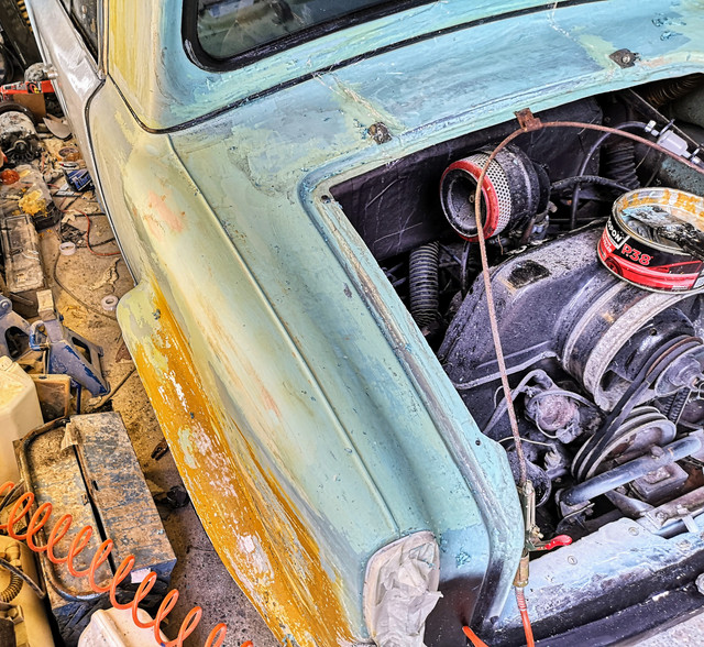

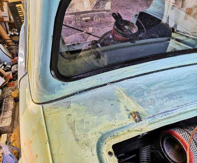

The Invacar has had a little more sanding work. Have been going very gently with the P120 discs on the sander at low speed over the front of the car. Unlike????? the rear this has no coloured gel coat... it's been painted from the factory. It's also far thinner, so I'm aiming to just remove the loose are?as here then I'll see how things look with some high build primer on there??.
While it looks horrible, this is actually???? smooth to the ?touch.?
Bonnet is still a mess, but is far closer????? to flat tha?n it was?!?

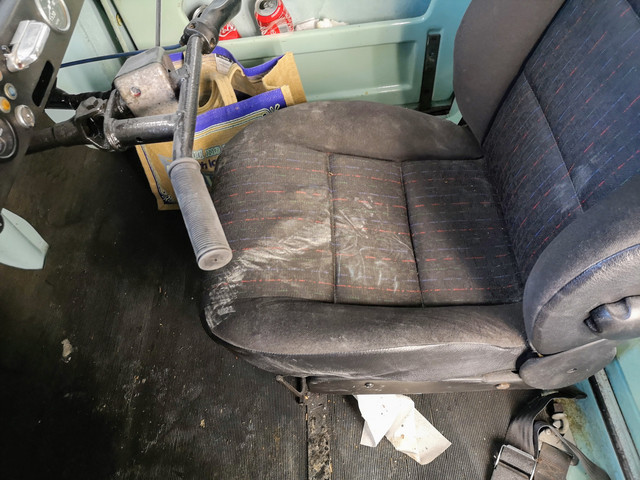

Then forgot to dust myself???? off b?efore sitting in the driver's seat.
Just a bit of dust????? about...

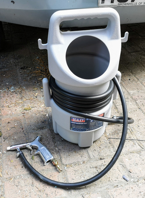

Going to give one of???? those cheap soda blasters a shot for the rear body and roof...if it works i?t works...if not it's no huge loss and I'll just need to perse?v?er?e.?.?.

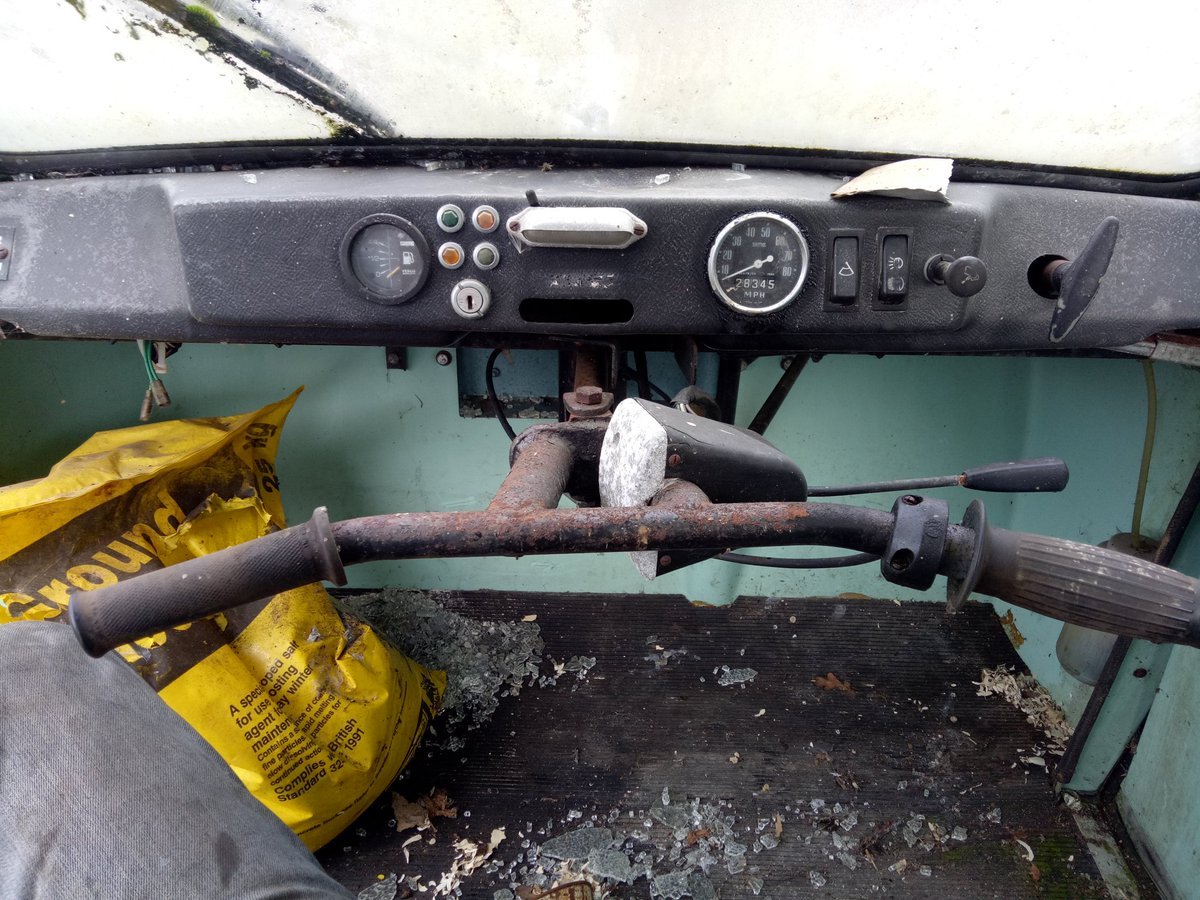

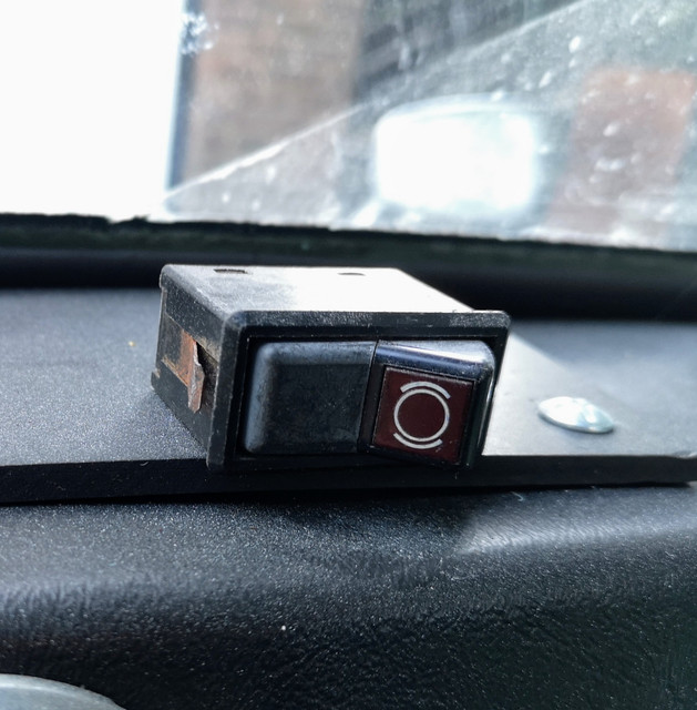

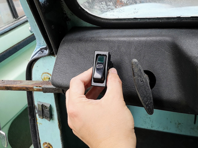

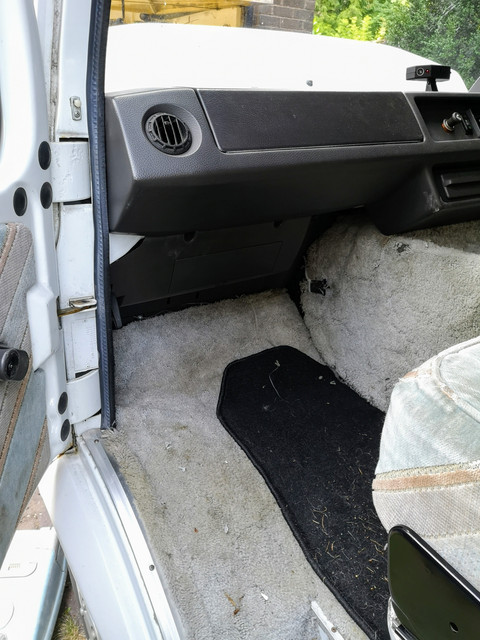

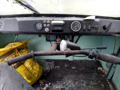

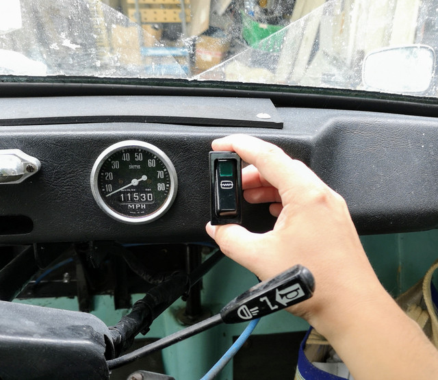

Here's a question for you lot.
Heater and windscreen demister switch will be getting fitted in the not too distant??? future. It's of a type which is visually identical to those already on the dash so should look like it's meant to be there. ?
The question is where to put it.
There are three options as I see it: ??
[] Immediately to the right of the speedomete?r?.??
[] To the far right over by the??? no passenger?s sign???.
[] To the far left, between? the handbrak?e and door.?
I'm currently leaning towards the???? first option...seems most in keeping with the original switchgear.? Should still leave me room to add the brake fluid warning lamp when the hardware for it is fitted.
Any votes for other locations?
May well fit this to my spare dash as I want t?o take the dash out to sort a couple of wiring bodges I've seen under there. Will make it a lot easier though as being off the c??ar will vastly improve acces?s.
Current fleet:
Posts: 6846
x 3566
My vote would be for the first option, but that then raises the issue of whether to put it equidistant from the right hand edge of the speedo and the r/h edge of the flat face of the dash, or whether to offset it one way or the other :chin:
Zelandeth
Posts: 5292
Joined: 16 Nov 2014, 23:36
x 1592
Unread post by Zelandeth »

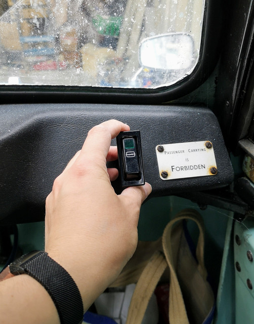

The exact position is pretty easy as there are cars with the switches there rather than over to the left by the fuel gauge...so I'll just use the positions from the "mirrored" dash design to set the position.
Here's a photo from a thread on another forum - I can't link to courtesy of the swear filter, but I'm certain the original poster wouldn't mind my using it for reference...it's a pretty small club owning these things. My car was actually the parts donor used to restore this!
Very early photo from Dollywobbler's resurrection of TWC729K
My heater/demister switch will go where the windscreen wiper switch is in the above photo, and the brake fluid one (when I find the blighter) will go where the headlight switch is.

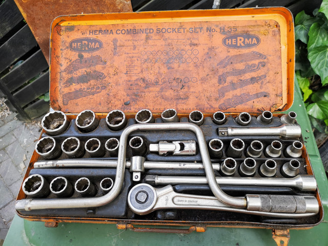

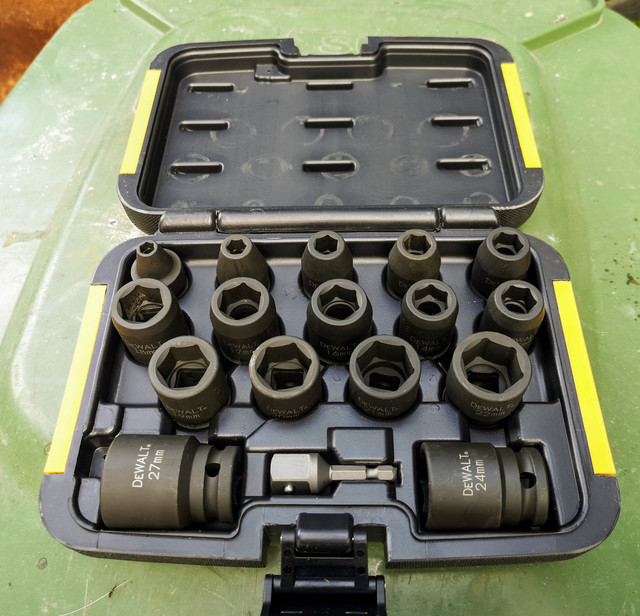

In the interests of saving some weight I figured it was time to start actually shifting some of the crap which has been rattling around in the boxes of stuff I picked up out of the van. Box of tools no 1 contained:
[] Herma Combination Whitworth/AF/Metric socket set. That will be useful with the Invacar given the completely random selection of fasteners it features.

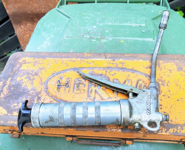

[] Nice little Wanner grease gun. This will no doubt still be going decades after the cheap one already in the garage has turned to dust.
[] Proper set of De-Walt branded impact sockets. Useful given I bought an impact wrench a few weeks ago.

Hopefully will have some soda blasting media arriving in the next day or two so will be able to give it a test run then. Just didn't seem worth not giving this kit a shot at less than £40 delivered. If it works, aside from saving me a lot of grief on the Invacar it will be an all round useful thing to have. Bit like having a compressor...I doubt it's a tool I'll really appreciate until I've got used to having it around.

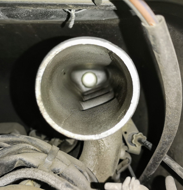

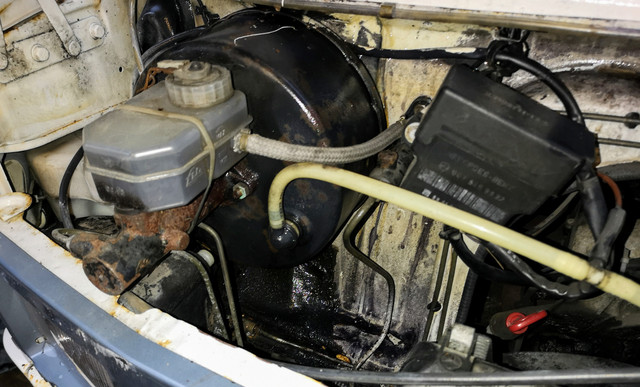

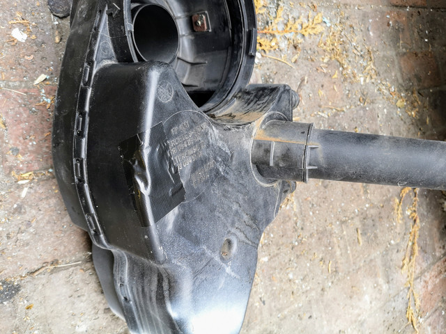

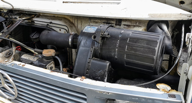

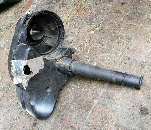

Never got? around to putting an update up yesterday as by the time I was able to actually sit down for long enough it was just too late. ?

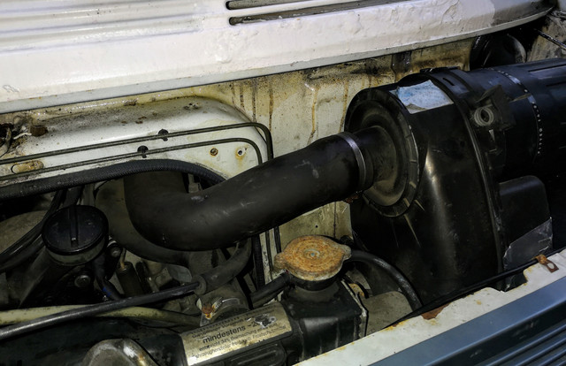

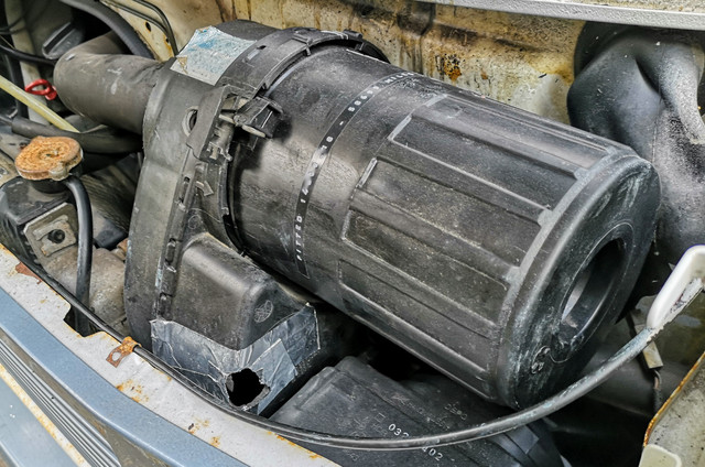

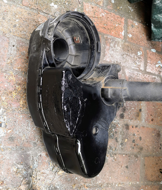

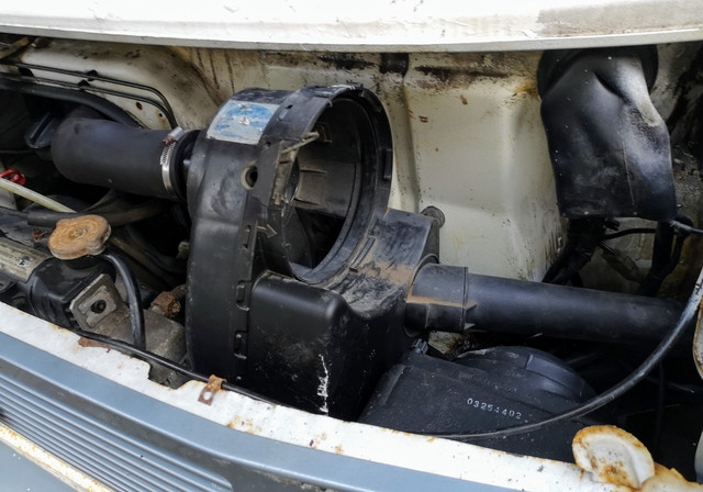

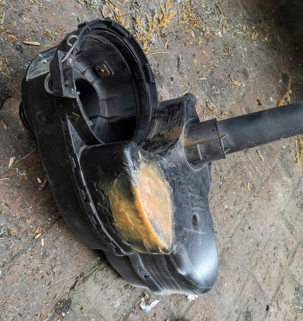

Felt that I had to *make* some time in the late afternoon to have a look into an issue which had become painfully obvious in the van on the way back home yesterday - an absoltely maddeningly intrusive boomy resonance from the engine. This is an issue which it had when I originally picked it up and had been bodged a couple of times so I knew the likely cause was the fact that there's a stinking great hole in th?e ?air cleaner resonator chamber.
Being a normally aspirated diesel, Mercedes have done quite a lot of work to ensure that as much air as possible is forced into the engine, hence there? being a not insubstantially sized box in the air cleaner assembly. The effectiveness of this is immediately apparent when you try to patch up a hole in the wall of said box. Initially I went for duct tape (as you do), which lasted all of about ten seconds before being blown off. Putting your hand over the hole honestly feels like you're blocking off the exhaust rather than th?e intake. The aluminium foil tape I tried next last lasted longer but the racket I was hearing s???uggested that it too had failed. Let's take a look??.
Yep, that???? would do it.

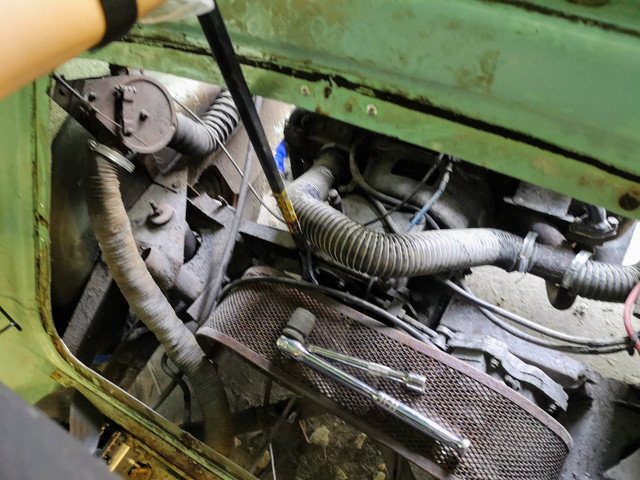

Actually getting the airbox out of the van was a little more involved than I expected as Mercedes seemed to think? that bolting it to the bulkhead by no less than four M6 bolts was necessary. Three of these are accessible once the fuse box is removed (four screws), the final one however is low enough down that you also need to remove the kick plate in the passenger footwell, which means another two nuts b?eing removed, peeling the carpet back and disconnecting the electronic box which lives under t?here which is something to do with the brake lights.
Then I just had to disconnect t?he air intake hose (which came off at the engine end first...apparently whoever had that off last didn't tighten up the hose clip) and wrestle the thing out of the engine bay, which was actually harder than expected as it's a far bigger assembly than it looks when in place. It just fits into the? gap between the slam panel and bulkhead when rotated in exactly the right way??.?
The big difference??? between me now and when I originally bodged this up is that I've got more materials to hand now. My intention this time was to go with the fibreglass loaded resin I've been using to do a lot of ?the repairs to the Invacar bodywork. If that doesn't work I'll just have to take the whole thing apart and either bolt a panel onto it or mess around plastic welding a patch over the hole.

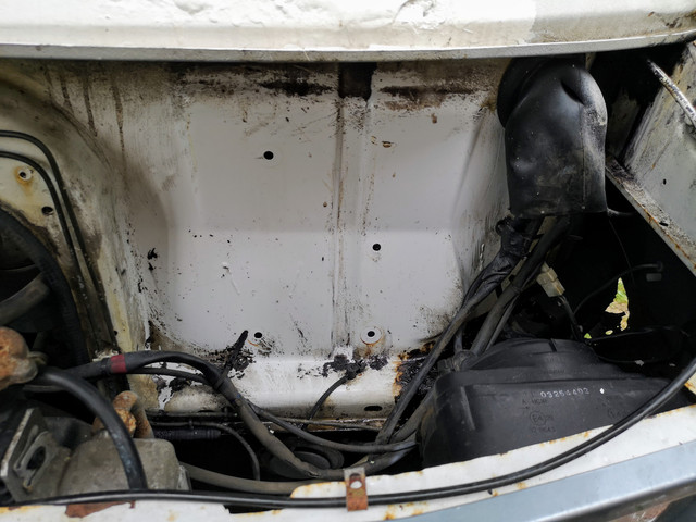

Step one (fine, step two...One was to remove all the foil and clean the area in question up) was to apply a small duct tape patch. This isn't actually go?ing to play any part in the final repair, it's just to stop the resin fro?m falling straight through the hole I'm trying to cove?r??.
I then roughened the area around??? it up with the wire wheel to give me the best chance of getting the repair to stick - though I'd done a test before with this and the resi?n seemed to adhere to the surface just fine.
Then slathered the area with a liberal helping of res?in.
While this was setting I took the opportunity to give the area behind the air cleaner a clean and to thoroughly blast the areas it's normally in the way of with rustproofing????? wax. Also tidied up the wiring a bit as whoever did the repairs to the cab floor in that corner obviously never put anything back in? the clips so the wiring was all flapping around everywhere?.???
The photo?? there is obviously the "before" image for the work mentioned above.
Once the resin had set I gave it a very ?quick and dirty blast of matt black paint just so it doesn't stick out so obviously - if it proves durable I'll sand it back smoother at a l?a?ter date. Not going to worry about that just now though???.
It's really interesting???? to see how much effort they went to to optimise gas flow here. Looking into the inlet manifold you can clearly see how things taper as you pass the branch for each cylinder, meaning that while the volume of air being carried drops by 25% for each cylinder they've clearly tried to ensure that the velocity remains constant.
Given I wasn't 100% sure of whether??????? the intake pipe had actually been properly attached I was glad to see ?this wasn't full of dust and gunk like the rest of the engine bay.
Then was just a relatively simple matter of putting everything back together again.
Definitely want to???? think about using some modern sound proofing under the carpets here. The stuff attached to the kick plate under the carpets here must weigh the best part of 5kg - it honestly feels like the plate is made of cast iron it's that heavy. Pretty sure there are alternatives available now which will do as good (or better) a job for a ?fraction of the weight. There's also absolutely zip by way of soundproofing on the actual bulkhead itself. ?

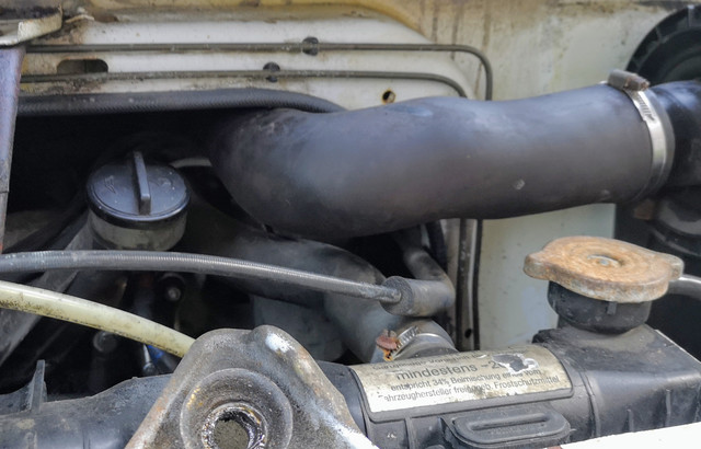

Airbox back in place a?nd reconnecte??d????????.
I came to the conclusion???? that the hose between the airbox and the intake manifold had been fitted backwards before. The logic behind this was that it was always pressed up against the top radiator hose. I didn't like this as I've had issues with hoses failing due to rubbing against stuff in the engine bay before. Rotating it 180 degrees left a ?good inch or so clearance under it. Much better.
You can see the witness mark on????? the radiator hose where it's been rubbing for goodness only knows how many years.
Finally, air cleaner reattached as well and we can ca?ll it a d?ay??.?
A quick test run revealed that this has????? indeed got rid of the horrible boominess. Hard to tell if there's any improvement in power delivery, though I wouldn't really expect it to be that obvious given the power to weight ratio deli?vered here at the best of times. It can't hurt though!
Yes I did of course snap a quick idle video for those of you who like a bit of old school diesel clatter. Even if I did get momentarily distracted by discovering where one of the worst buzzes in the van at idle was coming from - the awning. I'll ?need to get another couple of straps to secure it when not in use.
YouTube Video Link
The camera seems to pick up a??? lot more belt noise from the f?ront of the engine noise than the?re really is in person. First time I think I've managed to actually get the camera's mic to pick up the nice deep burble at idle from the exhaust. You'll probably need either headphones or decent speakers to really hear that though.
Just have to wait and see if the repair to the airbox holds or if I'm going to need to get more inventive. There's no risk of anything getting sucked into the engine if it fails by th?e way, the hole is on the atomospheric side of the air filter. Prior experience has shown that it's more likely to blow it off too rather than actually suck it into the engine anyway. If this were dow?nstream of the filter I'd have been being a LOT more careful?.

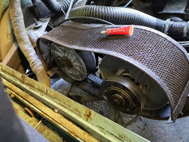

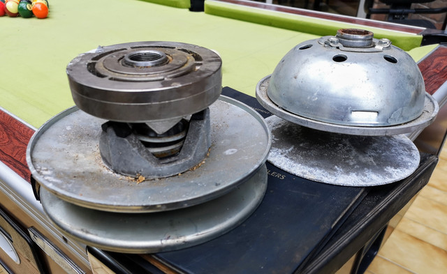

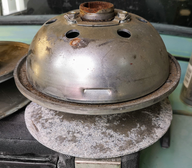

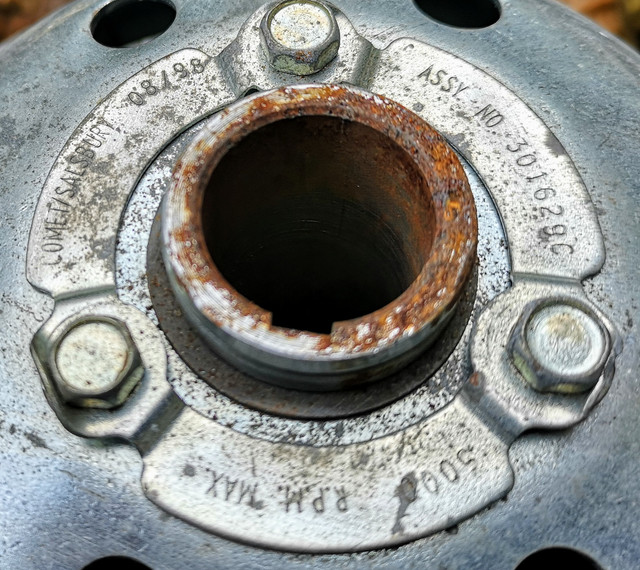

In addition to helping a friend collect their car, today I finally was able to get hold of something I've been after for the Invacar for a while to deal with the unhappiness of the transmission at speed.

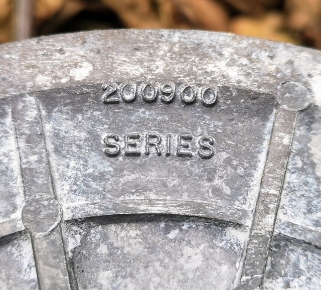

That's a pair of new old stock CVT pulleys. The primary one is cast aluminium and the little bit of oxide will clean off that no bother. The secondary one is just pressed steel though, and that's the one which is badly pitted on mine due to rust. That's effectively acting as a transmission brake over 40mph and is making the thing vibrate badly and unsurprisingly is chewing the belt up.
Also pictured there is a FULL workshop repair & service manual there waiting to be digitised and a proper part catalogue.
Current fleet:
Zelandeth
Posts: 5292
x 1592
Pretty? quiet day today, which was a nice change as the last couple of weeks have been almost non stop. ?
Despite having a day off I tend to feel that it's necessary to achieve something in a day, even if it's something small. Having a new set of Invacar pulleys sitting in front of me it was obvious what this afternoon was going to involve. ?

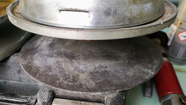

While the secondary pulley was ready "out of the box" so to speak, the primary one ?n?eeded a quick clean up first to deal with some aluminium oxide on the running surfa?ce?.
Five minutes with????? the wire br?ush later it was much? be?tte?r?.
For those playing along at home, here's a clear photo of the markings on the new primary????? pull?ey?.??
Getting the primary pulley off was precisely as much of a pain as I'd expected it to be. Simple reason: there is no easy way to lock the thing in place while you try to crack???? the retaining nut off. After snapping one large screwdriver and bending another, I finally managed to get it to coopera?te.
Yes, that is a crowbar wedging the pulley in place. ?????It later came into its own again while I battered it with a hammer to get the pulley off the shaft. The secondary one slid off pretty easily once unbolted, the primary was really quite a snug fit.

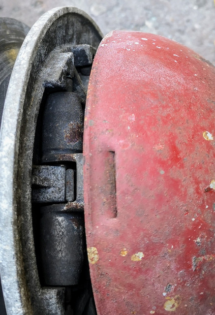

With it off it immediately became apparent that something wasn't right. The reason it rattled was ?because it appears to be completely devoid of any springs?.
It never ceases to amaze me how knackered???? this sort of setup can be while still working to at least some degree...this felt absolutely fine anywhere below about 40mph!
The new secondary pulley looks to be a different type...but given the source I'm going to give it a shot.
Belt tension was checked after??? I'd rolled the car up and down the? driveway a couple of times (yay...it no longer goes *click-squeak...click-squeak...click-squeak...* whil?e moving at low speed. Seems reasonable.
Was only able to get out for a ten minute test drive this evening before dinner, but immediate impressions:
[] At low speeds the noise levels are hugely reduced. The actual noise you can mostly hear now is nice subdued tuneful transmission whine rather than howling belt.
[] Low speed responsiveness is slightly better. Though I think the tension is a little loose as it's a bit snatchy moving off.
[] Only did one higher speed run, but at 40mph plus thi?ngs seem massively improved. I'm used to being able to just abo?ut hit 40mph between the one roundabout and our turnoff. Today an indicated 62mph (which I imagine is somewhat optimistic) w?as achieved with less than full throttle and leaving me plenty of time to brake.
Hopefully I'll have the chance to do a better test tomorrow. Initial impressions though are that it's improved things.
Oh, and while halfway round a roundabout the brake fluid ?warning light which I'd lost was spotted skittering across the floor. It has now been safely stuck in the box of random? Invacar bits??.?
Reassembly was relatively painless, only slightly awkwar?d discovery was that the keyway cutout in the new primary was shallower than on the old one, requiring a rectangular rather than square key. Luckily I've quite a few random shaft keys in the "drawer of random fasteners and similar stuff" and was a?ble to find one that was a perfect fit in a couple of minut?e?s.?
Looking forward to a proper test drive tomorrow...after I've cleaned the windows! I did wipe them?????? down briefly...but obviously not very well, and I totally forgot about the wing mirror.
Will 70mph be doable? Let's find out. Not worrying too much about breaking the belt in. Just isn't practical to drive gently for more than a couple of miles here...it's 20-30mph in housing estates or busy distributor roads where you need really to be able to get up to 50mph or so pretty rapidly if you ?don't want to be flattened.
Do have to wonder what anyone who saw me on the t??e?st run thought given the current cosmetic state of th?e c??ar??!?

I'm with Option 1 for the Demister Switch too, albeit probably a bit late now. And another 'Cute' for the Dog too !
