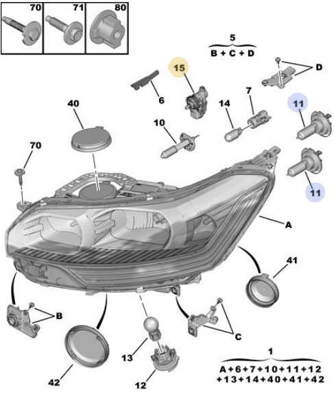

There is a levelling system for the Halogen headlamps to avoid dazzling oncoming traffic, as the suspension system is not fast enough to correct the pitch.
Each lamp has a corrector on this type of headlamp, item 15:
However, the bulbs if not fitted correctly can obviously result in an incorrect beam pattern. The bulbs should sit flush when fitted. If they have been forced in on replacement then that may account for the angle, but the bulbs themselves should be flushly fitted.

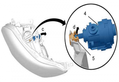

Here is a better close up of the corrector unit and as you can see it only attaches to the back of the fitting - not the bulb directly, so I suspect the bulbs may not have been fitted properly when replaced.

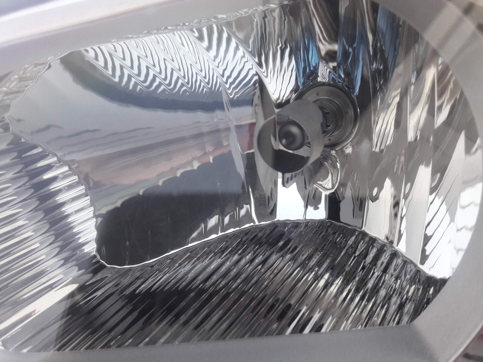

This is what they should look like....
However, the one on the driver's side of my car is a bit off centre.... which is odd as I'd previously centred it. I wonder if they bend with the heat given off by the lamp ?
