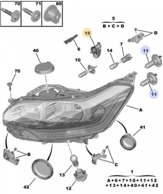

There is a levelling system for the Halogen headlamps to avoid dazzling oncoming traffic, as the suspension system is not fast enough to correct the pitch.
Each lamp has a corrector on this type of headlamp, item 15:
However, the bulbs if not fitted correctly can obviously result in an incorrect beam pattern. The bulbs should sit flush when fitted. If they have been forced in on replacement then that may account for the angle, but the bulbs themselves should be flushly fitted.
