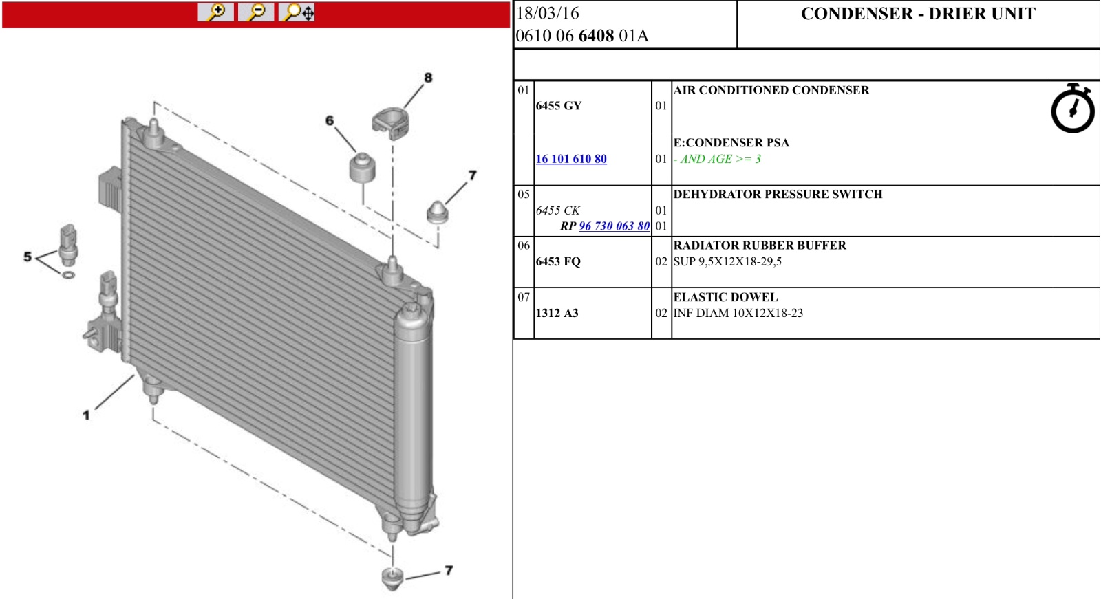

I’ve just noticed that none of these seem to come with the sensor fitted. Does anybody know what this sensor is and what the part number may be (Marc)?

The pressure switch is item 5
Click diagram to zoom. Part number: 9673006380

Methinks this C5 might already be on its second condenser. The one that’s just come out looks more like the cheapie EIS condenser than it does your illustration. The one in the illustration looks more like the dearer Hella unit.
Hmmmm!
Hmmmm!
