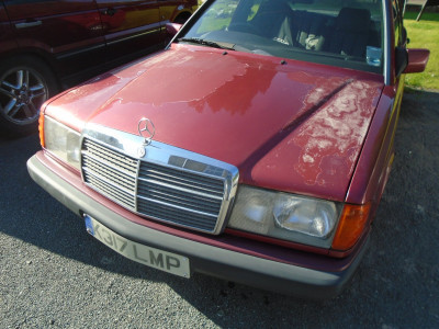

So whats lying around the house already-one of those triangular shaped things, which you can get triangular shaped abrasive "papers" from Aldi/Lidl for next to nowt which attach in a velcro like manner to the sole of the sander. Has a bit of oscillation about it I think. Yes thats the tool I was thinking of to attack the micra with should I feel the need.
I presume the 3m Trizact Pads would make short work of the rough clearcoat. Nothing is currently peeling all the paint/clearcoat defects are solidly attached to the metalwork underneath. Not sure if it was a factory paint defect for that particular car, or some other cause, but it isnt like that mercedes bonnet at all. I guess when I get out with my little lidl sander I may find it well and truly isnt up to the job
