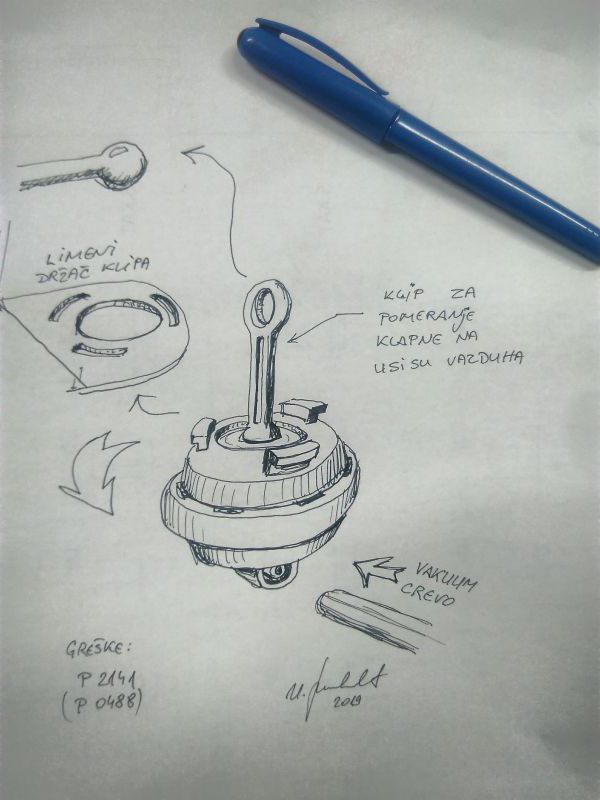

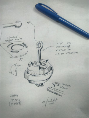

This part (vacuum solenoid) from Throttle control manifold

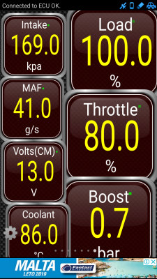

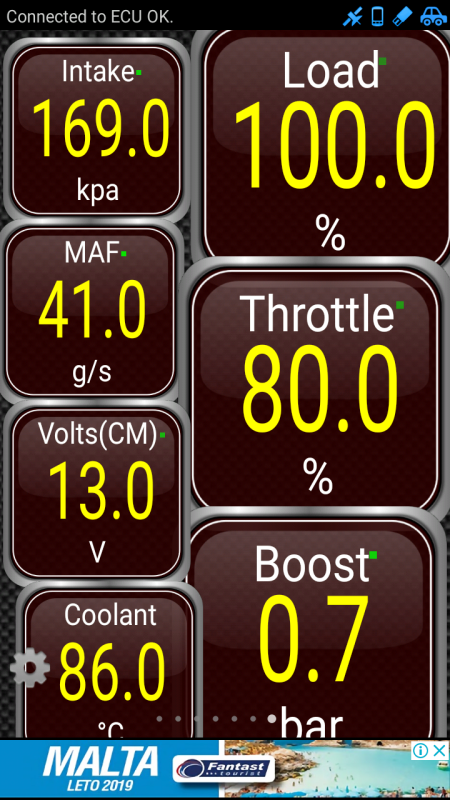

was unattached (because it easily can come off), for some time, so my throttle flap did not move correctly... During that time I had an error P2141 (Exhaust system faulty), but nothing more, and no problems during driving...
When I discovered, and reattached it, some problems started... During longer trips, 200km or more, when become hot... vacuum started to close throttle (readings on Torque app via bluetooth) were 11,5% Throttle, and vacuum - 8 bar or more...and engine start to suffocate, and can not go over 80-85 km/h, but very slowly accelerating...

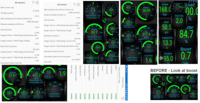

I will attach some printscreen photos from that period, and finaly, I disconected vacuum tube from Throttle, and closed the tube. Left Solenoid to hold threottle flap in possition, and it stays arround 83%...during faster rides it goes even over 86,5%, but dont go under 83%. Car now go nice, and no MIL light (before that I also had P0488 and P0487 error - Throttle manifold intake problems).
Can someone explain what is going on here...?

Before, normal readings:Before, vacuum closing throttle (choking):
Mix...one from before, and rest from now:
Also, before, in period when I returned solenoid, it started occasionally to give "Danger of DPF clogging", more and more frequently ... but I put some DPF cleaner from Wurth, and after 200km stronger ride it disappeared, and never came back... after that last ride, I closed throttle vacuum, and now its like that... Car is going normaly, no faults, but I am wondering what can go wrong if I leave it like that... and what is going on? (P.S. - My model have single air throttle intake flap)
Thanks in advance

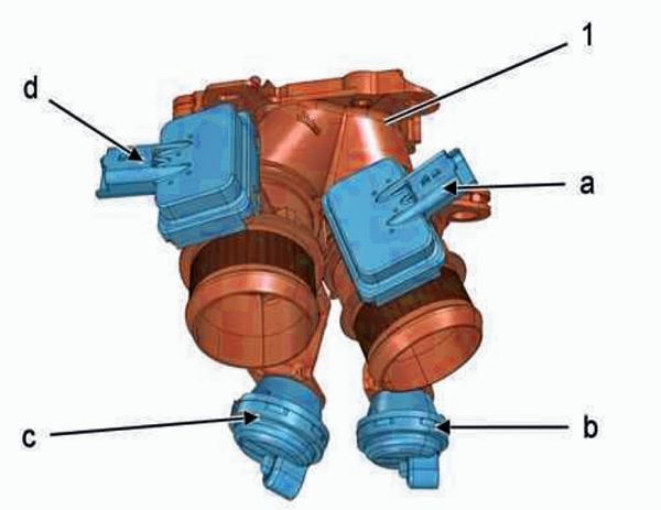

Are you talking about the Double Air Doser Capsules - 'C' & 'B'?

No, as I said, on my 2010 model, I have one single air intake... and yes, it is that capsule... my VIN No is: VF7**************[VIN obfuscated, can be read by forum staff]
maybe, You can also tell me some more about my car...or were to find it...

Not on this engine :) You have a Double Air Doser - standard on DW10CTED4 163 engines, which is why I put the diagram up. Now also confirmed with your VIN.

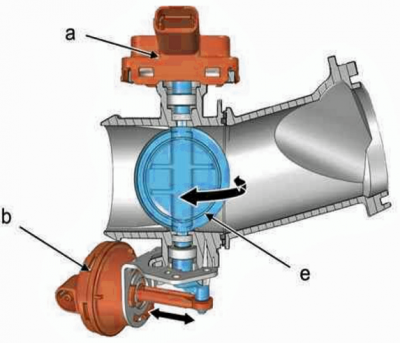

Some info in the Doser:
(1) Double mixer.
"a" Cold air position repeat sensor.
"b" Capsule controlling the flap for excluding cold air.
"c" Capsule controlling the flap for excluding hot air.
"d" Hot air position repeat sensor.
make: VALEO.
Hall effect sensor.
Role of the double mixer with position repeat sensors:
  • To monitor the inlet pressure so as to optimise the exhaust gas recycling (EGR) rate
  • To prevent air from passing into the inlet circuit when the engine is switched off (cut-off function)
  • To regulate the temperature when the particle filter (FAP) is being regenerated
"e" Exclusion flap.
The double mixer consists of 2 pneumatic capsules and 2 position repeat sensors (Cold air circuit and hot air circuit).
The rest position of the exclusion flap "e" for the cold air circuit mixer is open.
The rest position of the exclusion flap "e" for the hot air circuit mixer is closed.
The pneumatic capsules are supplied by the vacuum pump via the proportional electrovalve.
The pneumatic capsules control the opening-closing positions of the mixer exclusion flaps.
The position repeat sensors transmit the positions of the mixer exclusion flaps to the engine ECU.

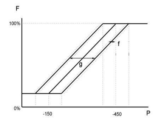

DesignationMinimum toleranceNominal valueMaximum toleranceUnit
Pressure: Start of closing-175-150-125Mbar
Pressure: End of closing-475-450-425Mbar
Pressure: Starts to open at-245-220-195Mbar
Pressure: End of opening-545-520-495Mbar

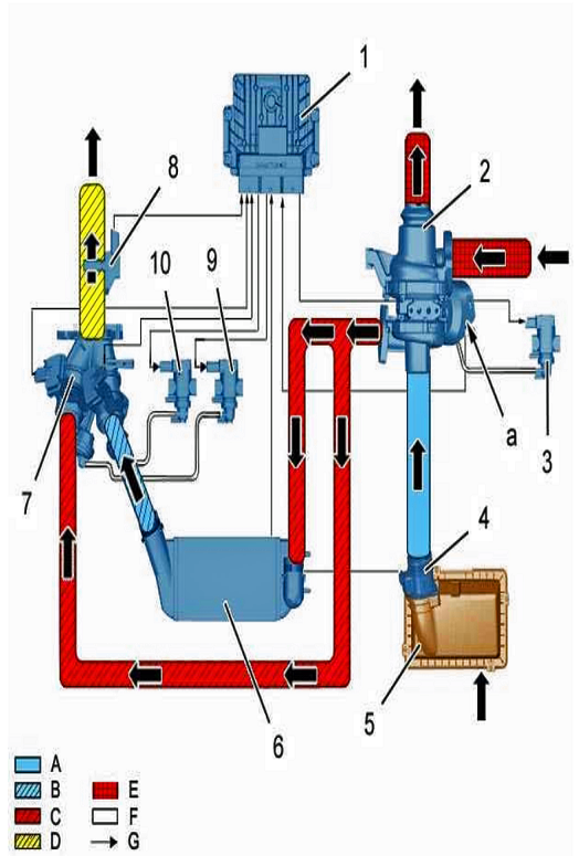

Key
"A" Fresh air
"B" Cooled compressed air
"C" Hot compressed air
"D" Air inlet
"E" Exhaust gas
"F" Control vacuum
"G" Electrical links
ReferenceDesignation
"a"Turbocharger Blades Control Diaphragm (With Position Copy Sensor)
(1)Engine ECU
(2)Variable Geometry Turbocharger
(3)Proportional Electrovalve Controlling the Variable Resistance Turbocharger
(4)Air Flowmeter By Mass
(5)Air Filter Unit
(6)Turbocharger Air Cooler
(7)Double Air Mixer With Position Repeat Sensors
(8)Inlet Air Pressure and Temperature Sensor
(9)Turbo Air Cooler By-Pass Control Electrovalve
(10)Air Metering Unit Control Electrovalve
Management of Air Blower Supply
The engine ECU adapts the mass of air entering the engine to the needs relating to the different life phases.
In order to adapt the mass of air entering the engine, the engine ECU acts on the following components:
  • The pneumatic control of the variable geometry of the turbocharger, to vary the turbo air pressure (via an electrovalve)
  • The EGR electrovalve, to vary the flow of air in certain phases of operation
The flowmeter for the air mass measures the flow and the temperature of the air entering the turbocharger and transmits the information to the engine ECU.
The temperature and the pressure of the air entering the air mixer are measured and transmitted to the engine ECU by the inlet air temperature and pressure sensor.
Turbo Air Pressure
General
  • At an equal temperature, the mass of air entering the cylinder increases with the turbo air pressure.
  • The turbo air pressure delivered by the turbocharger increases with the engine speed.
  • The engine ECU has to adapt the quantity of air entering the cylinders to the requirements of the user.
Specificities
The engine ECU is able to manage the variable geometry according to 2 modes of operation:
  • Piloted mode
  • Regulated mode
Piloted mode: The engine ECU commands the variable geometry electrovalve so that it regulates the turbo pressure as a function of a reference position for the variable geometry.
Regulated mode: The engine ECU commands the variable geometry electrovalve so that it regulates the turbo pressure as a function of an absolute reference for air pressure.
N.B. : The change from regulated mode to piloted mode occurs as a function of engine speed and engine load.
The turbo air pressure reference is calculated from the following parameters:
  • Engine speed
  • Engine load
  • Engine coolant temperature
  • Inlet air temperature
Inlet Air Temperature (Turbo air cooler by-pass)
General
At an equal turbo air pressure, the mass of air entering the cylinders decreases when the temperature of the air coming from the turbocharger increases, and vice versa.
In certain operating phases, the engine ECU commands the air cooler by-pass to open, so that then the air entering is not cooled by the air cooler.
The increase in the temperature of the air coming from the turbocharger causes the mass of air entering to diminish, so that the combustion emits less nitrous oxide (NOx).
Specificities
DW10C engine: The by-pass function is not active, the hot air (by-pass) flap is only activated in the event that the cold air (mixer) flap seizes.

So, in theorry, I can try using also electrovalve No 9, to control my single air inlet throttle body, because I think that is not problem in the throttle, but for some reason vacuum at certain moments try to close it completely... maybe problem with valve, or ecu, or some other problem that computer detects during ride... as I can see, position sensor info is correct, only for some reason car wants to close it. Hmmmm...
I will do some tests and public results...
But also, did anybody found something connected to the safety related with the flaps and "run away diesel engine" ?
