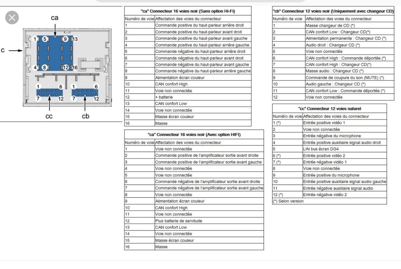

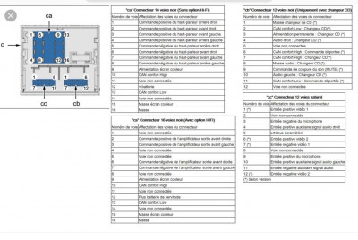

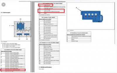

Re: Hands free kit for C5 X7
Post by BounceDK »
:rofl2:
I’m refering to the connection terminal at the back of the RT16.
See above. Right now I’m using the First metode.
Post by GiveMeABreak »
Ok, I'm with you now! The only issue I can see is that others here have not had much success in getting the pre-existing wiring from the flat cable factory fitted microphone to work. I think this is probably down to it being routed through an interconnected harness. Most here have actually bought a separate microphone cable and wired it in directly to the back of the head unit.

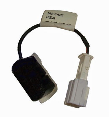

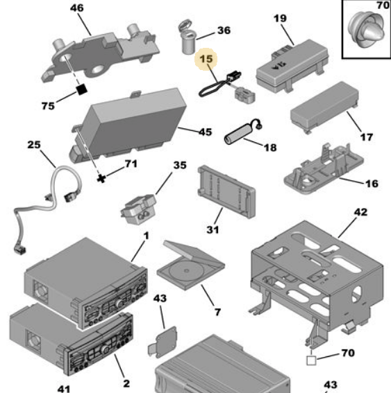

Item 5, Part 659365 priced at: £28.63 inc UK VAT - or the equivalent in Denmark. The pin outs are in the previous wiring diagram that I put up on the previous page:
viewtopic.php?f=52&t=61730&start=15#p610868
If you already have the microphone that is the same part as in the picture below, then no point ordering it. You'll just have to be a bit creative and wire it is directly.
Post by BounceDK »
Ok. I think I will make a new cable for the original mic in the roof lamp.
Can I use normal cable or do I have to make a balanced one. Do the mike use phantom power like the mike we use for rockbands audio... ?
I nearly give up, but I do not. I believe I will have succes that way.
Once more.
THANK YOU very much. Your help here is outstanding =D>
As much as I like a bit of :rock: I don't think they use Phantom power in these microphones because the power can damage ribbon connectors which are very sensitive. The microphone is connected to a ribbon cable, so I would just use normal wire to connect the mic to the head unit. :-D
