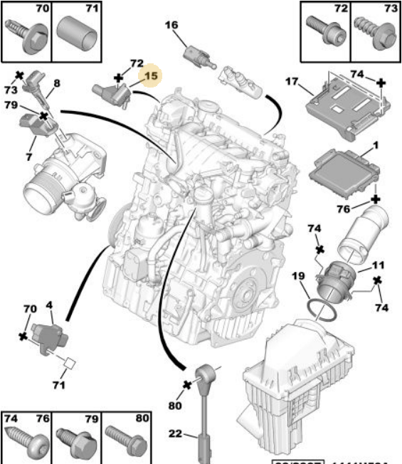

Which exact sensors did you replace as there are 2 sensors that can cause the starting issue:
The engine speed sensor and the Camshaft Position Sensor:
Item 15 is the Camshaft Position Sensor
Item 4 is the Engine Speed Sensor
P0341 for the engine I mentioned relates to the problem with synchronisation of the camshaft. There is no synchronisation for 2 to 3 engine revolutions between the engine speed sensor and the camshaft sensor for making the 1st injection.
