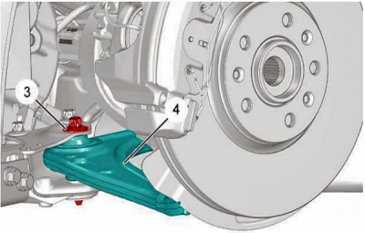

This is an extract, but no reference to suspension height as in height correction checking / adjustment which is what I understood you were referring to Kenny. Just that the suspension circuit is depressurised to allow you the movement to adjust the wishbone before tightening as indicated:
Position the suspension lower arm (4) on the front subframe.
Refit without tightening:
The (3) bolt
The (2) bolt
The (1) bolt
"X" = 58 ± 5 mm.
Position the front suspension lower arm to the dimension "X".
Tighten:
The (3) bolt
The (2) bolt
The (1) bolt
The (3) bolt
The (2) bolt
The (1) bolt
"X" = 58 ± 5 mm.
Tighten:
The (3) bolt
The (2) bolt
The (1) bolt
