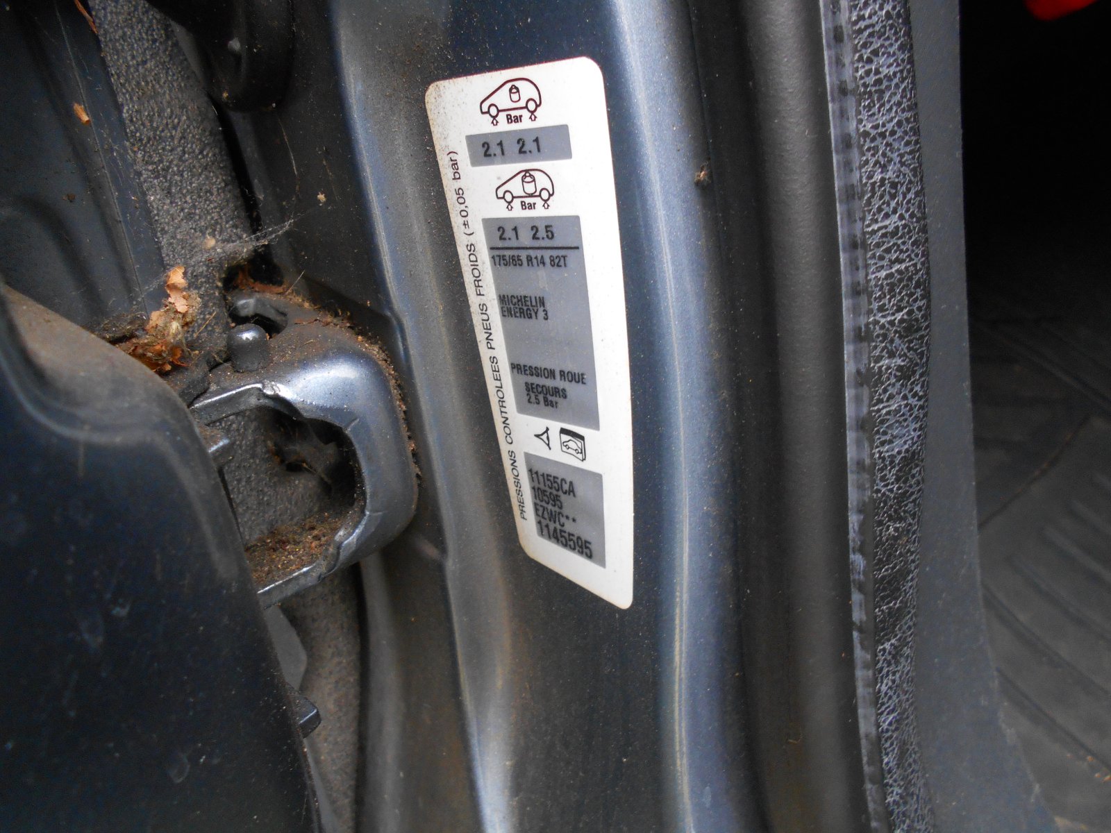

My daughters C3 has failed on emissions. And my lexia will not play!
The car is a 1.4i first registered 07/09/2007. The RPO I am using shows up as a build date of 11/11/2005??
The VIN is VF7**************[VIN obfuscated, can be read by forum staff]. Can the RPO be checked from the VIN?

Your RPO (build date) is 11155 which is 25th May 2007. You are looking at the wrong number on the tag.
Also, you have a C3 II, so make sure you select this 'C3 II' when you come to model selection and not the standard C3, nor the C3 (A51).

You are a absolute star sir!!

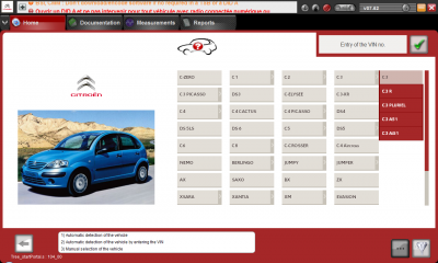

And the lexia still will not play.
Apart from reading the vin it doesn't seem to see anything else.
I see no reference to C3 II- my options are;
C3
C3 R
C3 PLURIEL
C3 PICASSO [A58]
C3 A51
C3 Ai51
C3 AIRCROSS [Ai58]
C3 PICASSO [Ai58]
A simple OBD reader gets to the ecu ok. Any thoughts, please.

Ok, so try the C3 R - and are you using Diagbox with encaspulated Lexia or a stand alone version of Lexia?
The Confusion is because in the service documentation they refer to it as a C3 II and in Lexia C3 R.

All this is a bit deep for me!
I am using Diagbox, but in this session I am only getting Lexia and Scantool options
IIRC on other vehicles I get the Diagbox option, which I have found to be better to get round.
I'm going to try your suggestion of entering C3 R

Thanks for all that info. It's all starting to make sense.
Your suggestion of entering C3 R worked- it opened up 'New Look C3'
Global scan came up with a full up fault log! But so far I can see nothing that might compromise the emissions.
Their is a fault relating to the injectors, but as yet I have not been able to read it.
I have no doubt I will be looking for help as I pick my way through this lot!
