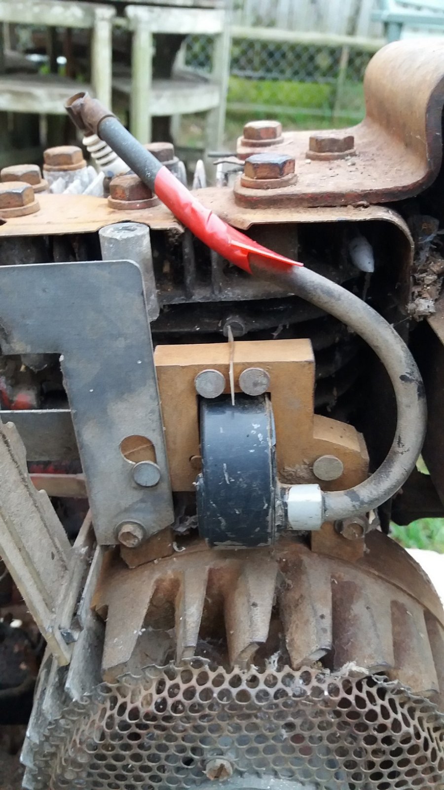

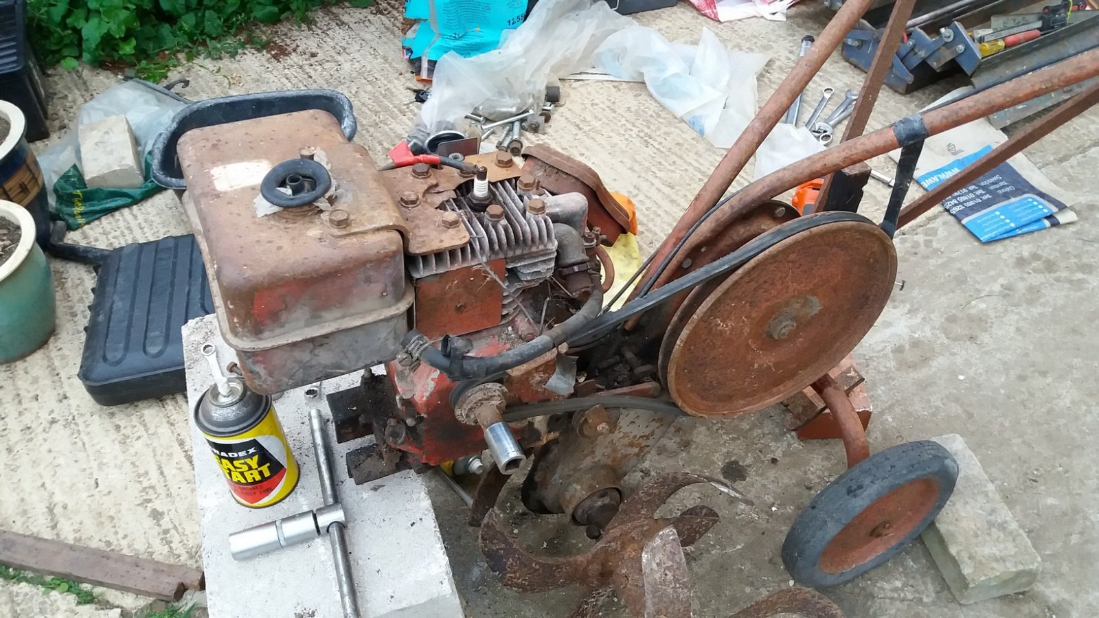

Can I replace just the HT Lead part of the Ignition Armature on my "Briggs & Stratton 4 Stroke Gasoline Engine"
fitted to my "Wolseley Merry Tiller", gu-estimate 1950's vintage?
...or how on earth do I go about replacing the entire part? Is there a relevant measurement? The machine certainly isn't going to feature in many parts catalogues!
The machine was running when last put away. I gave it a dose of oil via the Spark Plug hole prior to turning it over and Compression appears good, but the Spark is much more 'Miss' than 'Hit', occasionally excellent but mostly absent, including with a decent plug (not shown in pics) hence my suspicions falling on the HT. (I put the red Insulation tape on suspecting it was shorting out on the Cowling)
The machine is a £20 Gamble from Facebook, at less than half the cost of a day's Rotovator Hire, it'll be a very useful tool in my garden, which bears the scars of being severely unloved for a number of years prior to my moving in.... if it'll run.
First goal is to get a moment's running on Easy Start.

Answer to the question about the HT lead, no it doesn't unscrew from the coil. It's replace all or cut and repair using a threaded joiner. The coil will be be the same as on many lawnmowers. The only difference between the vertical and horizontal shaft engine is an oil thrower on the crank of yours. Check that the flywheel is positioned on the keyway correctly. If anyone has had it apart who doesn't know they think the key holds the flywheel in place, it doesn't, it locates it prior to tightening to a torque of FT. Without a flywheel holder you can undo and retighten using a lump hammer and a T bar (or rattle gun). You will probably need to make a puller. If it's not tightened fully the inertia shock of the first start brakes the 'soft' woodruff key and throws the timing out. There's loads of manuals and parts diagrams on line for Briggs on their official site. If it is the coil, any coil off a Briggs engine with the same diameter flywheel will work. I've even recut the laminates from a 5hp and fitted it to an 11hp and it works.
If you use the engine number on the Briggs site it will tell you what's fitted and build date.
As you can see this is a little hobby of mine, I have about 10 engines in various states, most given to me because they were dead (but they live). If you let me know the engine size or flywheel diameter I probably have a coil.
They rarely die, it's just a question of whether they're economically viable to repair. Which is why I keep all spares.

It's a Briggs - therefore there will be spares
Get the Model, Type, Code off of the engine, look it up on the Briggs website or Google for the parts list. Google the relevant coil p/n as it will have been superceded. Ebay usually comes up trumps for such parts. You set the correct air gap between the flywheel and coil by using a piece of thin card (fag packet, etc) between the coil and flywheel, then tighten down. Job's a good-un

Years ago, my brother borrowed a rotovator and then found that it had no spark, being a weekend we couldn't pick up a coil, so we wired a motorcycle coil and 12V motorcycle battery up the the points, got spark, then strapped the coil and battery to the machine and happily dug-over the garden.
I seem to recall that a well-worn Briggs engine could have excessive play in the main bearings, upsetting the timing of the points and causing a poor spark. Also the clearance between the flywheel and coil is fairly critical, being exactly a standard business card thickness

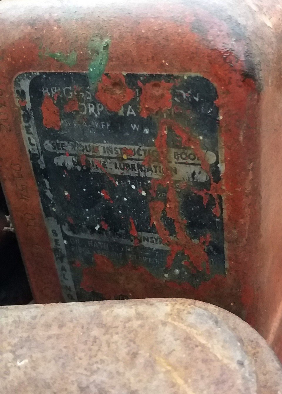

Pete: the Flywheel size is 143mm and the engine number, is it stamped onto the Block, coz its long gone from here This number is stamped and partly visible in the photo, but I'd guess it to be more likely a Chassis number: 80302 0154 01 6403303

Oh dear, Derr! Did I really just say that about a number that's stamped on the engine?! OopsPug_XUD_KeenAmateur wrote: 04 Jun 2019, 13:54 This number is stamped and partly visible in the photo, but I'd guess it to be more likely a Chassis number: 80302 0154 01 6403303

That number stamped on the cover - that's the Model / Type / Code ! You can decipher date of manufacture (of the engine) from that as well as getting the parts list. I haven't got my parts diagrams with me, but you're after a diagram for an 80302 engine. The Briggs website will tell you all

Here's the manual, it's a 3 hp, that's the only one I haven't got a coil for. Any 3 or 31/2 hp mower one will fit. The sparks are crap when the are OK. Chuck a teaspoon of petrol down the sparkplug hole and see if it tries?

Belts are surprisingly cheapPug_XUD_KeenAmateur wrote: 04 Jun 2019, 13:54
I could also use a Belt for it as the existing belt actually has a couple of Chunks missing, but I was hoping it'd do the few hours use I need it for without snapping....
https://www.bearingboys.co.uk/V-Belts--3290-c
You can also find what length your old one is by measuring the outside length and putting that into the calculator top left here (note, this is for 'A' section belts):
https://www.bearingboys.co.uk/A-Belts-13mm-x-8mm-1059-c
Don't use a standard belt length calculator (size of pulleys / distance between pulleys) to work out what belt you require as you need to fit one with a little slack so you can use that slack as clutch.
