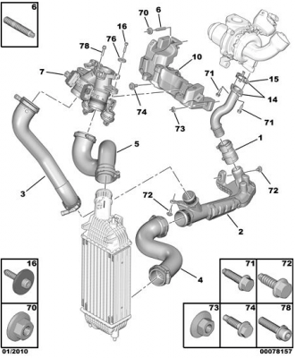

Now several things to point out - there are likely several issues going on. Dealing with the Air Doser codes first and the Turbo, you can see from these that there is a blockage or failure of the correct pressure / electrovalves to open - so that may indicate a common problem of either the electrovalve electrical harness or there is insufficient vacuum to operate the electrovalves that affect the turbo and the air doser.
Separate to this the P1445 fault code is telling us that basically the DPF is full and needs replacing (or cleaning out) as it can no longer regenerate.
Now as you can see from some of the consequences of the air faults to the electrovalves - specifically the Air Doser on fault P11AB, the downgrade mode will stop EGR function and also prohibit the combustion mode that encourages regeneration. So as it stands, the car will unlikely be able to regenerate whilst the faults are present.
It is therefore possible that as no regeneration has been able to take place, the filter is now blocking up - so it is extremely important to get to the bottom of the underlying fault, because if you just get the DPF cleaned, it will block again very quickly without having any regeneration occur - so I would hold off on the DPF clean until you decide on a course of action. But I strongly suggest you do not use the car if possible as this will only add to the existing DPF blockage that you have.

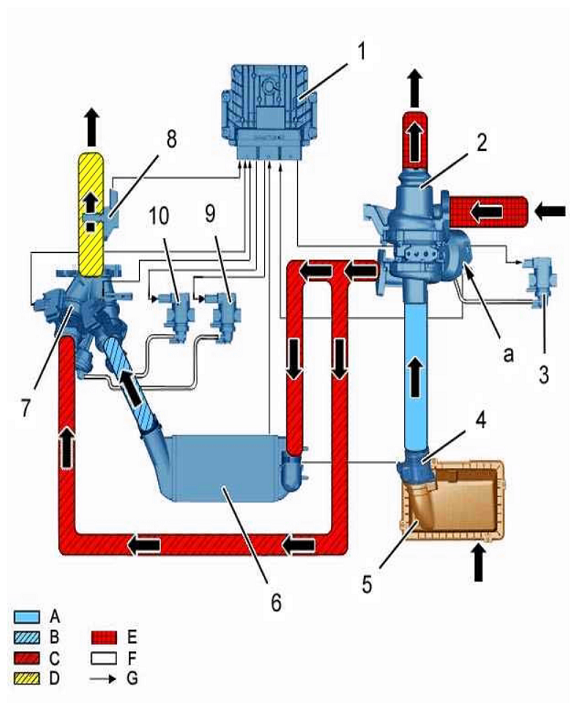

Here's a diagram of the Air Circuit on your engine:
(click to zoom the pictures) Key:
"A" Fresh air
"B" Cooled compressed air
"C" Hot compressed air
"D" Air inlet
"E" Exhaust gas
"F" Control vacuum
"G" Electrical links

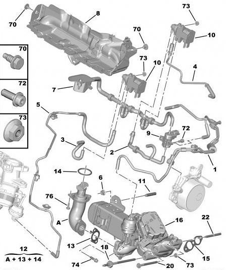

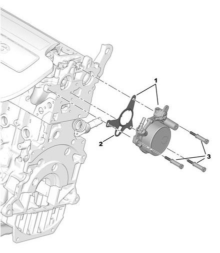

Below is the Vacuum Module:
And again showing the electrovalve pipe connections:
"A" Fresh air
"D" Air inlet
"E" Exhaust gas
"F" Control vacuum
| Reference | Designation |
| "a" | Turbocharger blades control diaphragm (With position copy sensor) |
| (1) | Engine ECU |
| (2) | Variable geometry turbocharger |
| (3) | Proportional electrovalve controlling the variable resistance turbocharger |
| (4) | Air flowmeter by mass |
| (5) | Air filter unit |
| (6) | Turbocharger air cooler |
| (7) | Double air mixer with position repeat sensors |
| (8) | Inlet air pressure and temperature sensor |
| (9) | Turbo air cooler by-pass control electrovalve |
| (10) | Air metering unit control electrovalve |
