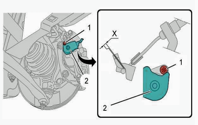

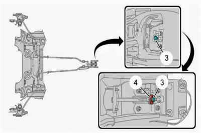

It won't be possible for us to diagnose the exact cause on a forum, as it could be one of the handbrake cables that need replacing (these are available individually). Or it could be the caliper - but if the cable isn't pulling the caliper that will be the problem.
The procedure for adjusting the handbrake is:
Preliminary Operation: Remove the central console.
Raise and support the vehicle on a 2 -post lift.
The handbrake cables are compressed as follows:
ESSENTIAL: In the event of non-conformity of these 2 checks, Repeat the adjusting procedure.
Return the vehicle to its wheels.
Refit the central console.
Part number 2 is the cable and the OEM part is: 4745R5 (£52.13 inc. VAT from Citroen) each.
or there is a cheaper one that Citroen do for older cars, part: E074064 (£19.40 inc, VAT from Citroen) each.
The cable guides are part number (5) and right and left specific. shout if you need the parts for those.
- Engine running
- Press the brake pedal 5 times to pressurise the braking system
- Apply and release the handbrake 5 times
Conditions of adjustment:
| ( 3) handbrake cable tension adjusting nut.
