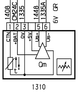

Ok, so this is the wiring diagram for your Diesel DW10TD Injection System.
Item 1261 on the lower right is the TPS. There are 4 wires:
1393: inlet air pressure signal (Pink Wire)
1427: pre-catalyst upstream exhaust temperature sensor earth A (Beige Wire)
1391: MIL-REQUEST signal (Green Wire)
1392: EOBD warning info (Green / Yellow Wire)
All the above go directly to the Injection ECU via the 10 PR Harness
As for the MAF, this is item 1310 on the diagram (bottom middle).
1408: / volts turbocharging solenoid valve / supply (Beige Wire)
CM24C: Battery + to Engine Fuse Box (Green Wire)
1335: Intake air electric motor command (-) (Green / Yellow Wire)
1448: compressor 2 air temperature signal (Pink Wire)
1335A: Intake air electric motor command (-) (Yellow / Green Wire)

Hey, thanks a lot! I think that is the first post on internet with detailed info for this loom...
Now we have to ask ourselves, will cutting and rerouting MAFes wires 1335 and 1335A to earth mess something up? Or should i search for MAFs ground point MC11 somewhere in the engine to check if it is poorly crimped
