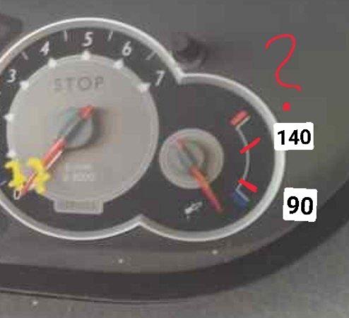

do you (or anyone else?) by any chance happen to have any info on this for a mk1 c5? Citroen in their infinite wisdom decided to use unmarked gauges for voltage, coolant and oil temperature which is not very useful and my cars last owner got rid of the manual book for some reason...
I could assume that the scale is the same as on a 407 which has marked gauges but I noticed that the 407 coolant gauge shows 90c in the middle while mine is actually around 78c in the middle so that makes me doubt the oil gauge. I know there aren't any mk1/facelift manuals online (only the x7) so I guess if you don't have access to any either my last hope to figure out the scale would be to drag out the lexia laptop and check the actual oil temperature on that (as the phone based bluetooth obd2 scanner won't report oil temp).

Yeah, maybe I should have written my question in another way. What I meant was that the middle of the coolant gauge on the 407 is 90c while on my c5 the middle of the gauge is 78c so the scale is clearly different. That makes me think if the oil temp gauge also has a different scale and so the position of the c5 gauge can't be compared to the 407 gauge (which has the temperature written on it instead of being blank) in order to estimate the oil temperature on the c5.

no issues suspected, just curious. However I think you may have mistaken my question for another, as I wanted to know about the temperature not pressure and if there was any scale like the one you posted for the x7 in the second post but instead for my mk1
As you probably know the mk1 has an oil TEMPERATURE gauge but it does not have any actual writing on it like the picture of a 407, just blue and red on bottom and top of the gauge limits which is why I was asking about it.
EDIT: added picture to show better what I actually mean

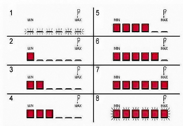

| 7 | From 82% to 100% |
| 8(flashing) | Higher than 100 % |
In the event of receiving an invalid value, the 6 lower segments of the display and the "min" pictogramme flash, the "max" pictogramme remains unlit.

Ok, thank you for checking anyway. I think I will just take the lexia laptop with me once I go on a longer trip and check the actual temperature compared to the gauge position.
